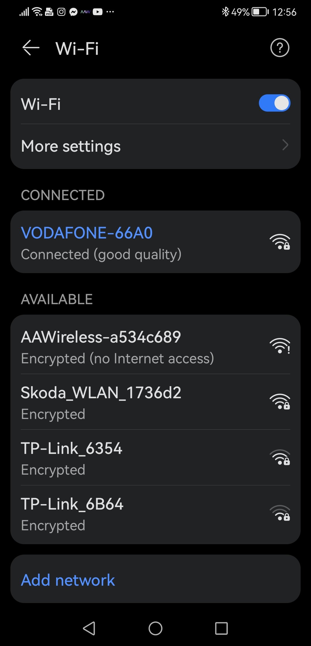

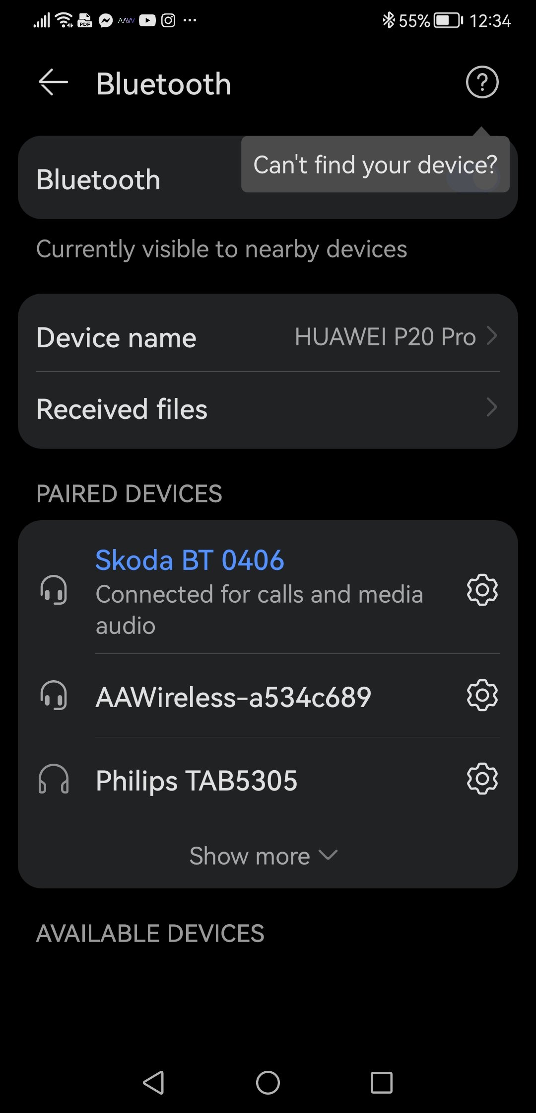

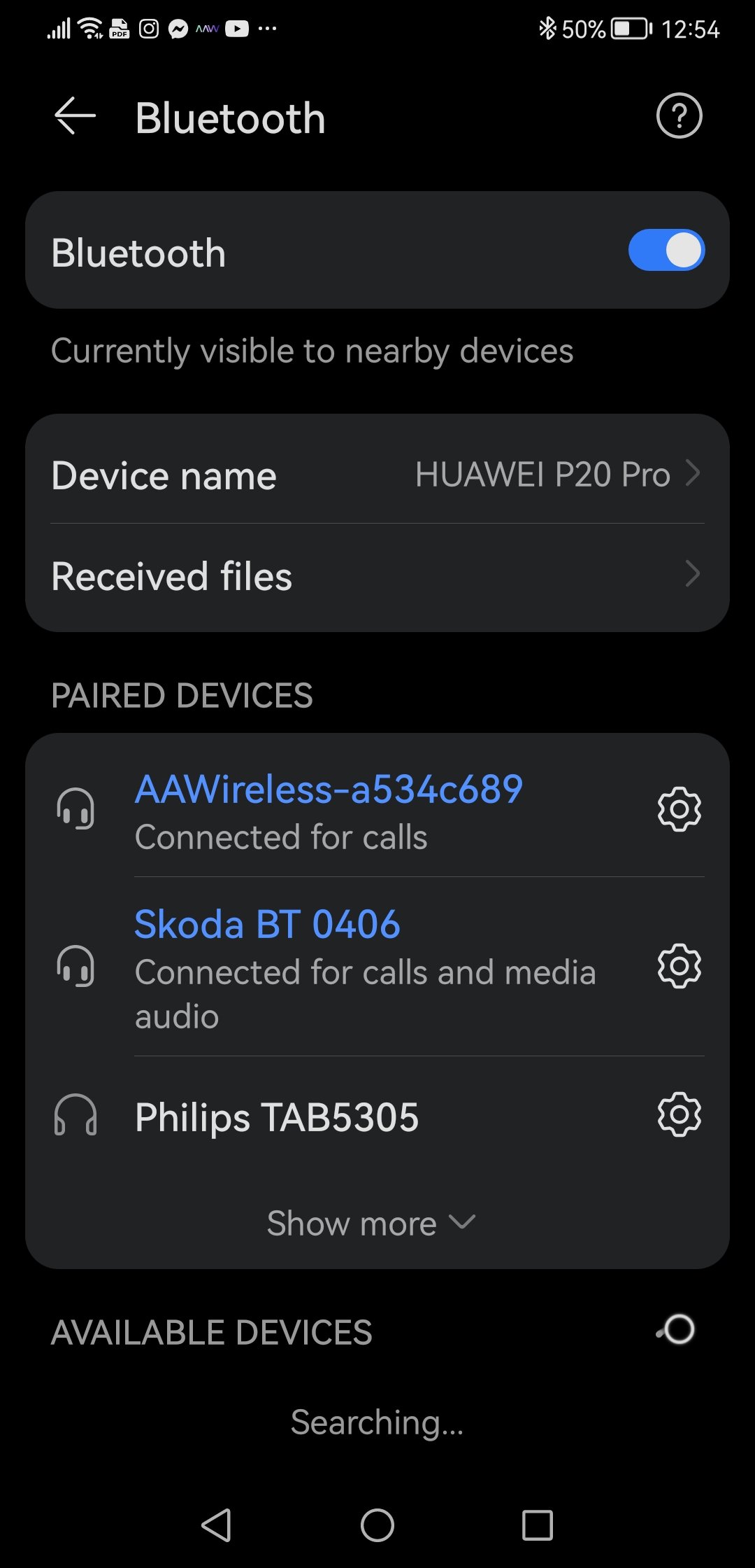

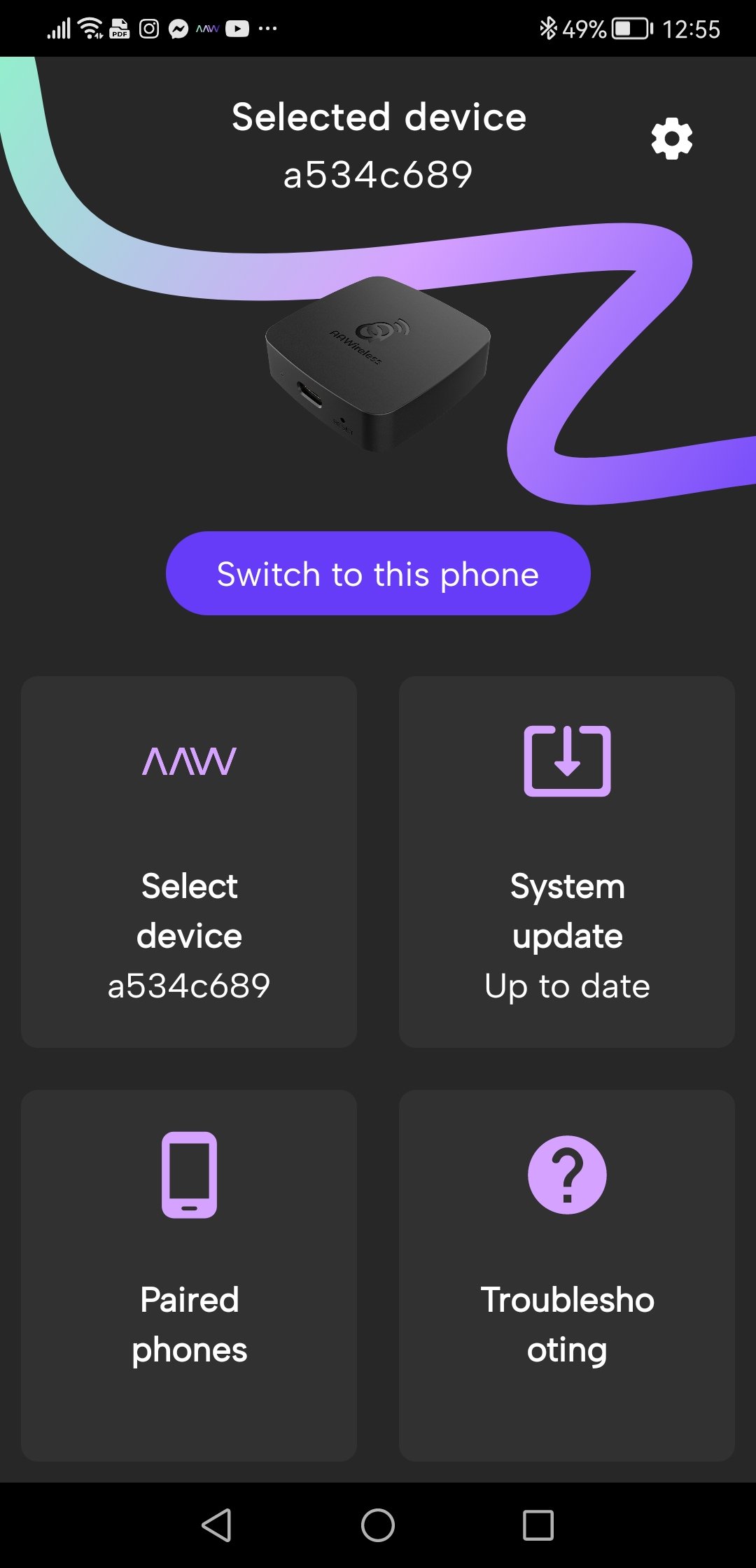

I got the device this morning.
Got the App, and it's updated to newest version.
The phone and Bluetooth are all connected, but it's still not starting the Android Auto without the lead.
I'll attach some screen shots, maybe you can help me with what's not going right.?
Many thanks.

However, your phone only connects to one wifi network at a time. Your home network may be stopping your phone connecting to the AA Wireless network.

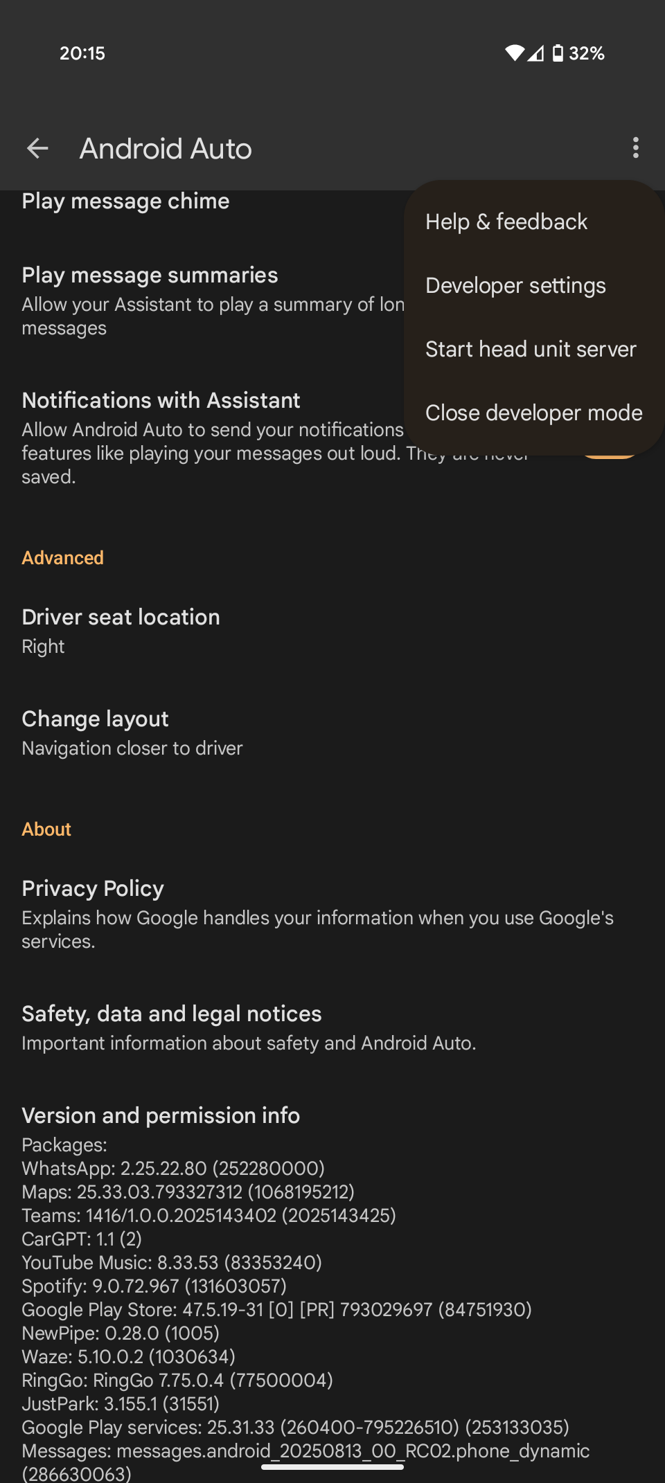

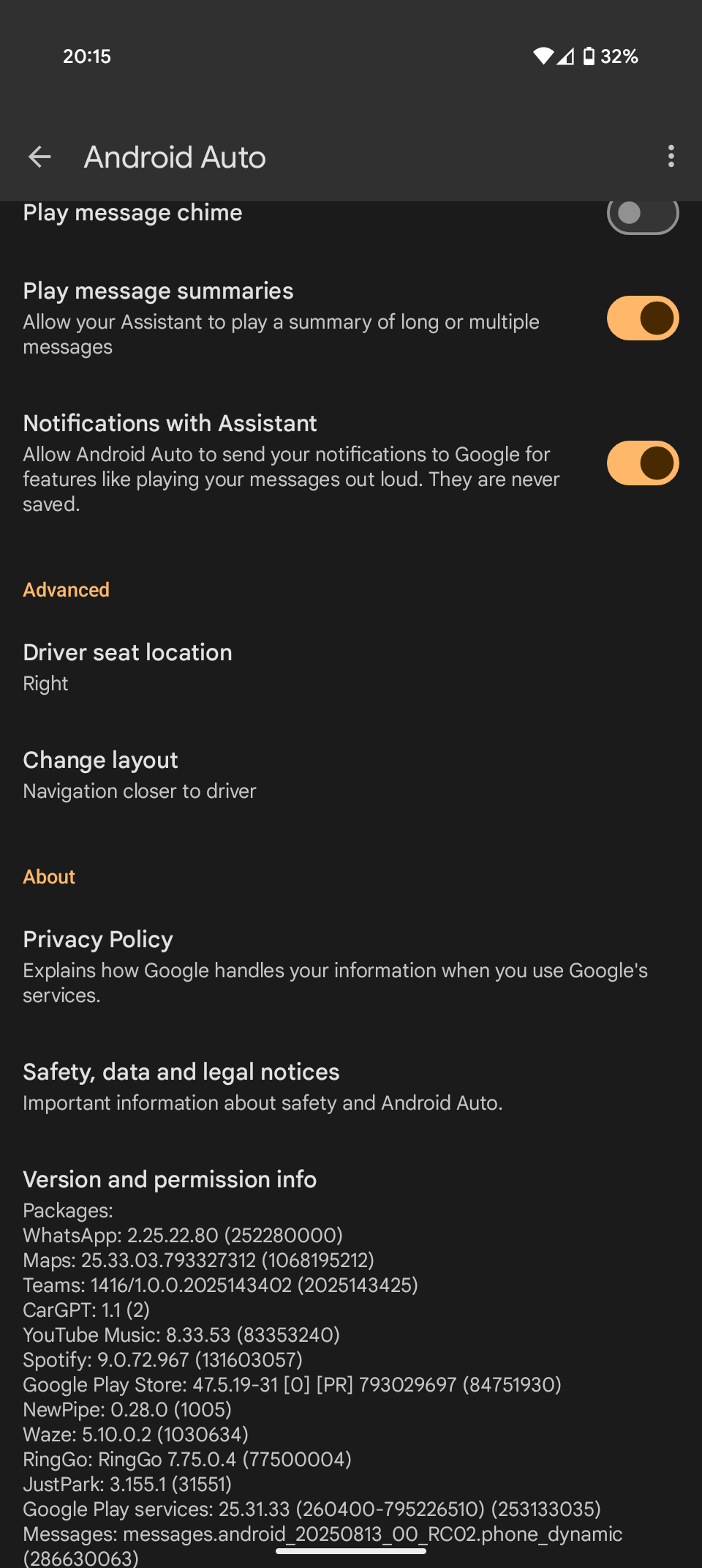

I use AAwireless with my JVC headunit, there's another thing you can check.
In your phone settings, search for Android Auto, you'll get a menu with a few options to tweak and a 'version' option right at the bottom. Tap 'version' repeatedly and you'll eventually get a notification that you've unlocked developer options.
Tap the three dots to the top right to get a menu popup where you can access developer optionsScreenshot_20250826-201554.png
Finally, at the top of developer options is a tick box to enable wireless connectivity
Yes as @hill79 Said, you have tu activate wireless AA on your phone

you have to be unconnected of any wifi network during process.
i went to parking of another house to set it up, because i didnt want to turn off home router.
you need to be only on mobile data 4G or 5G to connect AA to wifi.

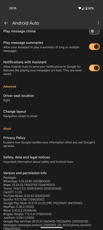

I just got into that Android Auto setting on my phone..
Pressed the three dots, but there are only options for Help and Feedback and Send Feedback.
No Developer Settings or Close Developer Mode options as yours had. So frustrating..
first you have tap several times (i think 7 times ) on the bottom where is section "version and permission info"
than developer option will be available.
it is common gesture for enter additional options everywhere on android phone.
Hi, just tried that.. On my phone, Version, that is all it says, and it is on the bottom left of the screen page, I have tried tapping it, nothing happens. Screenshot below
here

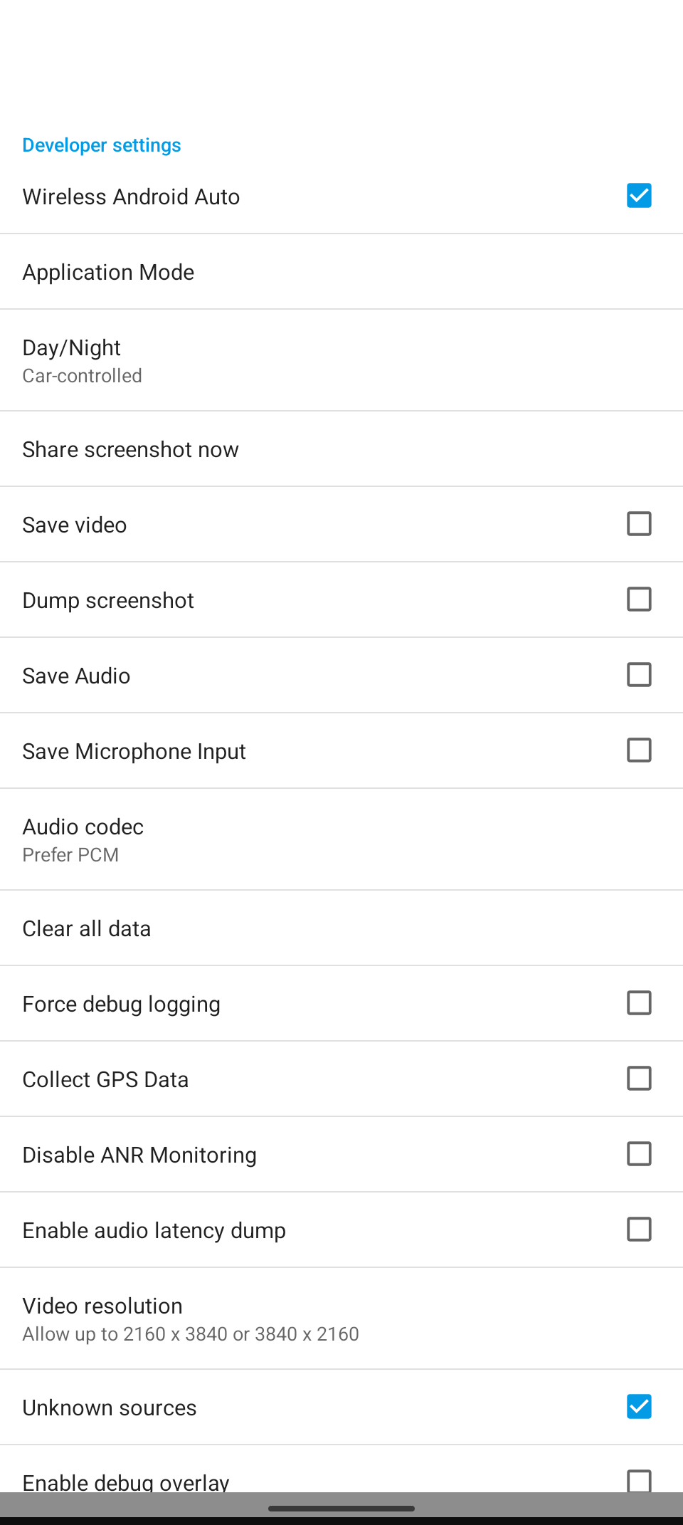

Just an update to you all, after all your advice today, I have managed to access and check relevant boxes on the developer settings on my Huawei P20 Pro phone, the Android Auto App, and the AA Wireless App
I reset my phone to apply changes.
Tomorrow is a new day, so I will attempt another setup on my Octavia System... Fingers crossed it works... 🤞😊
