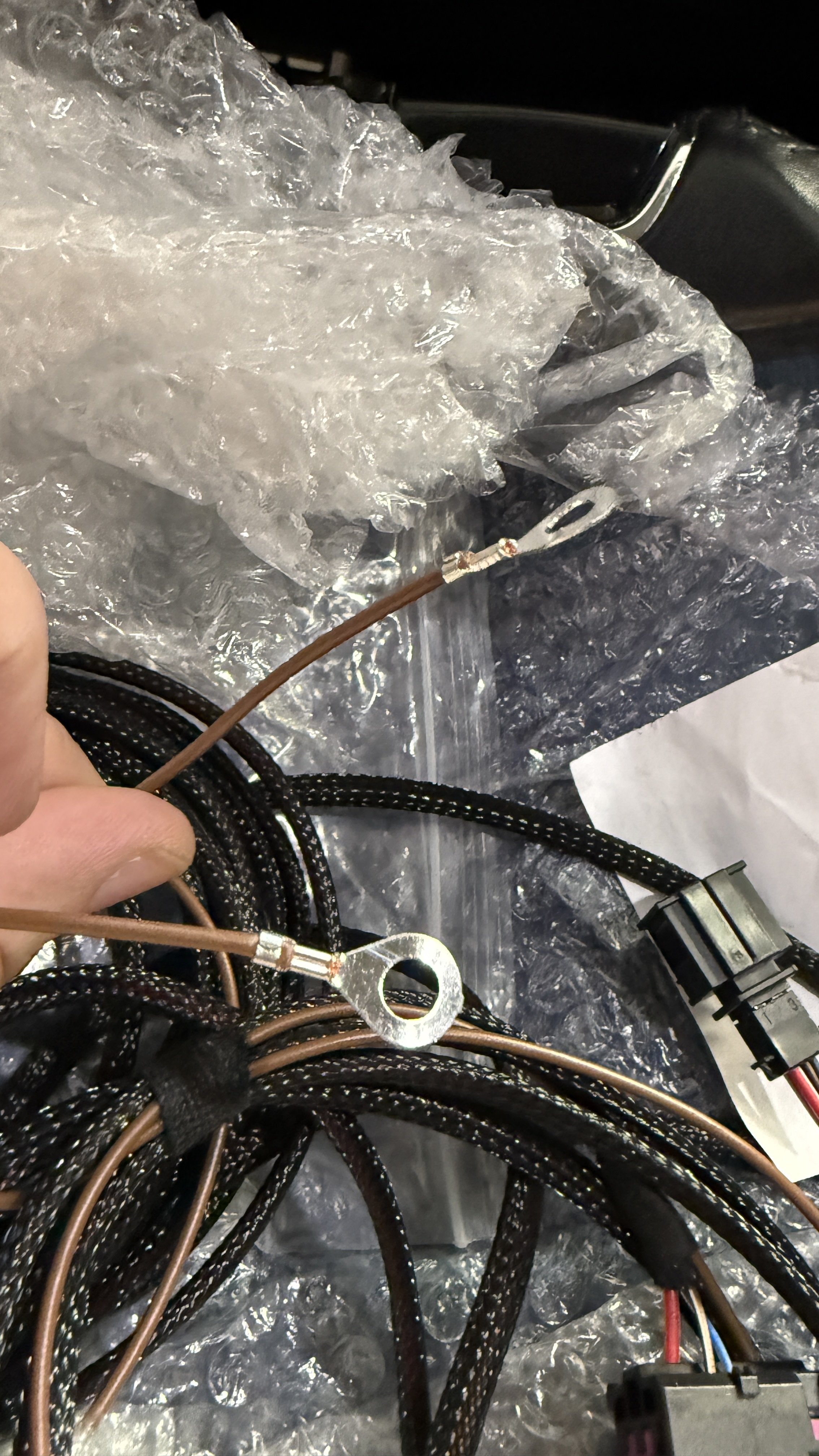

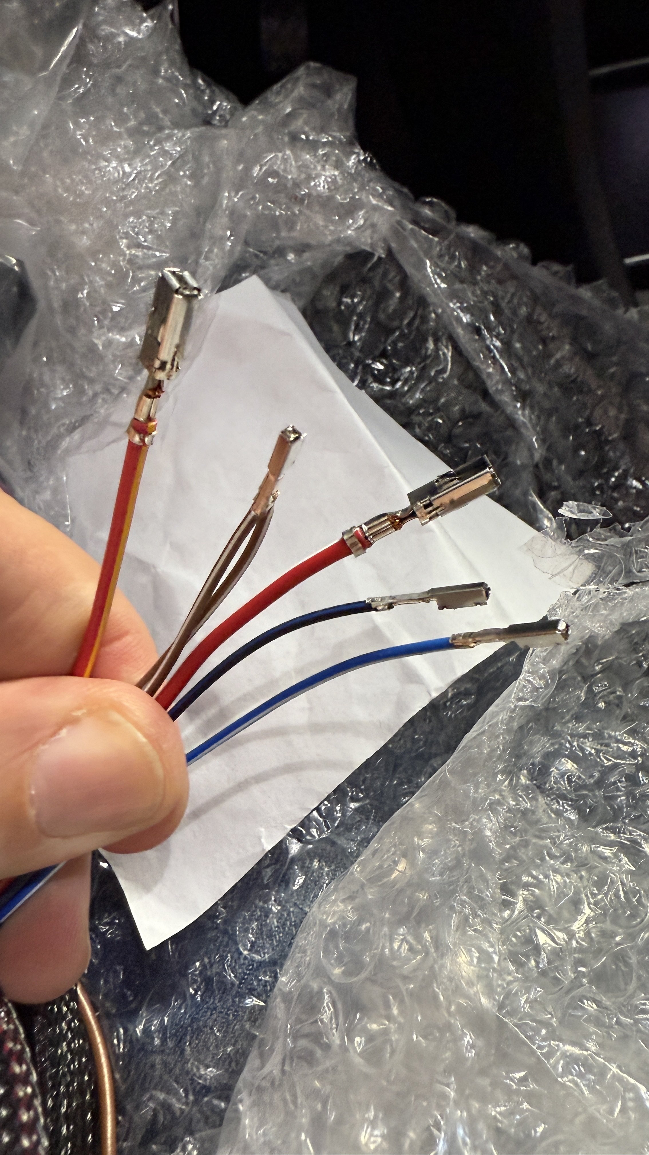

The main harness thas the following wires
  • 2 brown with eyelet which I suppose are the mass (1 for each seat)
  • 1 red and white for one seat + 1 red and yellow for the the other seat, each with big terminals
  • 1 blue and white for one seat + 1 dark blue (almost black), each with small terminals
  • 2 brown and white which join at the end in a unique small terminal
Where do I attach this wires? Attached You can see the photos

rt/ye = BCM T73a/2
rt/wh = BCM T73a/5
bl/wh = BCM T73C/43
bk/bl= BCM T73C/40
No warrenty
56 minutes ago, Cairus said:
rt/ye = BCM T73a/2 --> Driver seat?
rt/wh = BCM T73a/5 --> Driver seat?
bl/wh = BCM T73C/43 --> Passenger seat?
bk/bl= BCM T73C/40 --> Passenger seat?
2 Brown/White: where?
2 Brown (Mass): it doesn't matter where?
br/wh = BCM T73C/56
7 minutes ago, Cairus said:
br/wh = BCM T73C/56
Thanks
Of course if the upholterer, installed the driver side on the passenger side and viceversa, the connections must be inverted, apart the brown/white, isnt' it?
