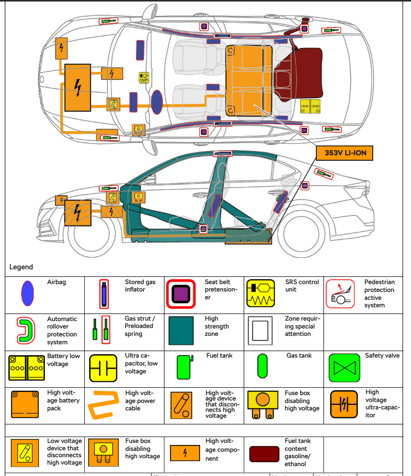

8 hours ago, sqdk said:
've found is a black bolted-on plastic cover in the trunk near the high voltage battery
The black bolted-on plastic cover that you mention is hiding the 12V battery that you want to disconnect. Simply unbolt the plastic cover, and you'll have the access to the 12V battery connectors.
FYI: what you consider to be "the high voltage battery" is in fact the fuel tank. The HV battery is under the floor under the rear seats - see screenshot of the Octavia PHEV Rescue Sheet and the legend therein...
Interesting, what is item 2 (stored gas inflator) used for - is for the airbags rather than using integrated pyro devices ?
