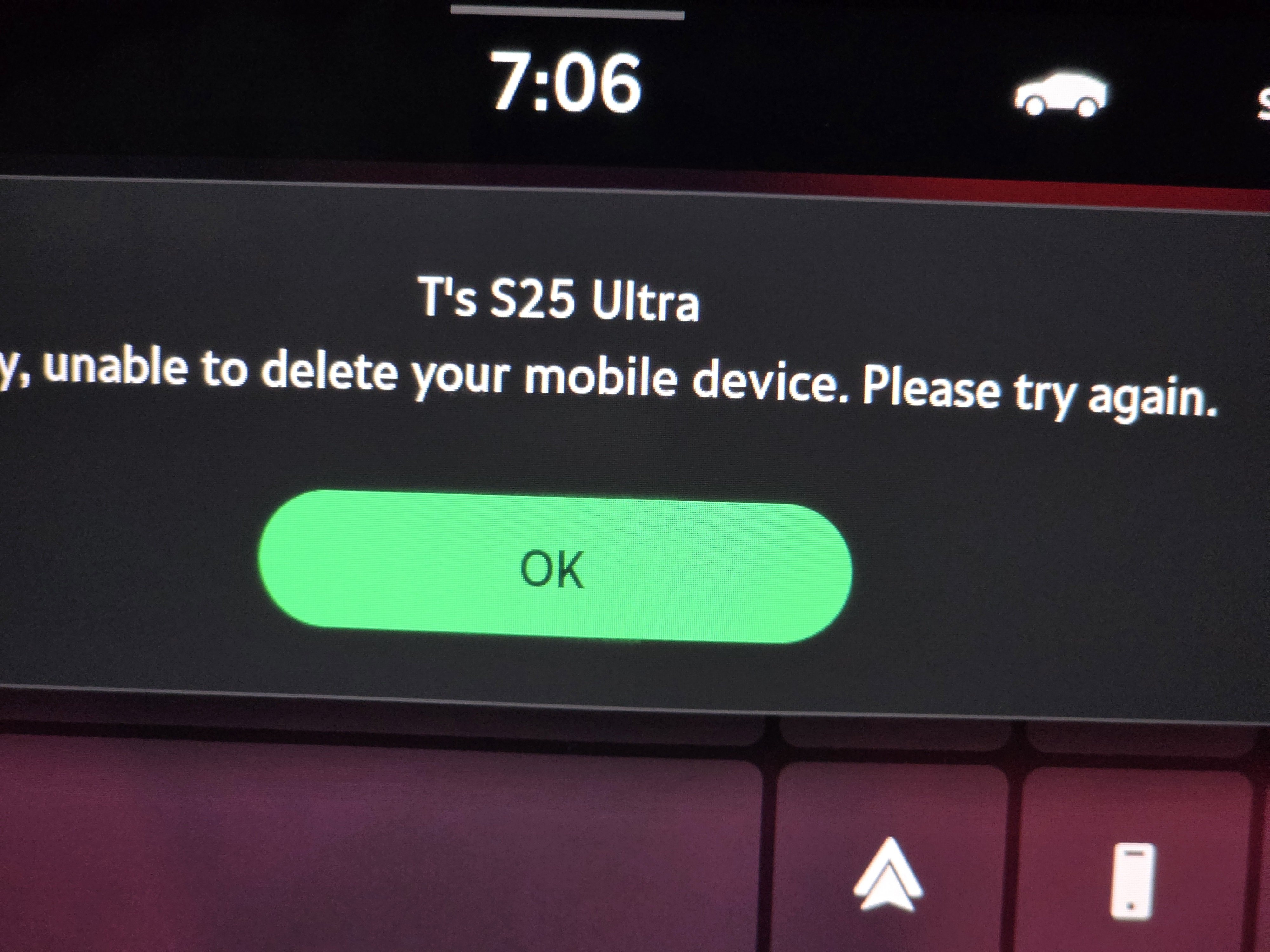

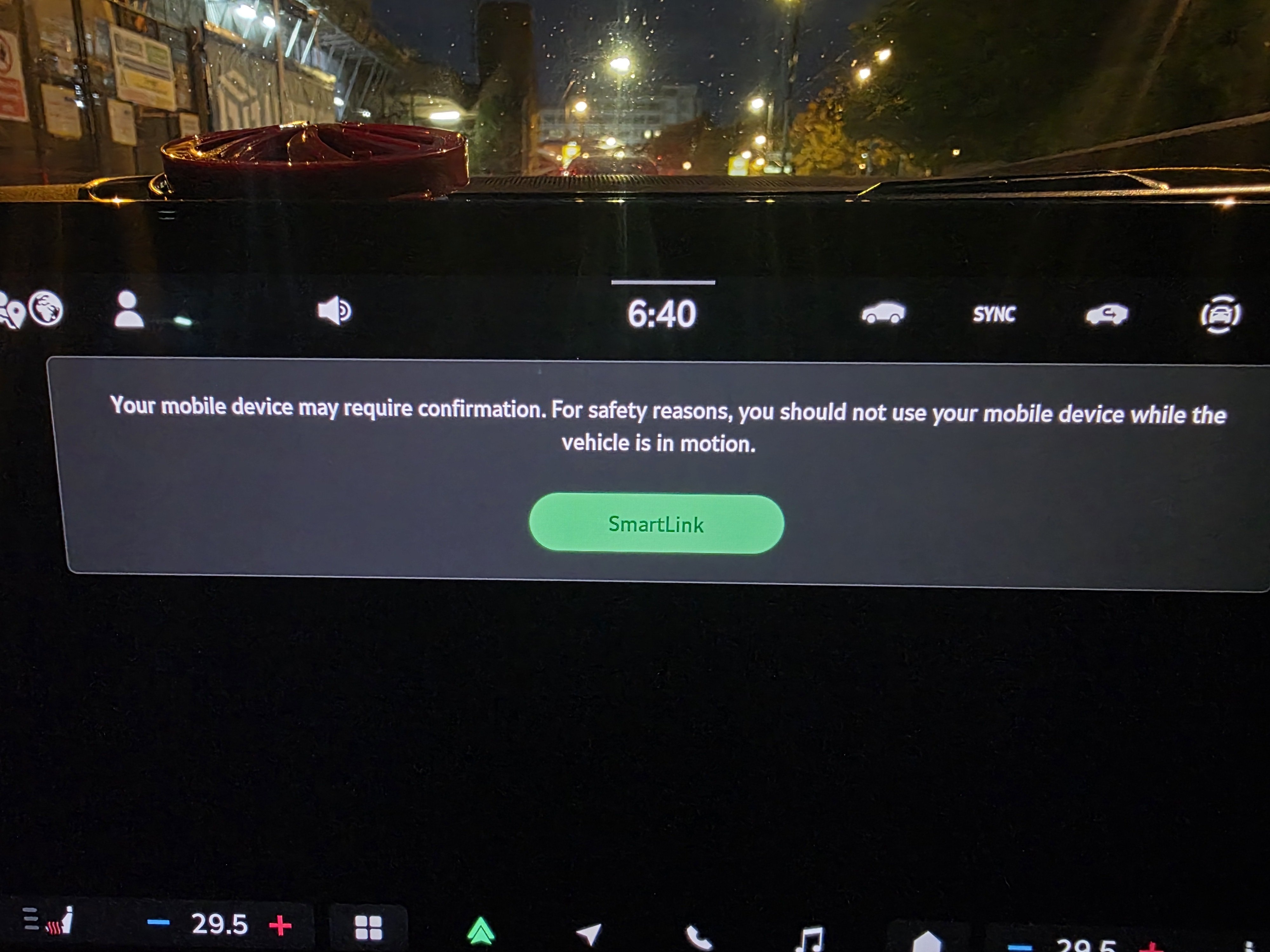

Hi I've started getting this message not every time but enough to be a problem.
When it happens I press ok there is nothing on phone to confirm so I try to disconnect and get the 2nd message so then I have to turn car off or reboot infotainment to get it to connect any ideas.
Ive tryed so far
Unpair everything phone and car
Uninstall AA and reinstalled on phone
Cleared cache and date
