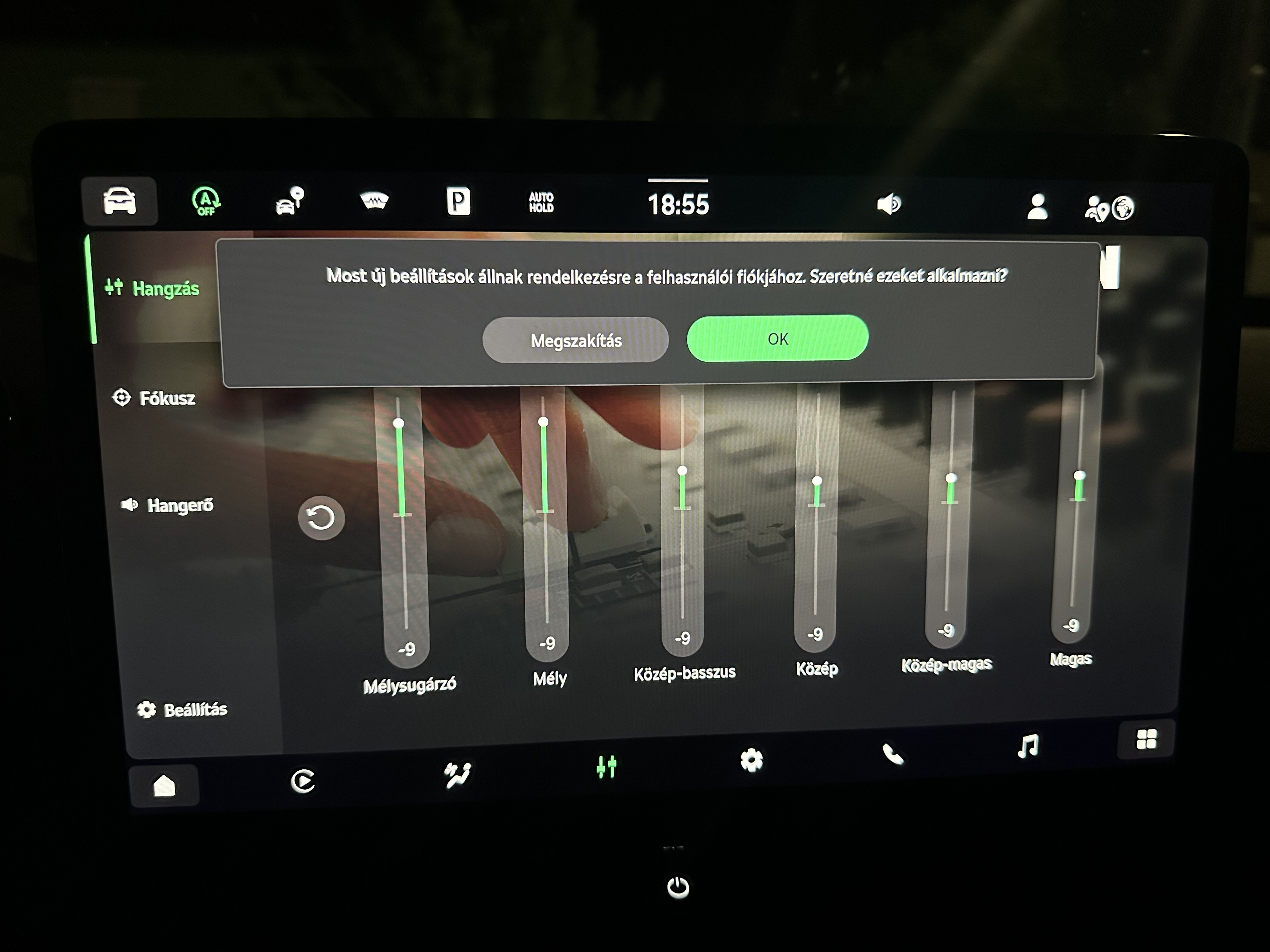

Recently got my Superb, and there is only one annoying software habit of the car.
Every start begins with a question from the car, you can see it on the picture. It says “New settings are available for your profile. Would you like to apply them?”
If I choose OK, then it would ruin something - deflate lumbar support, reset side mirror positions, or any random thing.
If I choose “megszakítás” which is abort, everything stays normal.
Does anybody have the same issue?
Thanks a lot in advance!

User setting / privacy and settings / and disable online personalisation
Yep, mine 25 plate does it too, very annoying so I disabled online personalisation too.
That works, thanks a lot!
