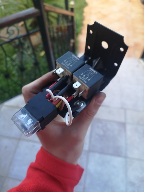

May I add it could be worthwhile to implement my solution with Behr TSW32 or 31 based on your liking
322386816_1648906328871526_5534846985774524680_n.thumb.jpg.813980bbb26214ae798b9426cbd8319c.jpg
Edited by Thefeliciahacker
That looks a serious piece of kit, probably doubling the value of my truck if I was to fit it.
But never say never, let’s get the pipes fitted correctly and see how the truck reacts to that first.
Haha it's not expensive and a dual speed fan will be quiete,r more efficient and redundant

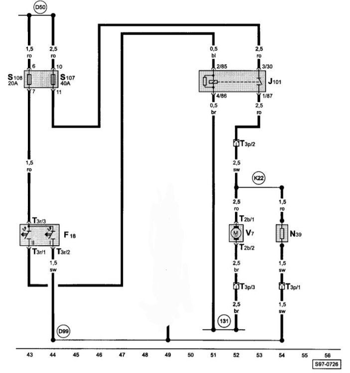

2-speed FAB for cars without AC is much simpler - here's wiring for 1.9D. The most expensive part is probably the fan resistor.
If you get a thermal switch with higher switching point same as the original switch, it will just work the same as original if the resistor fails or if the lower speed doesn't provide enough cooling. Low speed switch would only provide some air movement after the car stops. The resistor limits current to the motor during spin up, which reduces wear.
