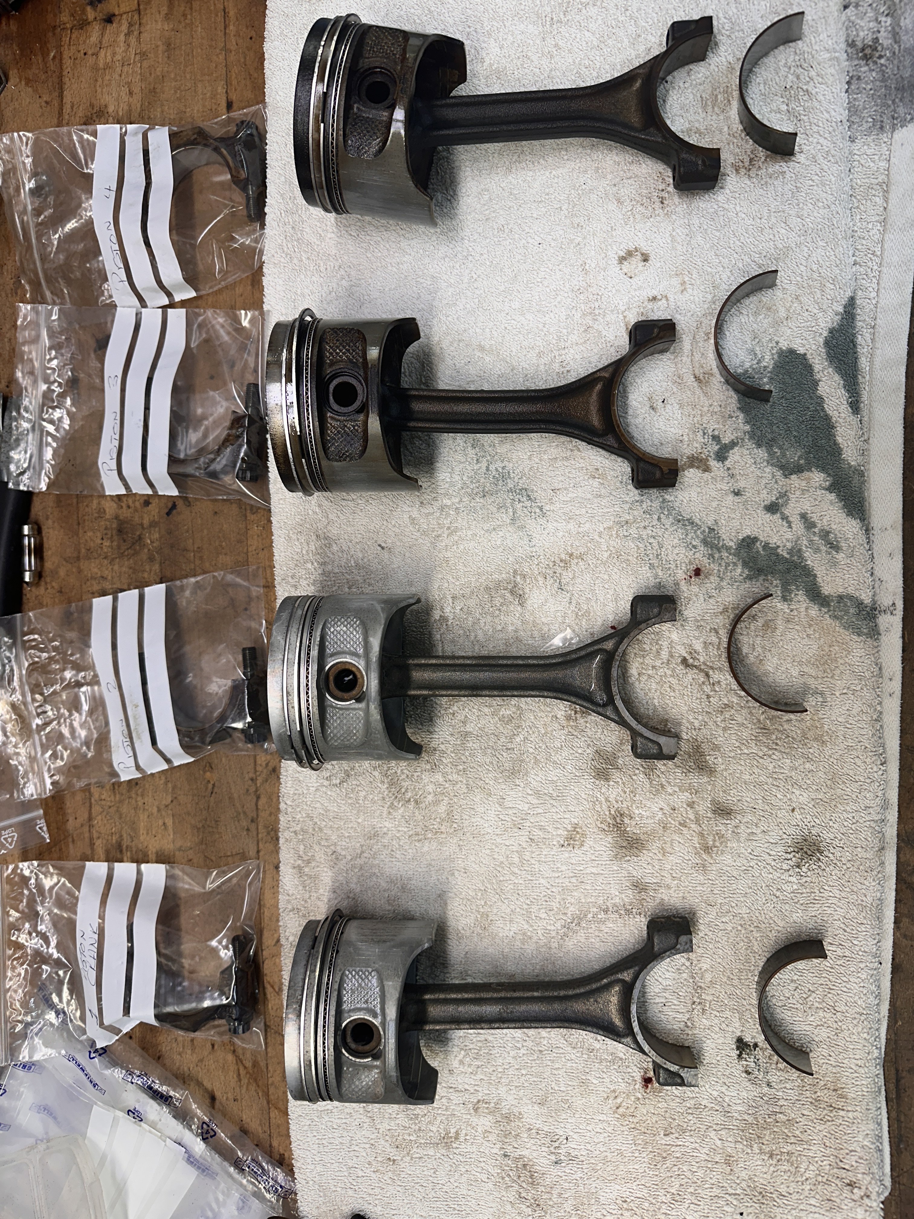

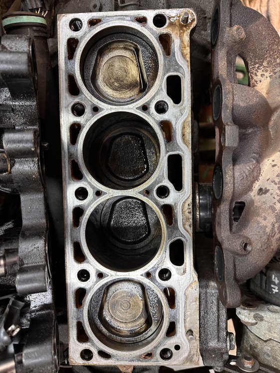

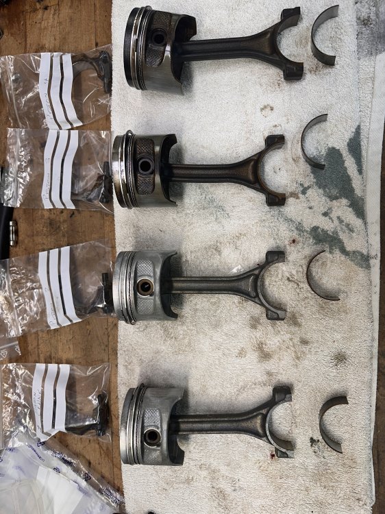

Hi guys just a quick update with a few pictures.
  • I’ve now had the head skimmed as it was warped and out of spec so is looking the bees knees now.
  • Oil poured into the barrels as a trial and it sat there for over a week and I ended up scooping it out with rags 😂
  • Sonic cleaner and carb clearer bought along with head bolts and gaskets.
  • Sump removed and oil pickup removed.
With all that bought I thought it was time to get the pistons out and give them a clean and measure the con rod shells. So with that in mind here’s some measurements and pics.

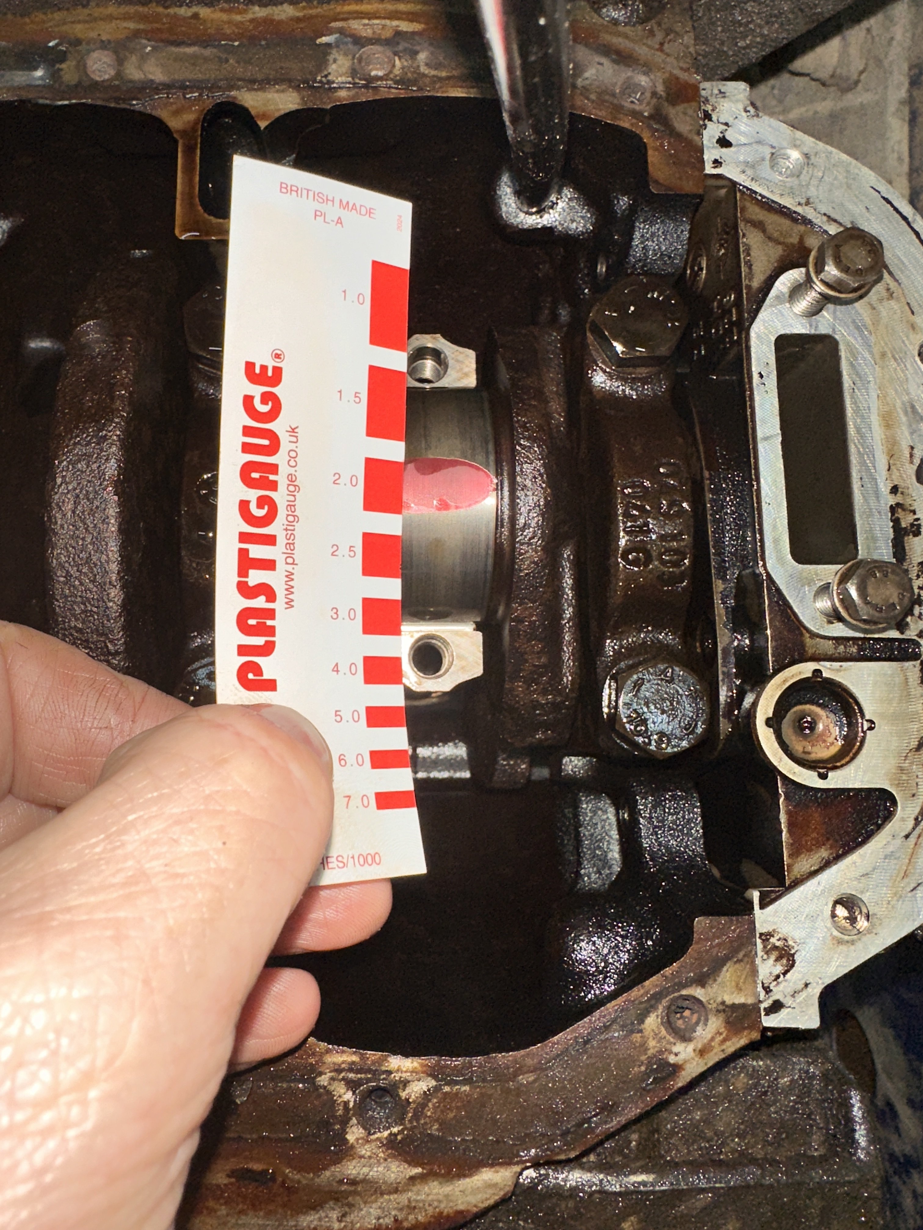

  • The con rod shells to crank gap all measured roughly the same of 0.2 which according to the Haynes manual is showing little to no wear and the crank shows no damage either.
  • The pistons all removed and again showing little wear to no wear.
  • 2 out of the 4 pistons have been in the sonic cleaner and though when removed the looked fine (to me) the ring are moving more freely and go deeper into the piston cutout than the previously did.
So that’s where I’m at right now but I’m going to be cracking on with it over the next few weeks.
Excellent, for the mileage EVEN more excellent! 50μm is perfect, I am super happy.
  1. The pistons all removed and again showing little wear to no wear.
  2. 2 out of the 4 pistons have been in the sonic cleaner and though when removed the looked fine (to me) the ring are moving more freely and go deeper into the piston cutout than the previously did.
Pistons don't just look better, they look brand new.

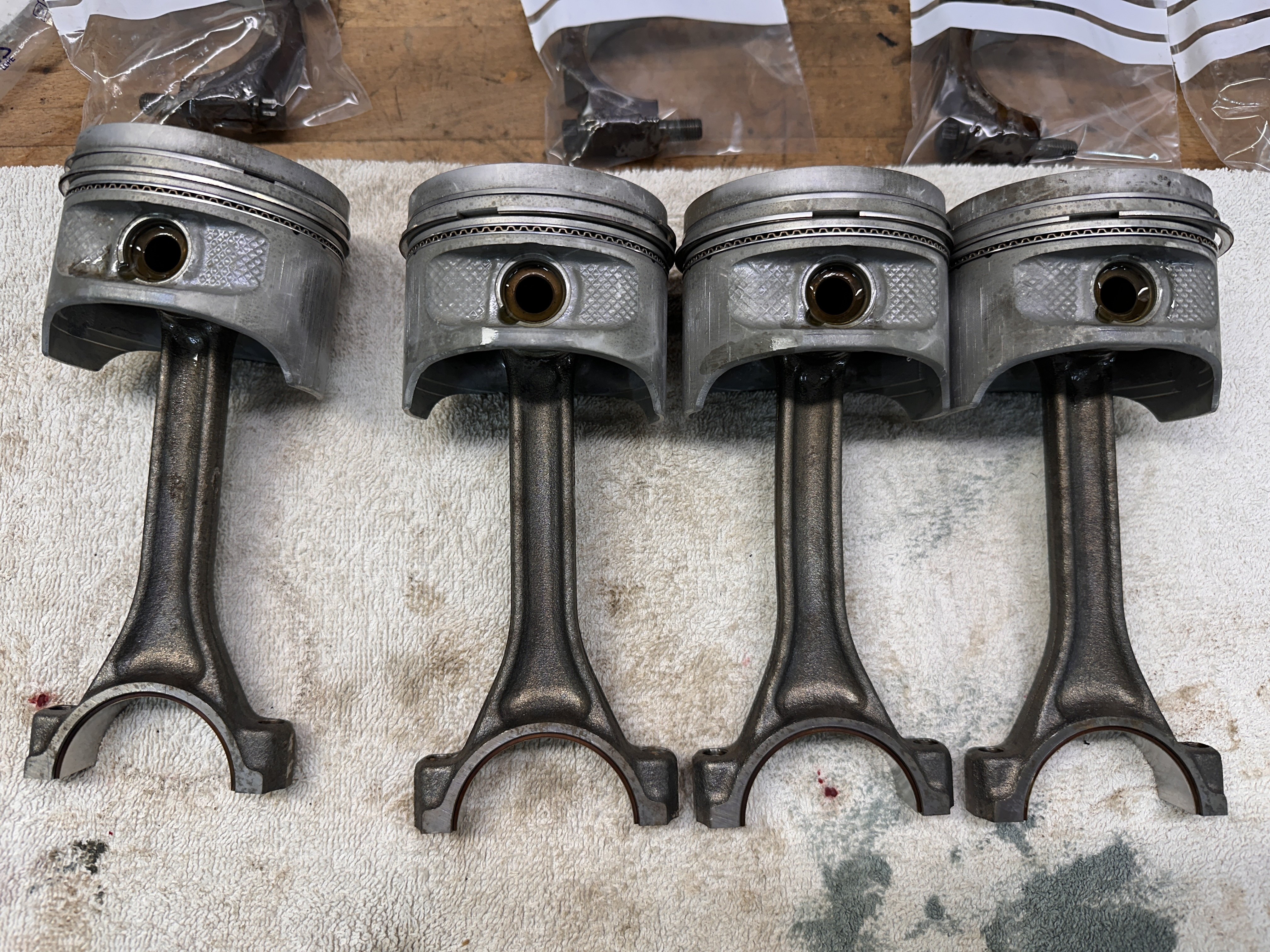

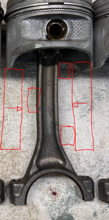

BIG TROUBLE OR IS IT?
I’ve cleaned the last two pistons tonight and notice an issue with number 3. This probably explains why when I did the compression test it was the lowest. Do I do what I would think is unscrupulous or replace the (what looks to me) bent con rod?
Yeah, it is bent. I thought I was seeing it, but I said my eyes were deceiving me.
These conrods are cast iron, you CAN unbend them using a vice and 3 wooden blocks.
There is no risk of snapping them.
The only problem with this bent conrod is that you are increasing thrust loading and causing more wear on one side of the bore.
I can see it’s bent and putting it in a vice does sound appealing but how straight do I need to get it?
Is close good enough or does it need to be perfect?
Can I apply heat to help it along its way?
Straight enough, if I were to give you a number, it would be L/1000, where L is the rod length, so if the rod is 250mm (which it is not) a deviation of 0.25mm is acceptable.
It doesn't need to be nor will it ever be and most surely you can't measure it on a sand cast textured surface. If you have a laser pointer, it can help you visually, but trust me, where your eyes can't see the bend, the bend is acceptable.
Categorically NOT, if you do, you run the risk of tempering the cast iron and depending on how it cools down, it can become either very brittle or super ductile.
Edited by Thefeliciahacker
