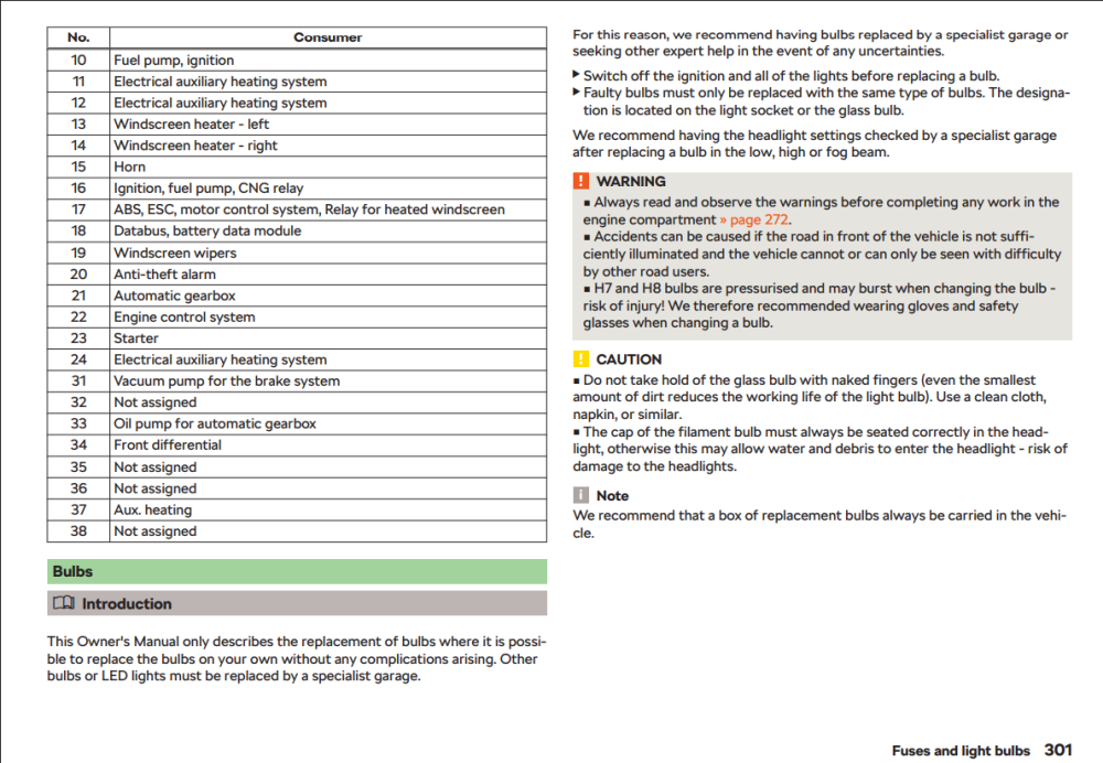

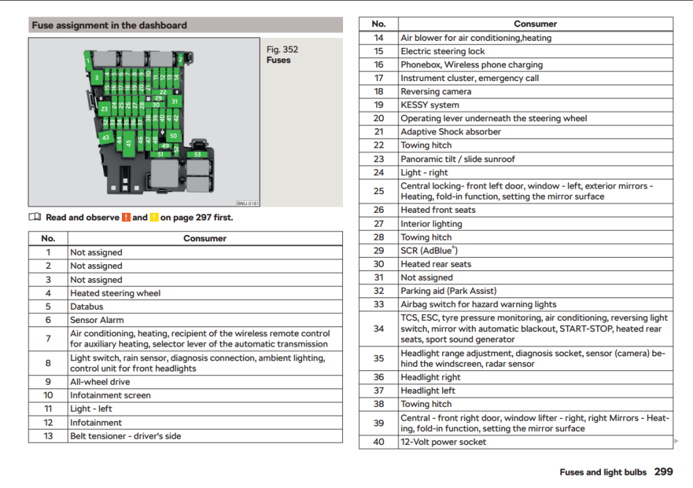

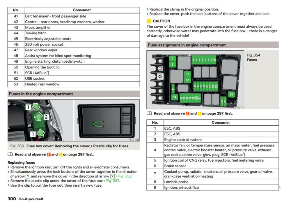

Hi Lee01
Thanks for that, fuse 42 under dash. Somehow I missed that in my book, however rear doors lock/unlock so its not the fuse.
