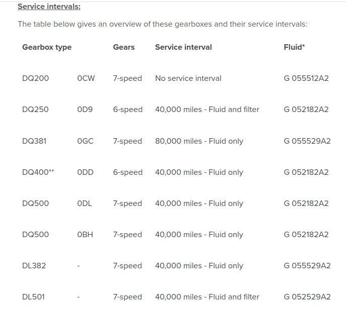

The service interval for the DQ381 is 80k miles, I had my one done slightly early at 70k but that has no bearing on the fault with the box from what I read.

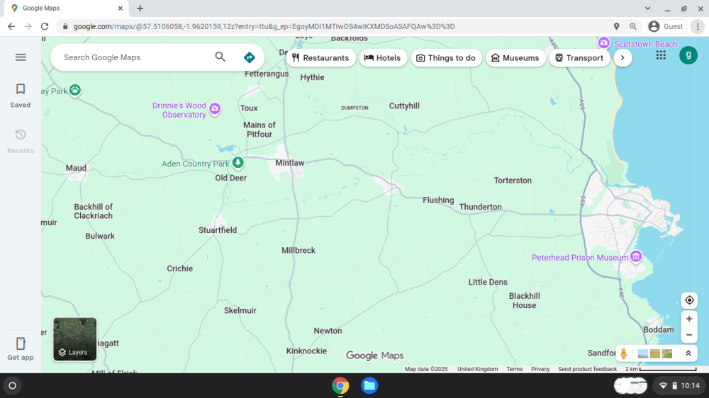

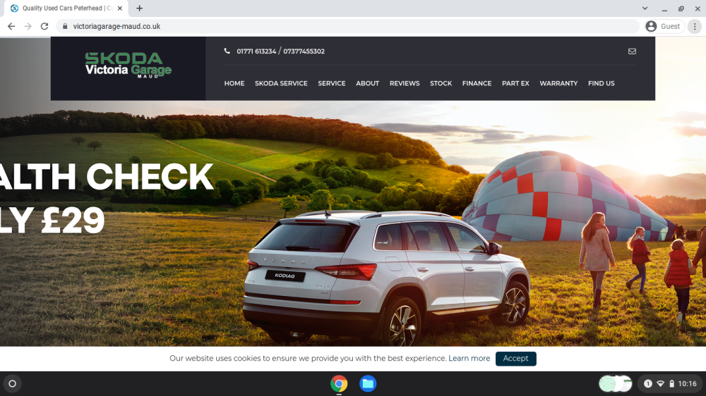

@Sailfast How do you know the Servicing was due at 40,000 miles if you do not know what DSG you have, who told you it was?......... As far as Hawco Peterhead or even Inverness that says it all. Best visit or speak to Victoria Garage Maud's technician.. So all of 15 miles to travel (30 return) , & Proper mechanics with all the gear and more than ideas and they charge realistic prices. People travel long distances so as not needing to go to John Clark Dealerships. or Arnold Clarks or HAWCO.

There is a filter to change with a DQ381, and if a Service Desk person or a tech said only needs doing at each 2nd service which if they were doing by the VW Schedule would be at 160,000 miles i would not have them touching the vehicle. I hope the Haldex servicing is being done correctly at 3 years / 30,000 miles or sooner and not just an oil change.
