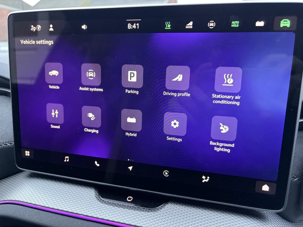

probably a really stupid question but here goes.....I have a hybrid mk2 Kodiaq and quite regularly end up ferrying my daughter around various activities and end up waiting in the cold. I can't seem to find how to get the heating to work when the ignition is on (either with charge left in the battery or not). I can get the fan to operate and change speed but i can't get any hot air out I'm sick of being cold! Any ideas what I'm doing wrong?
The feature you want is “Stationary Air Conditioning”, and it’s in vehicle settings (top row, right hand end - but I have moved those about so could be in another place on the screen for you … swipe left or right for additional settings). In the pic you can see that I have set it as a shortcut (green icon to the right of the clock)…. Tap it to turn it on (turns green), tap it to turn it off (goes grey).
This is the same feature that allows you to pre-heat (or cool) the car from the app (on the app home page it’s called target temperature)
