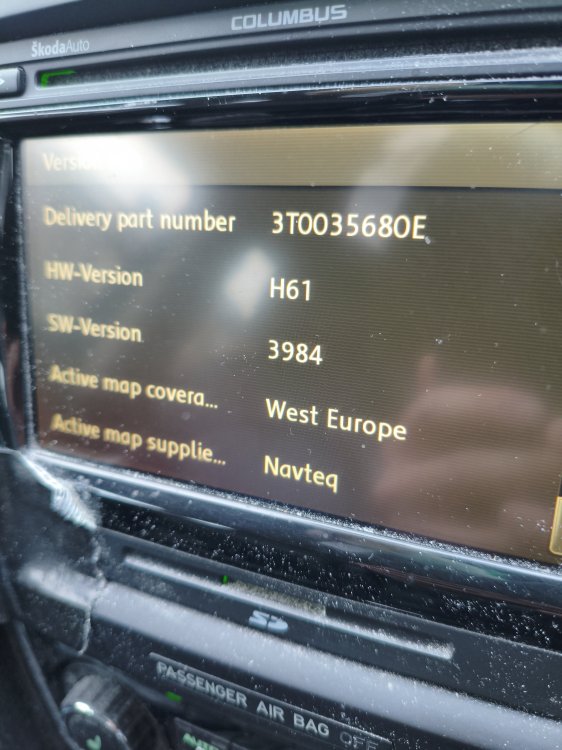

Does this help? From the SETUP button menu pressed 15 seconds.
From my description, what do you think is the issue with my unit and is the only fix a replacement unit?
Thanks
Edited by newskodadriver
As you can see, part number of your unit is 3T0035680E with which I can agree )
I will send you link to download firmware 5238 so you can have your unit upgraded just pls note after the upgrade you will need to load maps too.
Sorry I don't understand, what do you mean I have to load maps? I don't ever use the maps on columnus as I have a mobile phone with Google maps.
You think the issues are software based? But why has it taken 13.5 years for it to break down like this.
Also, what do I do with the Iso file ? Burn it to CD and just put it in and the system will automatically recognise it?
probably your NAND becomes overloaded and requires re-formatting.
Yes, you burn it as an image on CD-R.
