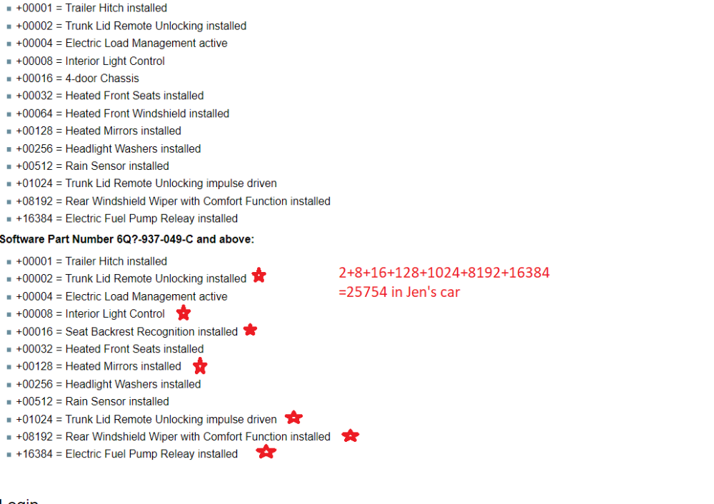

There is some coding, for certain options, as follows (example marked up with the individual coding contributions of one given mk1 Fabia, coding is the sum of all these numbers):
You may well find there's sufficient overlap between any given secondhand unit and what's configured in your car, so you don't find any functional differences.

As Pete said you probably will have to code the replacement unit as the trim level will be slightly different.
