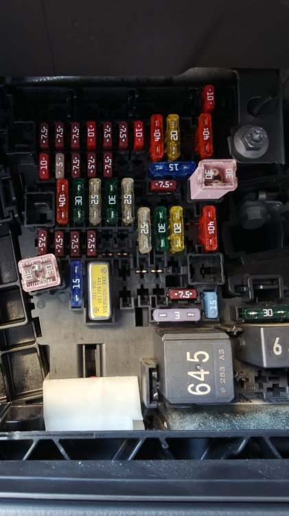

This is how mine is fitted to 48. They aren’t positive negative. Both sides of the tap are positive. I suspect you have the dashcam and piggyback fuses in the wrong slots
Hi, thats great, thanks, yeah i think i had them the wrong way, had the 2 amp closest to the fuse box

No reason. Just were it would fit. The whole of that row of large fuses is switched so any can be used.
so i could just put the piggyback in to 48 with just the 2 Amp?
Yup And put normal fuse back where it belongs.
