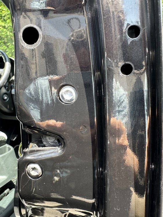

How did you get on with your lock? I'm having same issue unable to remove lock barrel to remove lock mechanism.
Forgot to say, there doesn't appear to be a top screw in the small hole. Bottom screw is there and turns.
Undo the top a few turns and then begin undoing the bottom one a little at a time whilst pulling on the lock and it should pop out. I think I had trouble with the online guides because mine was stuck.
There should be, lots of stories of people dropping it inside the door.
I had a feel around in bottom of door but couldn't find anything. I have tried loosening bottom screw eventually to the point where you couldn't pull on handle but barrel not coming out. Tried key in it and pulling no good and tried trying with a screwdriver.
