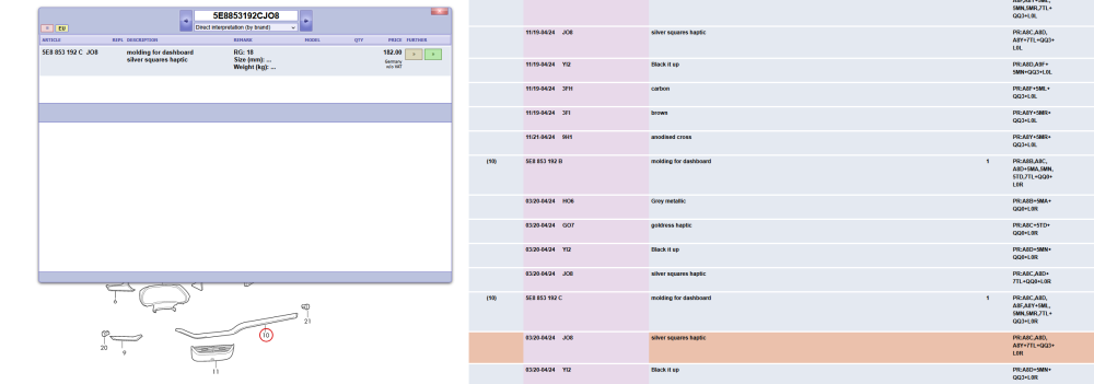

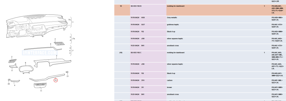

In the below screenshot you can see the three character codes that seem to indicate version, the finish isn't that much of an issue I can simply look at the photos. However getting RGB is the main challenge.

From this information I would assume it is this part, although the description suggests it is textured and not flat.

As you can see from the above, the A & C are indeed revision numbers, the YI2 and 9NL are represent the finish. YI2 being gloss black, 9NL being the carbon-look finish and there's also JO8 which is the haptic squares grey one. In one of my previous screenshots you will find more options, however I have not seen any of them for sale (I bought the only 9NL I could find in my country at parts traders, and have not seen the gloss black for sale once). They could be available through a Skoda dealer.
