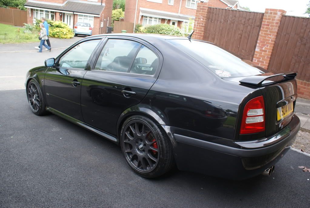

heres the car btw just in case anyone wonders haha going to fit the fmic (hopefully get one made to fit exactly) to fill the centre vent of the bumper including where the no plate sits

I just like the wheels...

I have no idea other mate. But your car looks nice and cant wait to see it when its finished.
