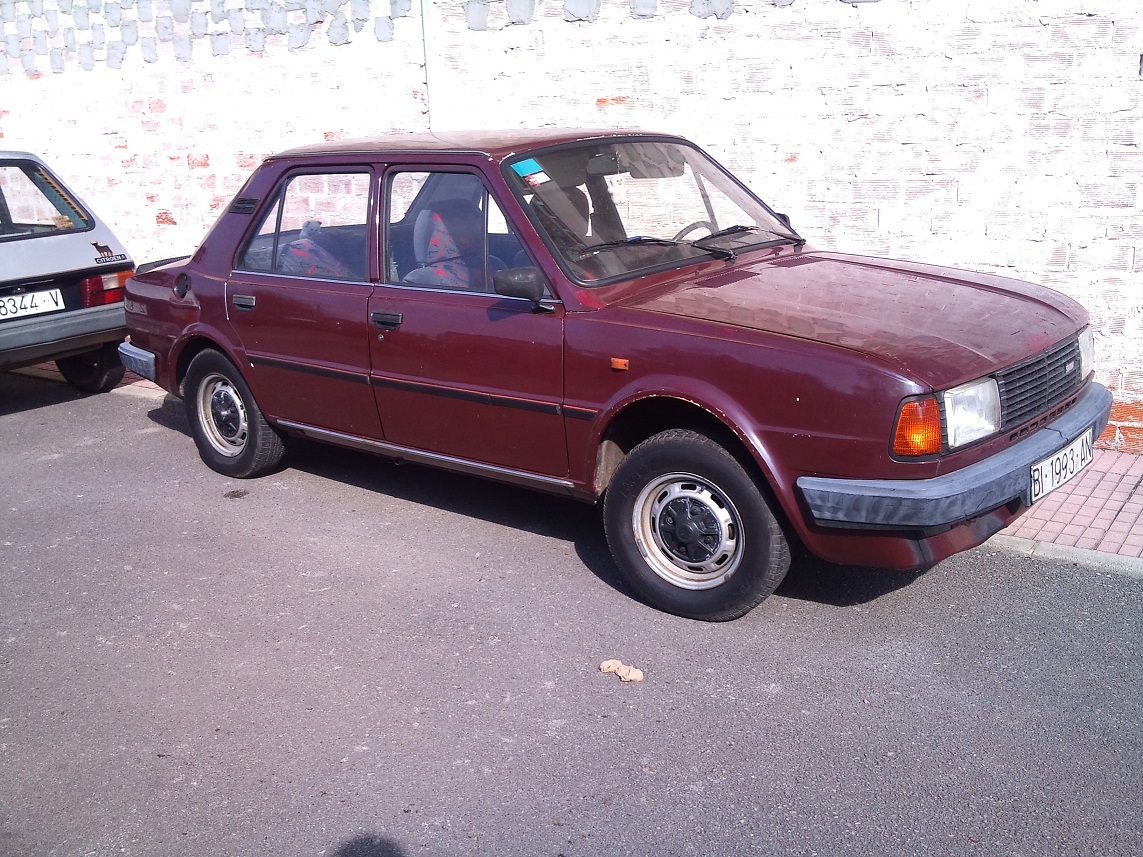

Just then, a friend called me and told me 100km from my house, a man offered a 120LS. "Take the car before I take Thursday or scrapping" said.
Overall, I was left with a car that did not know, ugly, it did not work ..... I am a brave!
The car was an older man who had vision problems, and saw that the temperature was too high, and the head gasket did buffff. 5 liters of coolant inside the engine lasted 15SG. Shot out by the exhaust pipe.
Replace the head gasket and the engine started perfectly. The cylinder head was fine and well the car decided to try to find out if there were more problems.
During two years the car has been waiting to be restored, the family rallies and other classic cars would not let me time.
This summer, after driving 1600km without problems and overcome the TÜV inspection, I decided to start with the restoration and transformation at 130 LR / H.
After completely disassembled, went to the body and paint. There were small spots of rust, but not serious. I decided to paint it matte black and orange.There was some problem with the gloss black paint and left. We had to re-paint it.We remounted the whole car except the interior.
