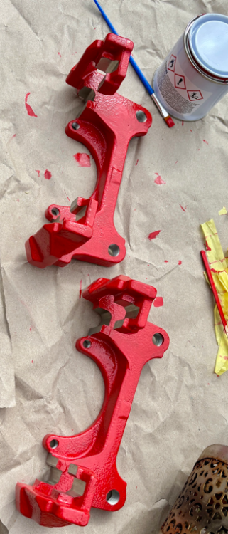

Carriers arrived today, prepared and painted them, Brembo pads incoming ready to fit next week
