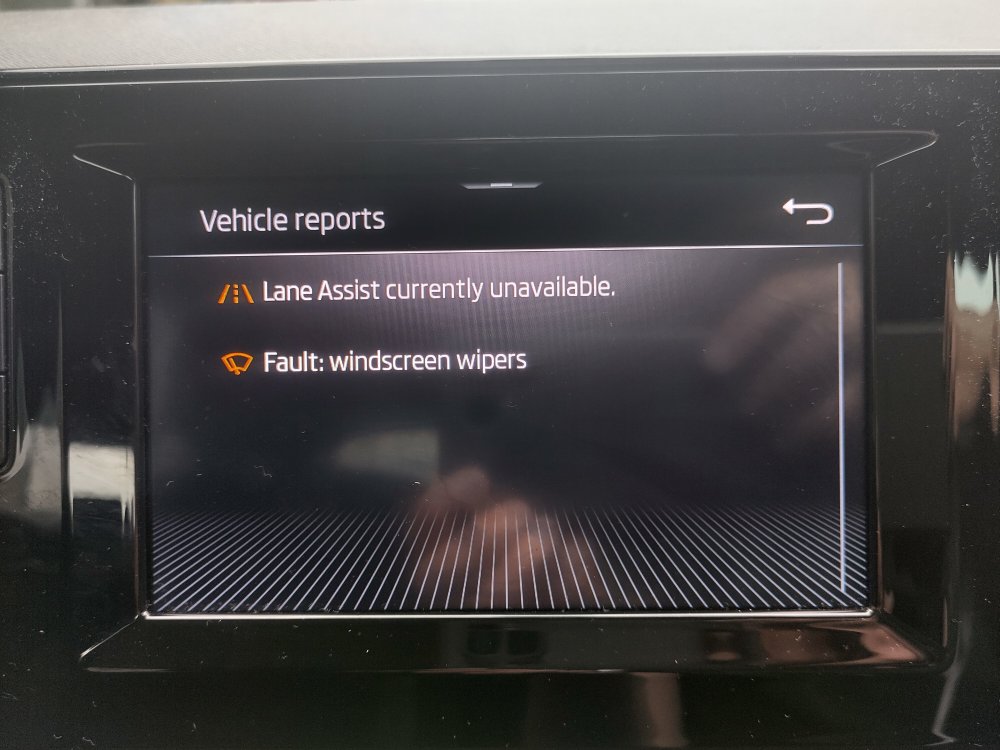

My 2023 Fabia started throwing up two faults. First the windshield wipers stop working and there's a fault about that. So far I have been able to get them started again by turning them on and off a few times. Then another fault happens in rapid succession and the lane assist stops working. I have an extended warranty until September but the dealer suggested it might be out of warranty because I recently had an oil service, MOT, and new tyres fitted at a local garage. Any advice welcome.

Check the battery.

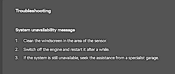

The Lane Assist "Troubleshooting" guidance in my Fabia Mk4's Owner's Manual reads as follows:
So, if there's a windscreen wipers-related fault, it seems not unreasonable that this might disable operation of Lane Assist.
