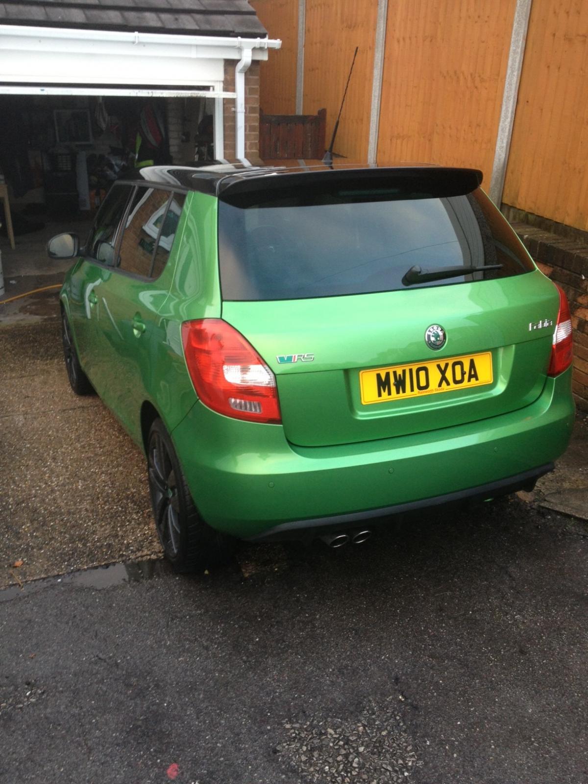

1st day I got the car:

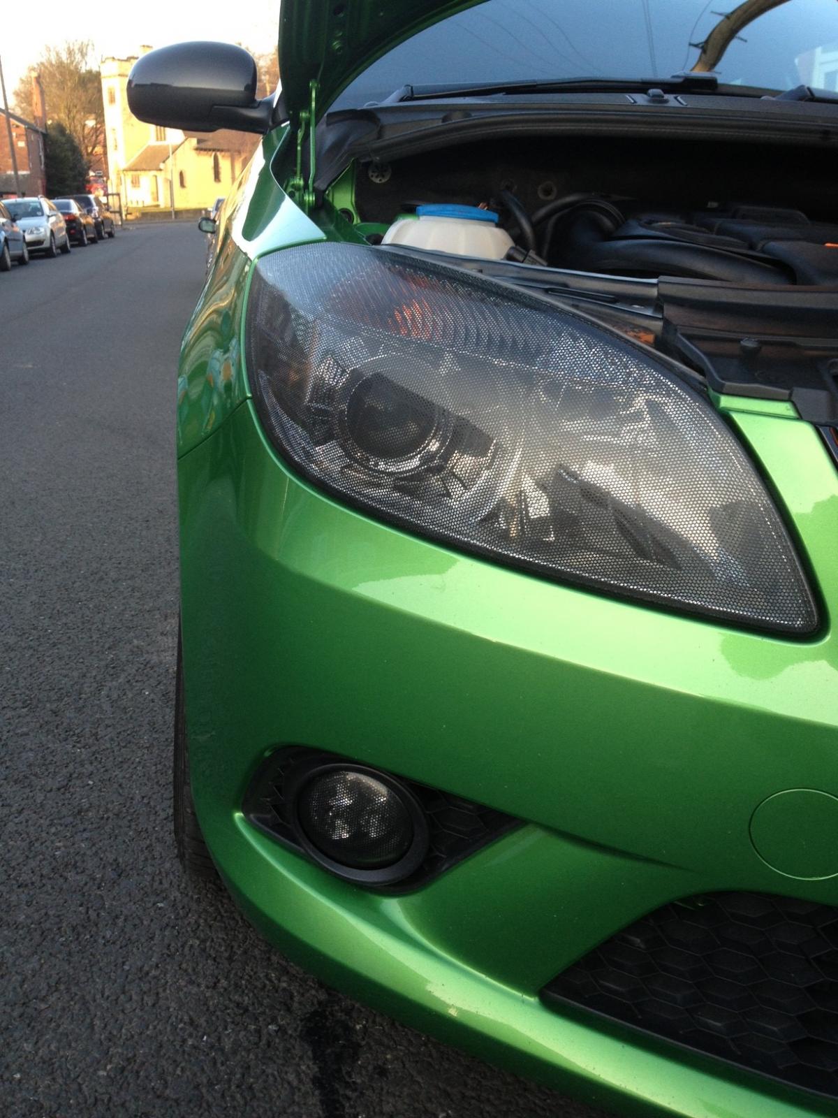

First thing I did was get the headlights like this...
I did them this way as it gives them a different look to the ones that come with the black pack...I like them to be honest :)

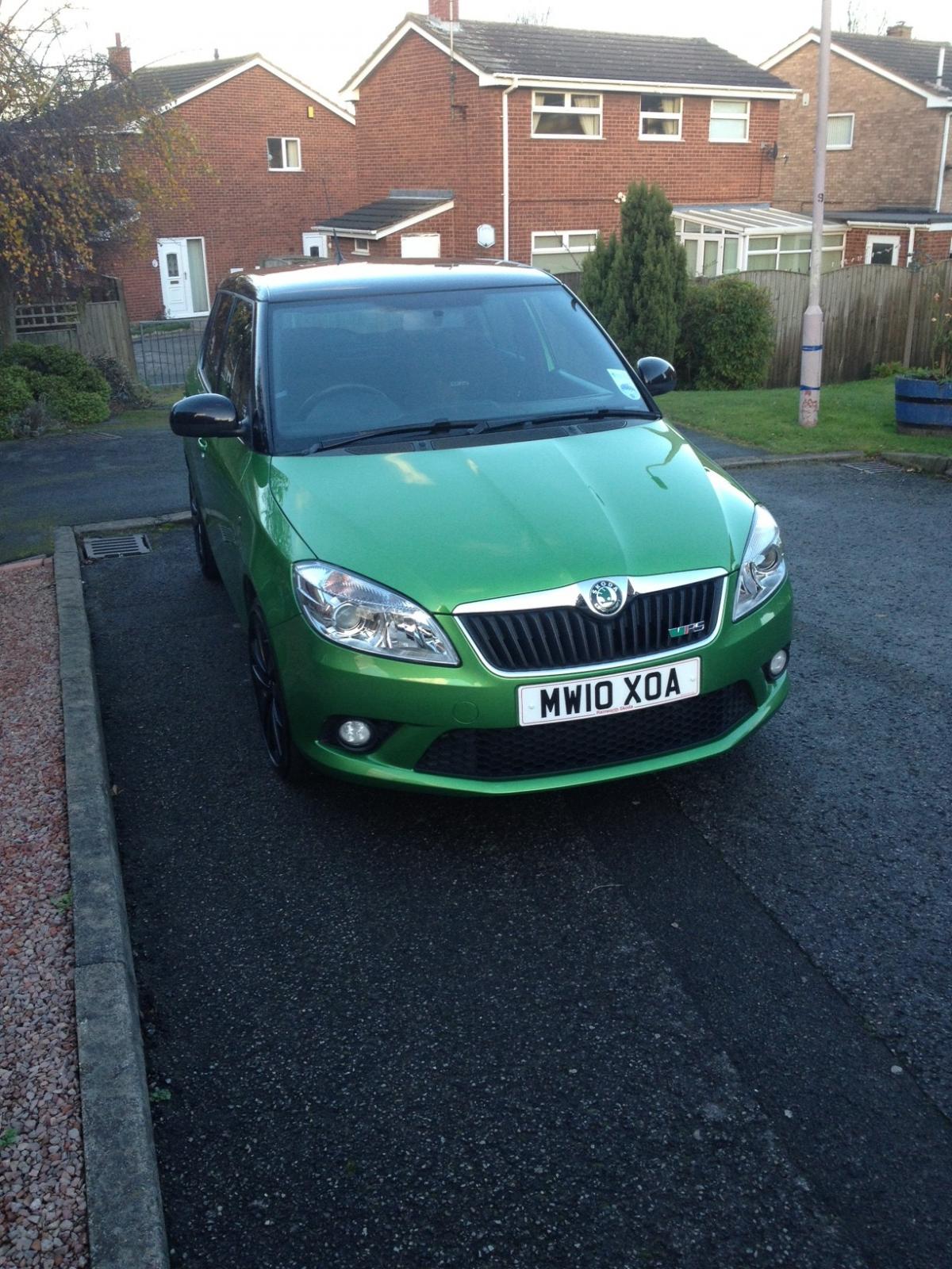

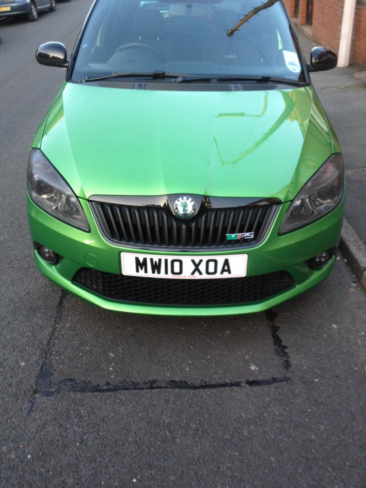

Next I got rid of the horrid chrome grill, I CAN NOT STAND CHROME! (One of my pet hates)

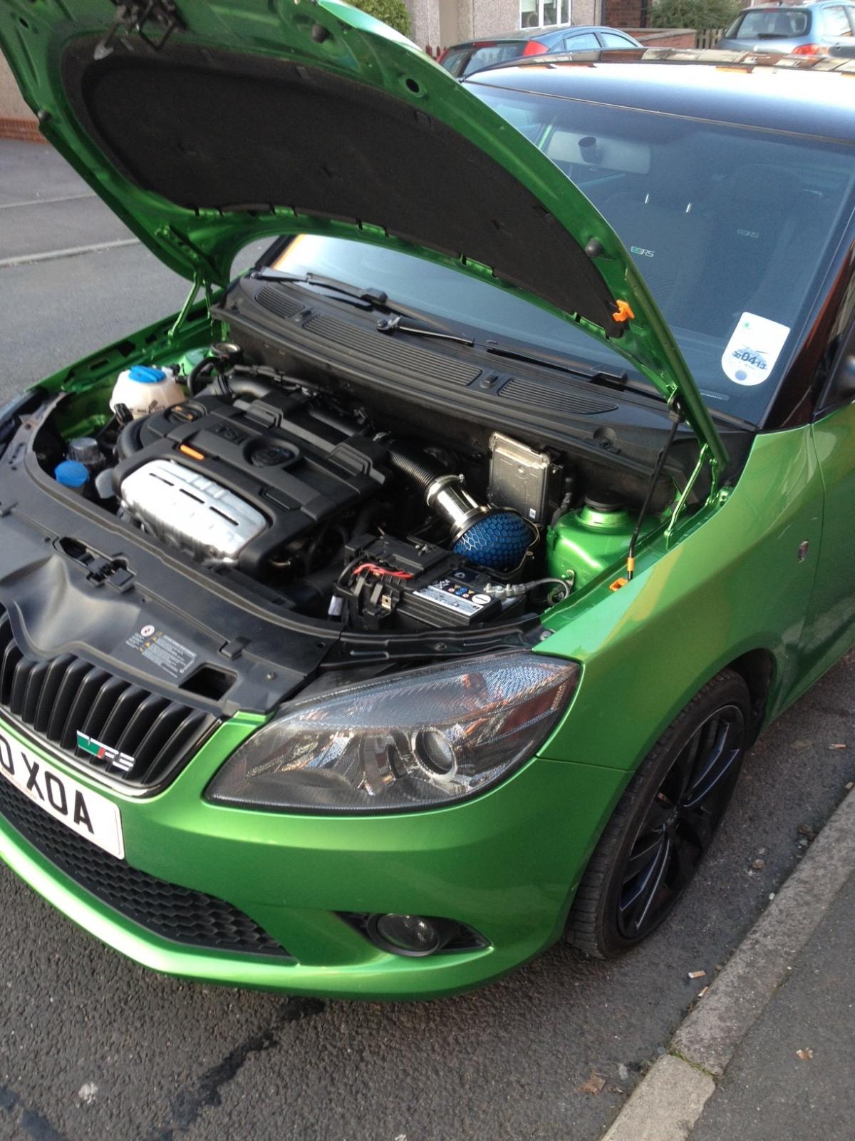

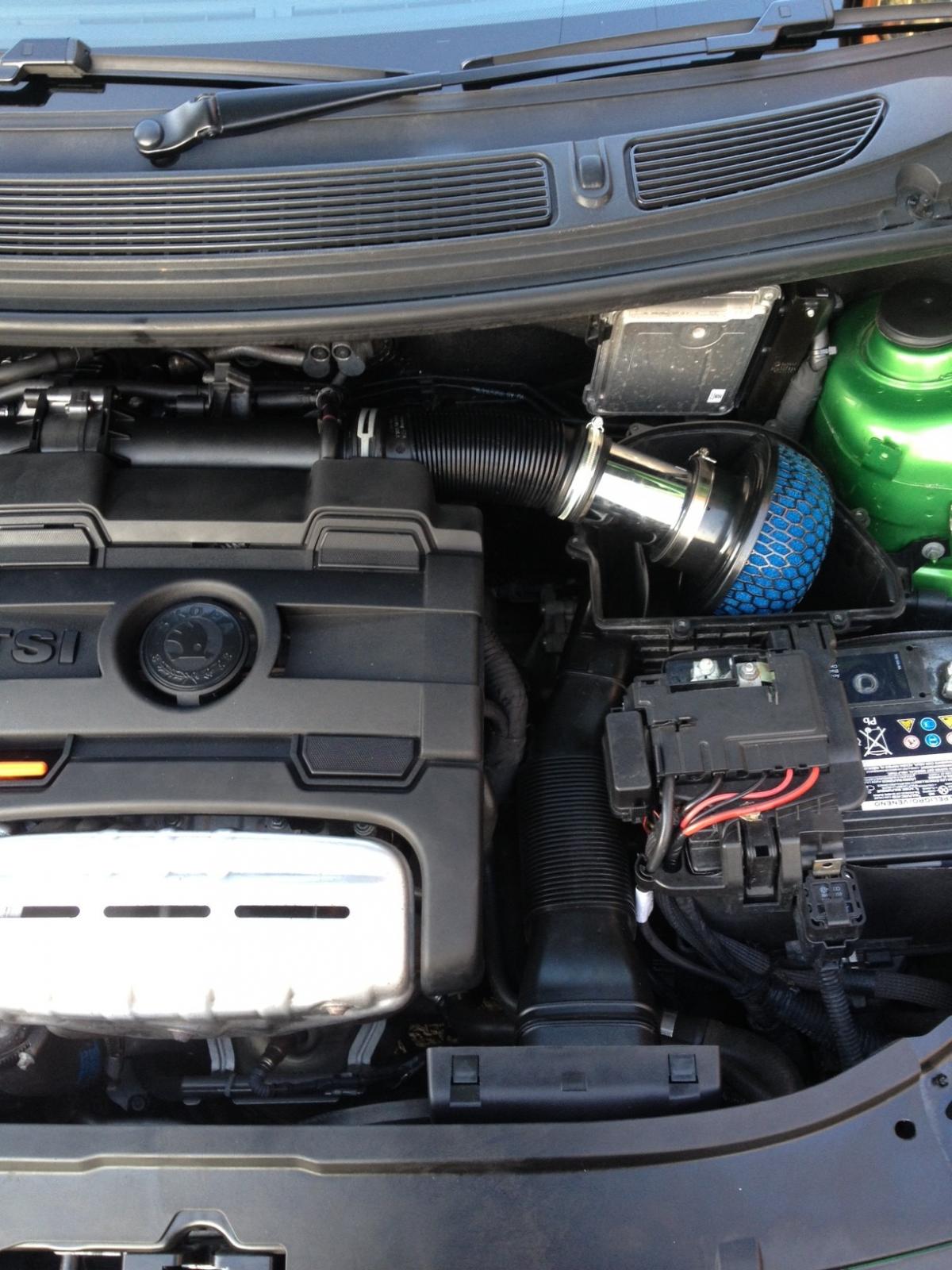

I have been playing round with some ideas for the air filter and to be honest I have tried a number of things and stuck with this at the moment :
What do you guys think about this ?? Do you think it is even doing anything ? Be honest guys !

Quite like the look of the lights in these shots... is that some kind of fly screen looking wrap stuck on the front of the lights? From what I've seen these things are pretty difficult to open up.
As for the intake... I'm no expert, but with it's positioning and the way the cold air flows into the standard box, it looks a little restrictive. Not too mention could be sucking in pretty warm air that close to the engine. I know even the little bonnet prop stick get's quite warm on mine after some 'spirited' driving, and it's further away than your intake. I bet it makes a better sound than the stock setup though!
I saw a post somewhere of a VW Racing intake system fitted... looked very neat, although a little cramped. This solution might require repositioning the battery or using a smaller one though. I've only had my car a few weeks, so I'm still hunting around for the best solution for the intake.
Nice job on the grill... did you just get the Monte one and fit it? I'm having some wrap done this week... should have some photos on my own thread within a week. Fingers crossed it turns out nicely.
Yea mate its called goes on the front of the lights it has little wholes in the wrap so it is easy to push the air bubbles out I didn't do it though local tinting place near me did them. Cost me £30 for both headlights and lower fogs , so a lot cheaper than new headlights and can be easy removed with a hair dryer if needed.
Yea I bought the monte grill was really easy to put on took me about 10 minutes and I can't believe my local dealer wanted around £80 to fit it !!
I have seen them kits was just trying to do something different and I failed lol :( very limited with the amount of space etc the above is about 2 hours of me steering at the engine thinking lmao ! Think it may have to come off put the standard box on and get a better filter for it . Like you said it gets very hot metal on the case gets very very hot so not good :( .
When it gets mapped may look in to getting a smaller battery I know a few people have done this may be to much effort with getting it in the Boot .

Was suppose to put the name in I had to double check and posted it lol ! New to all this think it is called SPI vision tint totally legal
