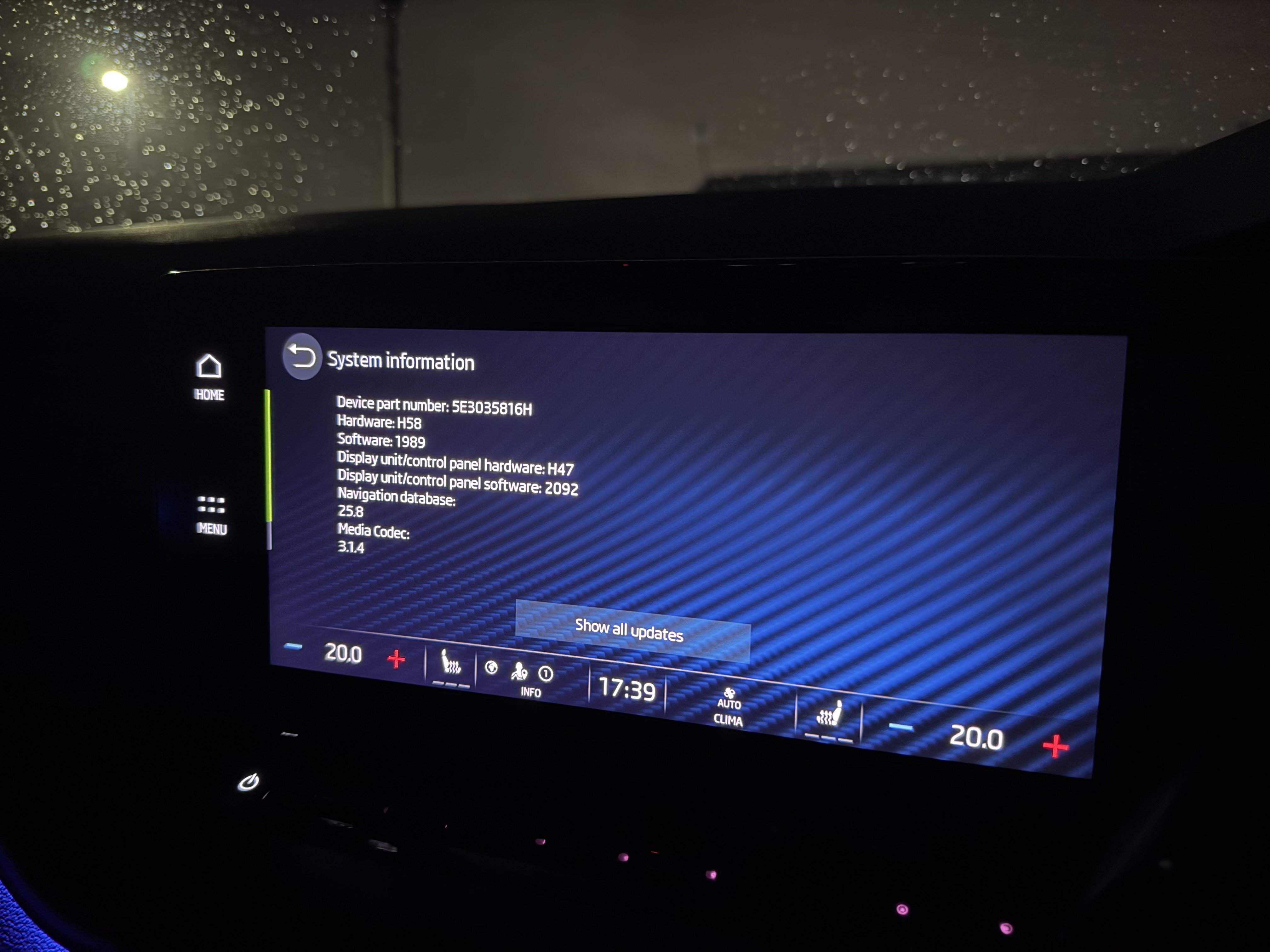

My own car’s details as per the image. (January ‘22 car).
