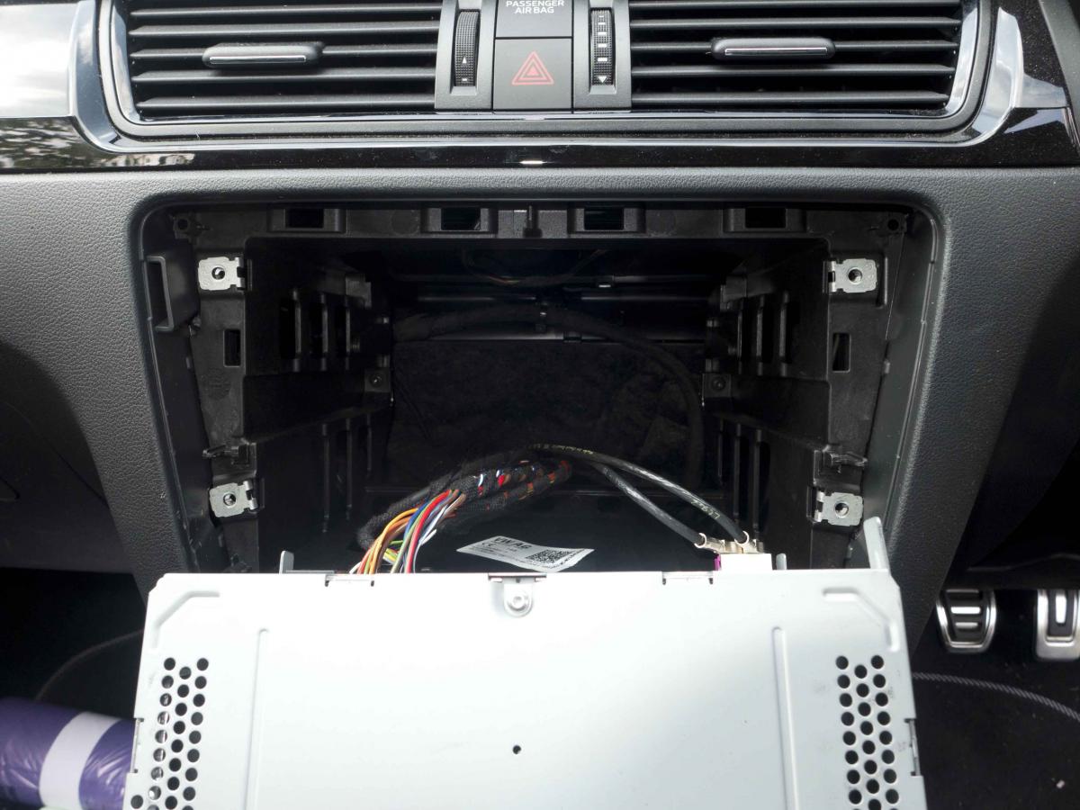

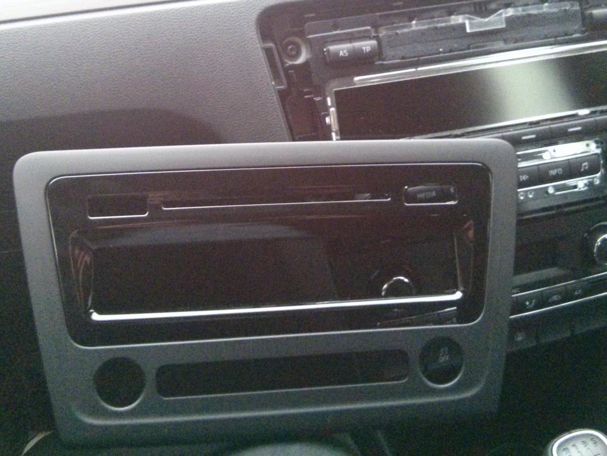

To save anyone else the bother of prying it off, I've attached an image showing the problem with the 'Swing' fascia.
i think (!) that the part in the pic above provides the fascia if you got a double DIN unit like a Kenwood, not amundsen.  You need a further adapter for an amundsen i guess
I thought that too at first, but the tapering is more pronounced on the outside of the fascia than the headunit itself. I'm not 100% sure but pretty hopeful it's the right part. It cost a 11 euros second hand so if it doesn't fit I'll survive ;)
The unit looks almost square when seated in the dash, but seen alone it's more obviously tapered.

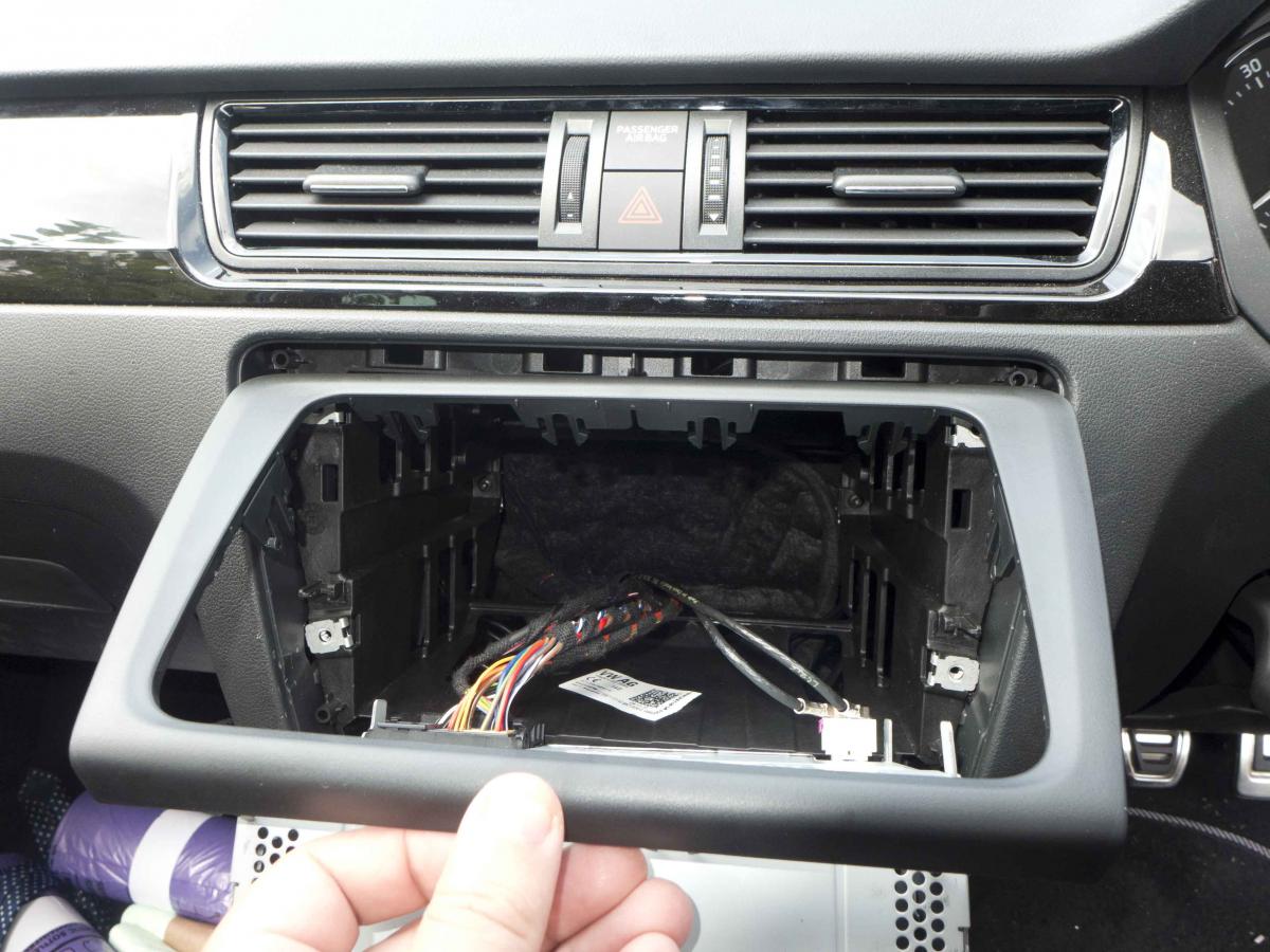

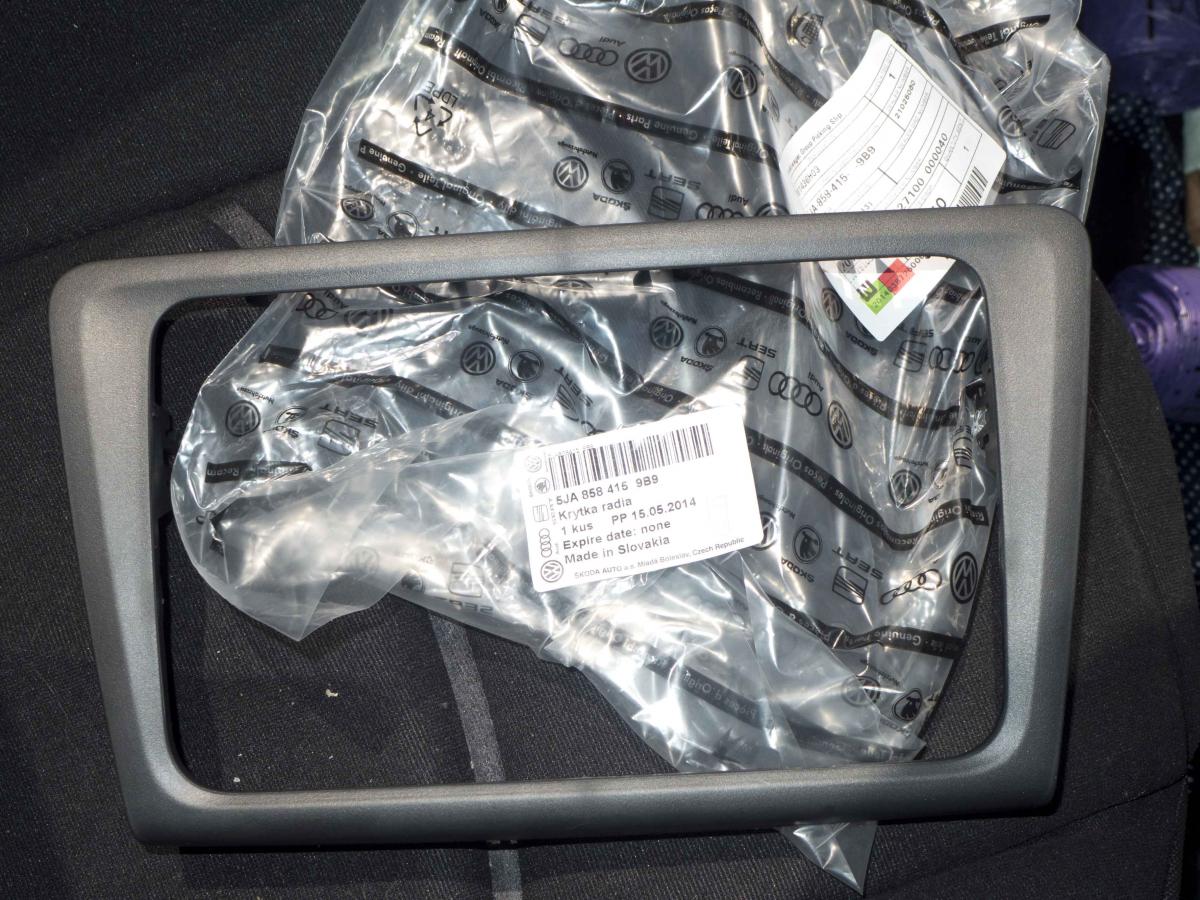

GOOD NEWS.
Mr Skoda turned up with the parts.  Was half expecting it to have a big round hole in it for the radio dial, but NO!  Took a few snaps with the current radio out and the new fascia offered up to it.  Looks very promising.  Didn't pull the radio out completely - only want to do this once!!
Have ordered a Columbus 510 L.  Fingers crossed should arrive by the end of the week and i'll post the work in progress
mu7 when you get the trim can you update us all?
It appears to be the correct part, though I haven't got the head unit yet to test for sure. The inner cutout that looks square is actually about 10mm wider at the top than the bottom.
One word of warning, I got a used one and it's just slightly darker than the fascia it replaces. I suspect it might actually be from a Toledo. I'll try what I have, if it annoys me I'll get a new skoda one.
