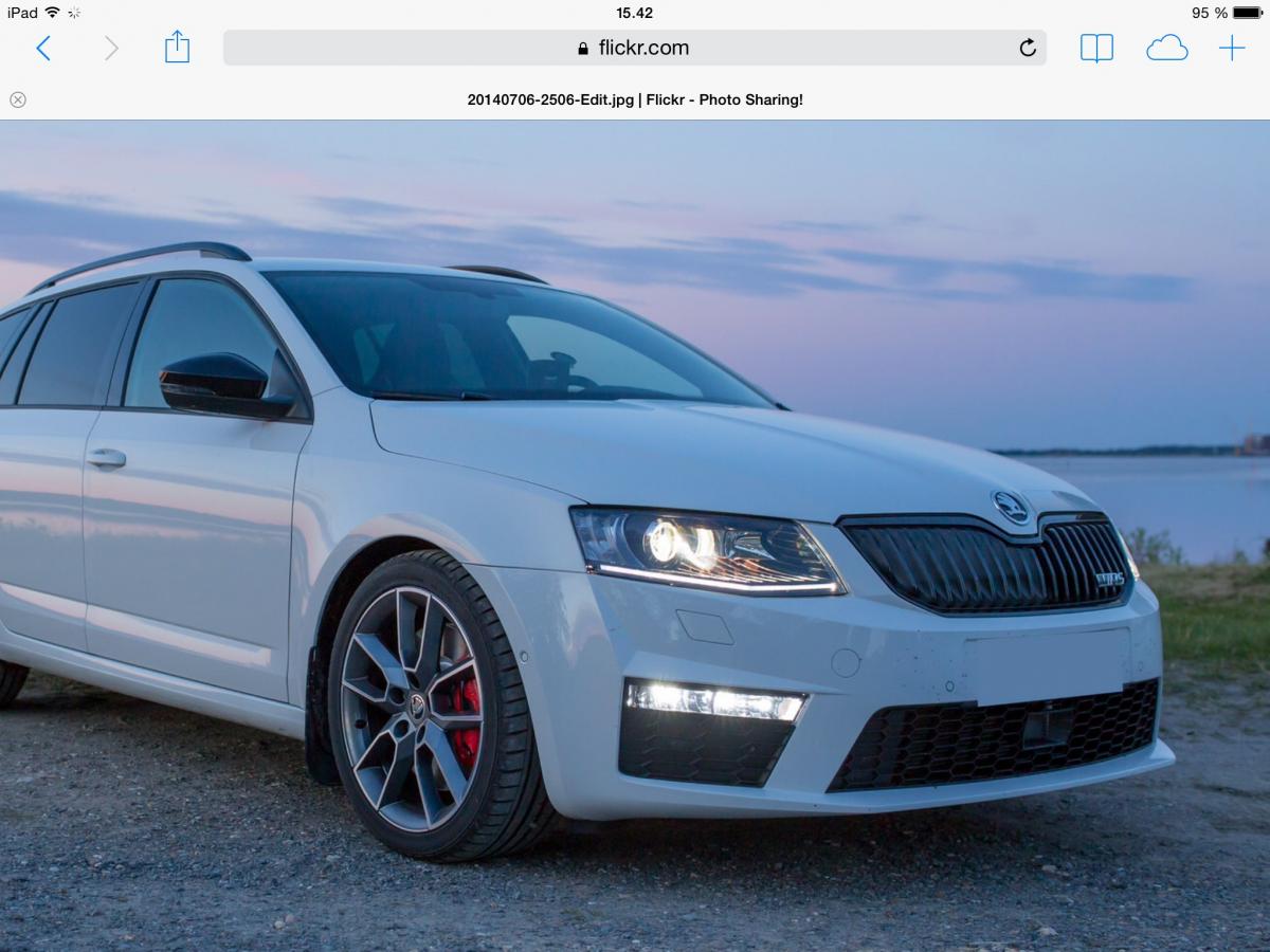

Below is the car with the LEd fogs

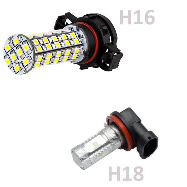

From ready on the forum I got H18 18 LED bulbs x 4 ( cost of £17 a pair)
VIN pointed out that in my O3 vRS bulb in the fog lights are H16.
They have other plugins? How to buy the right one?

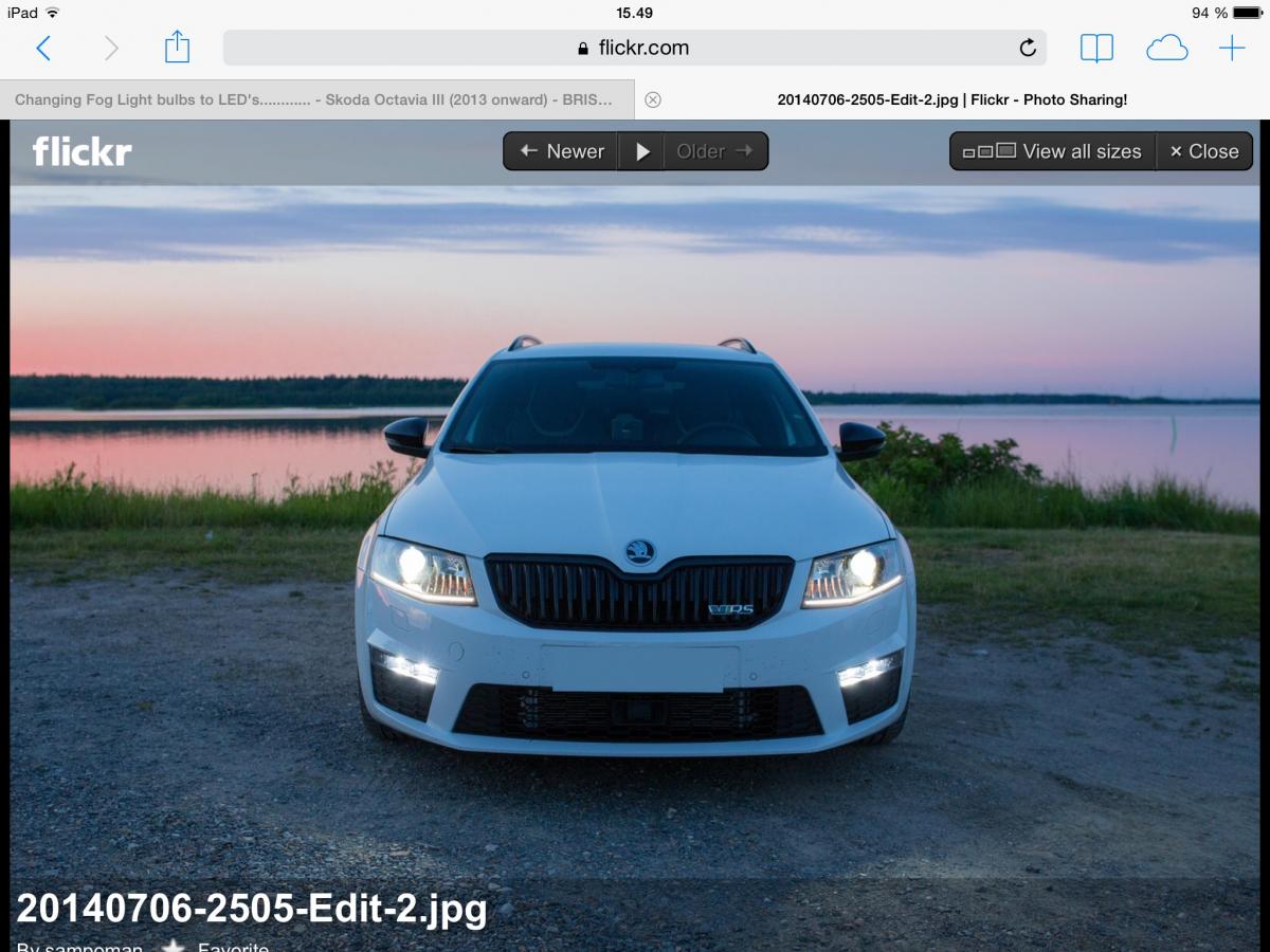

And there is pic of that leds,the car in pic not my..post-101653-0-89162800-1411389921_thumb.jpgpost-101653-0-39169600-1411390200_thumb.jpg
