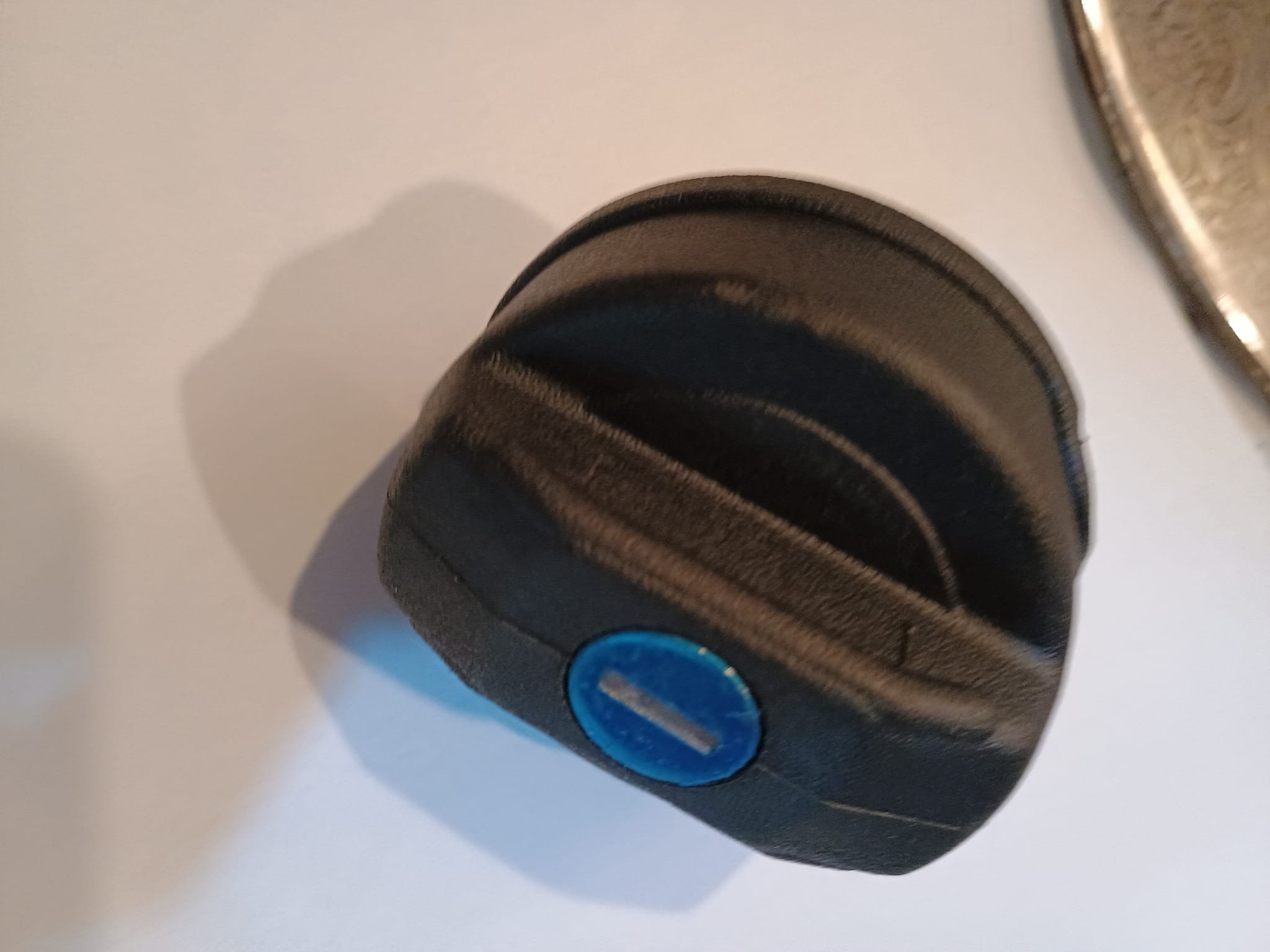

  1. I went with buying a ridiculously expensive genuine one new old stock after some hesitation because ebay said it did not fit. It does fit and the part No 553a is clearly shown on the base. The pattern part I bought before does not fit even though to my eye it looks identical and ebay says it does. Thats all I know.

  3. hm so mine definitely the 553A version, where to get?
  4. further research seems to find 2 part numbers 6U0201553 and 6U0201553A presumably mine is the latter and scarcer?????

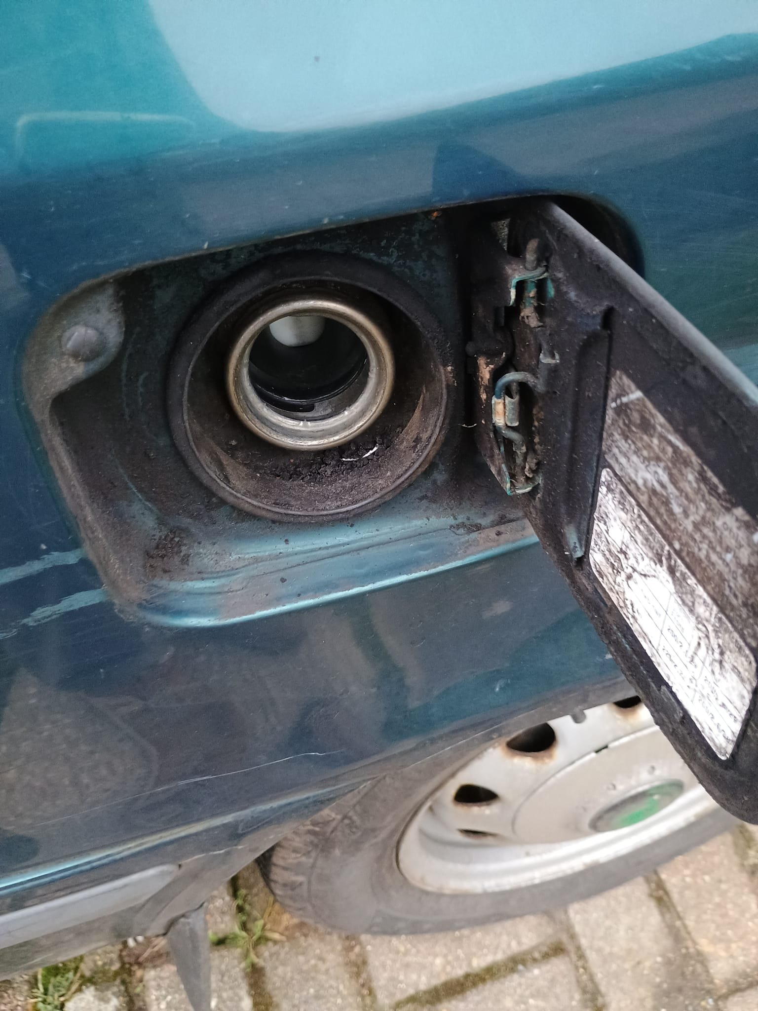

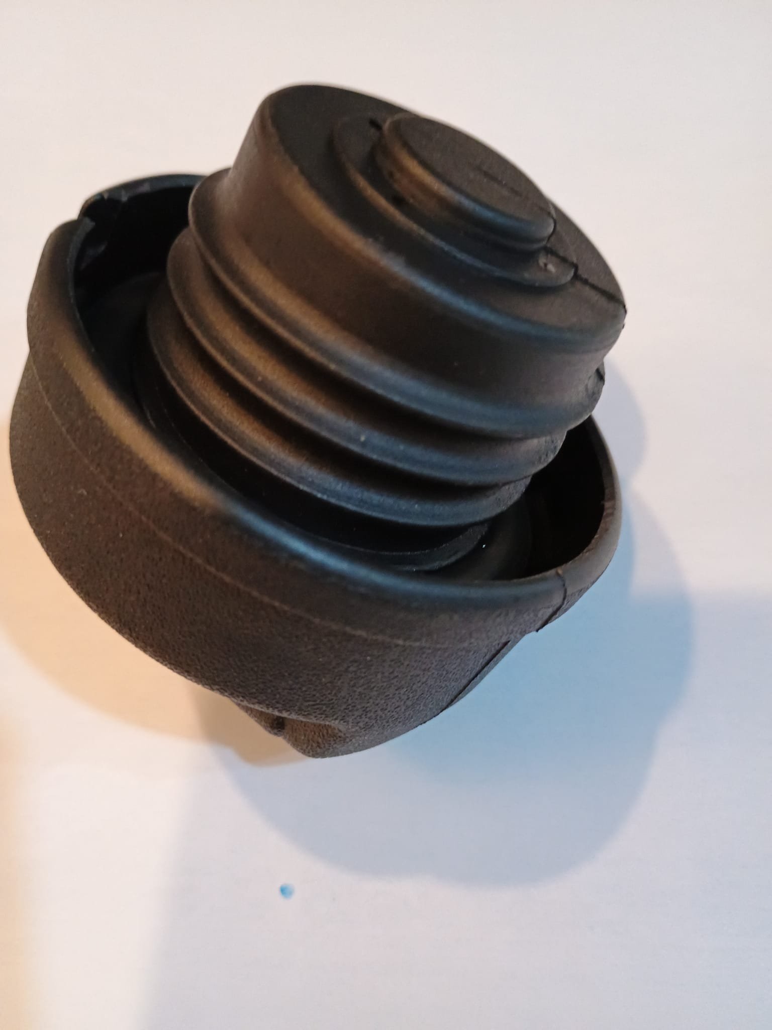

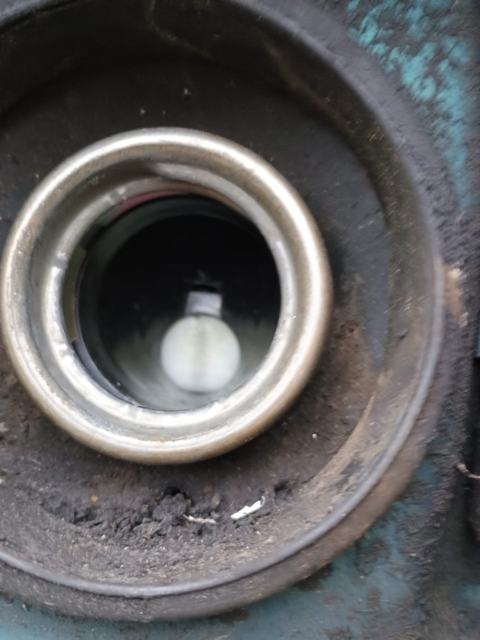

  5. AS title 1.3 estate 1999 Bought this which is supposed to be equivalent but does not fit (wont tighten) Any advice please as to correct one. Attached photos of non fitting unit and the hole it is meant to go in https://www.ebay.co.uk/itm/352042215926 Locking Fuel Tank Cap FOR SKODA Felicia Petrol or Diesel (1994-2001)
