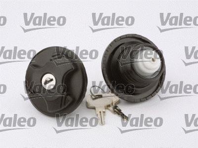

Bought this which is supposed to be equivalent but does not fit (wont tighten) Any advice please as to correct one.
Attached photos of non fitting unit and the hole it is meant to go in

further research seems to find 2 part numbers 6U0201553 and 6U0201553A presumably mine is the latter and scarcer?????
probable

As aftermarket since my factory's cap lock it's damaged I have the Valeo, has small key more convenient (since the factory key won't fit on it).
The difference is only in the key format being used, later models used HAA type keys, earlier models a more traditional type key.
On 01/02/2025 at 19:32, Phoenix_v said:
hm so mine definitely the 553A version, where to get?
I think your best bet is to source one with a key from a breaker / donor vehicle.

I went with buying a ridiculously expensive genuine one new old stock after some hesitation because ebay said it did not fit. It does fit and the part No 553a is clearly shown on the base. The pattern part I bought before does not fit even though to my eye it looks identical and ebay says it does. Thats all I know.
