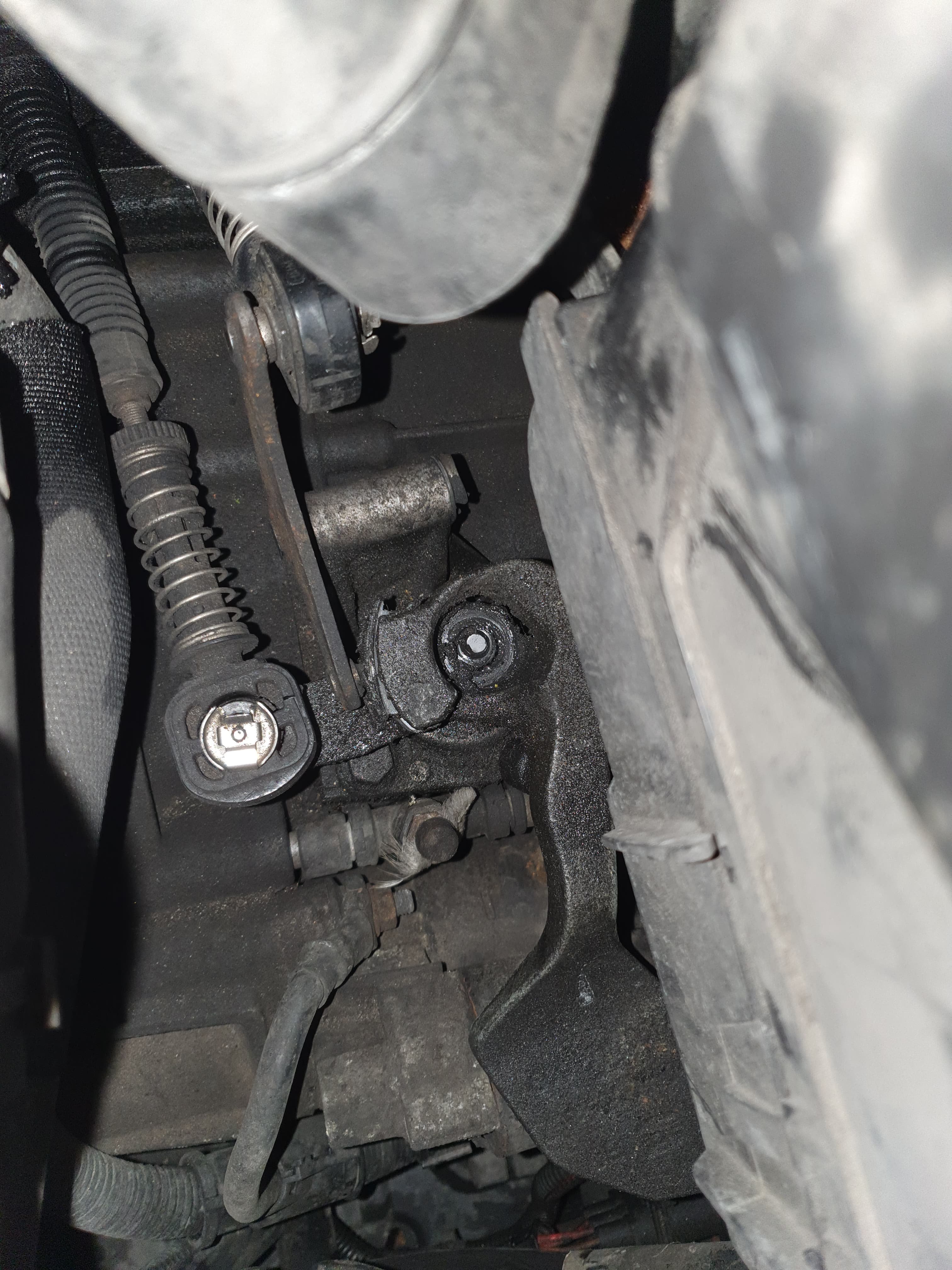

  1. 2 updates : 1. So much easier to remove when that side bolt is removed. And it 16mm 2. All fitted just need to take it for a test drive. the local skoda specialist said it would be a new gearbox. Makes you wonder
  2. Starting to make sense how I snapped the thread isnt it . I'm well 'ard lol

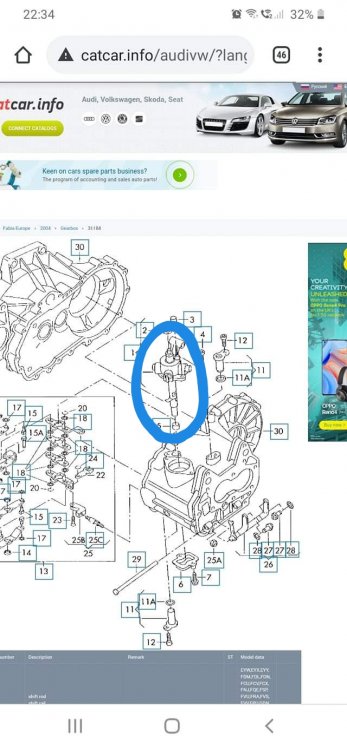

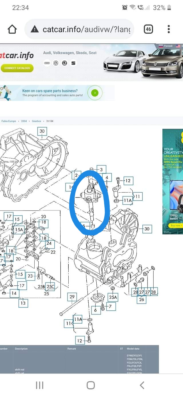

  4. apart from sayin "Gearshift shaft with cover can be installed or removed with the gearbox mounted." it doesnt mention any specifics based on what jars has said hopefullf it will just slot in

  6. sorry it from a 2004 vrs td. thats a bit worrying, i took it out of a car and didnt undo the 17mm on the side. does it just slot in, do the bolts up attatch the linkages and its good to go? its the fitting im more interested in

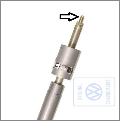

  7. I've managed to get a spare gear selector rod after snapping the thread in mine. Does anyone know how easy it is to fit? It would I be better off letting the garage do it?
  8. Thanks for the reply Do you mean weld the the mechanism onto what's left of the threaded bit?
