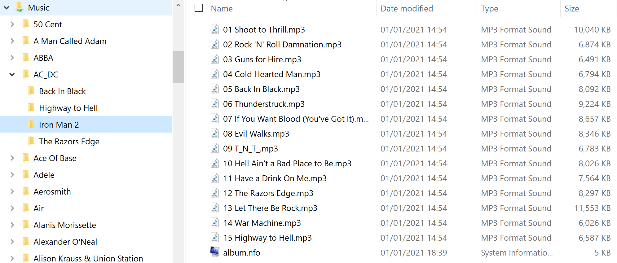

And just to clarify, this is the folder structure (albeit on my server, but this is mirrored to the SD card).....

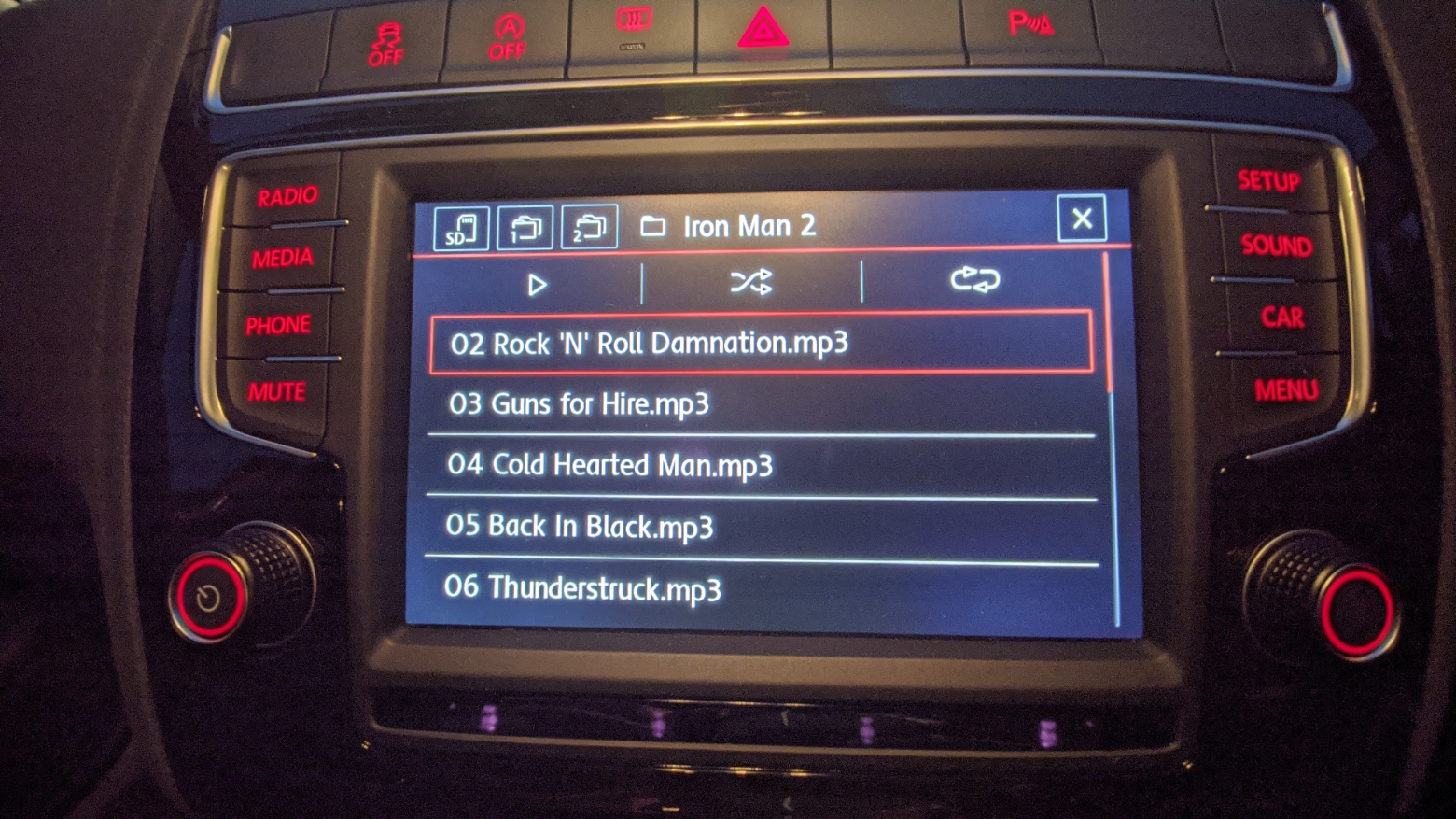

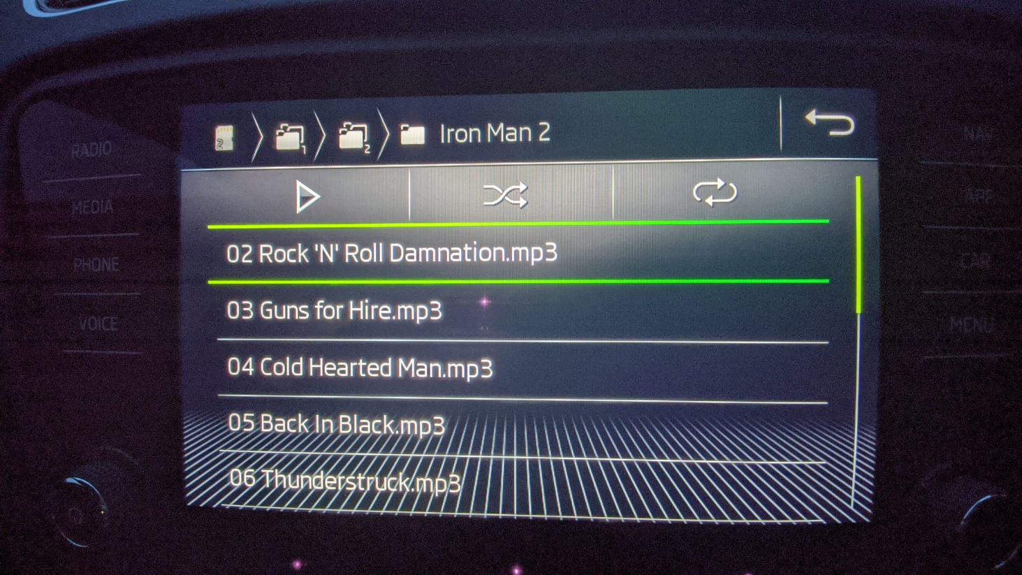

Here we go. Both the Skoda and Polo attached (also showing offending tracks)... Any help from @pab567would be much appreciated.

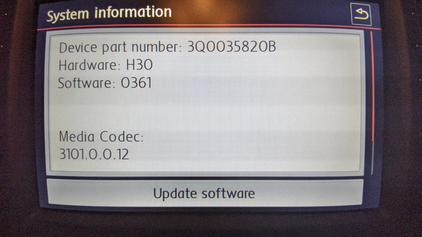

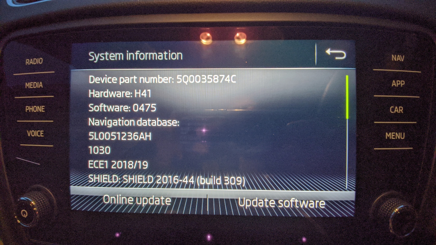

Hi there, No I haven't, can that be done within the menus? Can the software be updated (from home), or does it need to go back to dealers? I'm pretty sure neither have been updated since we have had them (unless its been done silently during services)... Cheers, Mark
