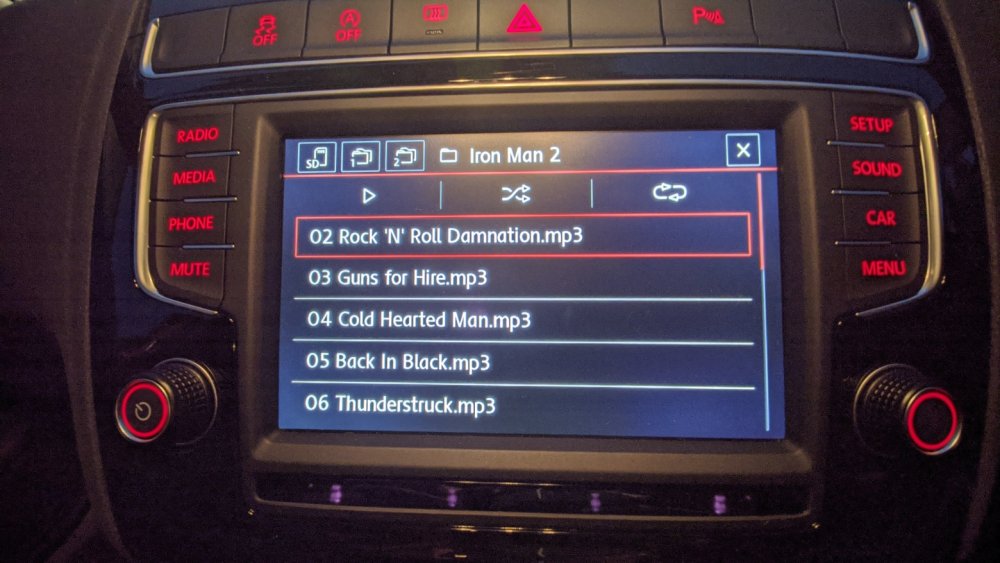

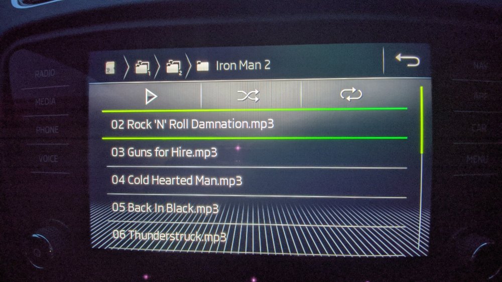

Hi there,
I have both a VW Polo GTI (MY17) and Octavia vRS (MY19) and in both I have an issue with some MP3 files being detected from SD card. Specifically, it is the first track on an album that is not detected (therefore I see from track 2 onwards fine). I thought this was a one off when I had an album do it a long time ago, but now it is happening again. I've tried both SD cards in both cars (with the same music on), and both show track 1 as missing....

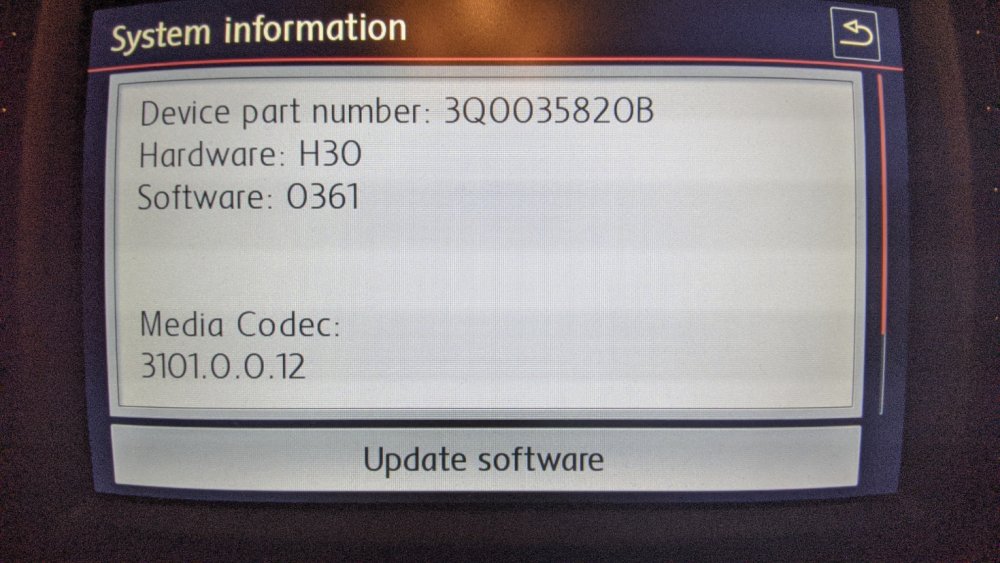

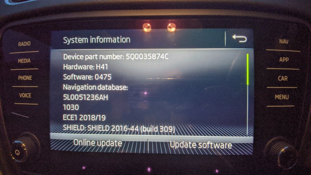

Might be worth taking pictures from the 'system information' screen of your headunit and either dropping @pab567 a PM or add them to this thread:
There will be a fault code stored due to the update but it's trivial to clear with VCDS or similar and completely normal. It won't show on the headunit or effect functionality :)
Edited by langers2k
Here we go. Both the Skoda and Polo attached (also showing offending tracks)...  Any help from @pab567would be much appreciated.

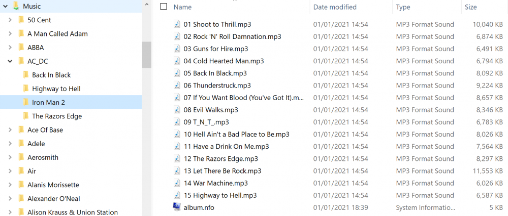

And just to clarify, this is the folder structure (albeit on my server, but this is mirrored to the SD card).....
Our Octavia's have the same headunit but mine is running slightly newer software.
If you can share the files and directory structure, I can chuck them on a spare SD and see if they work for me :)
