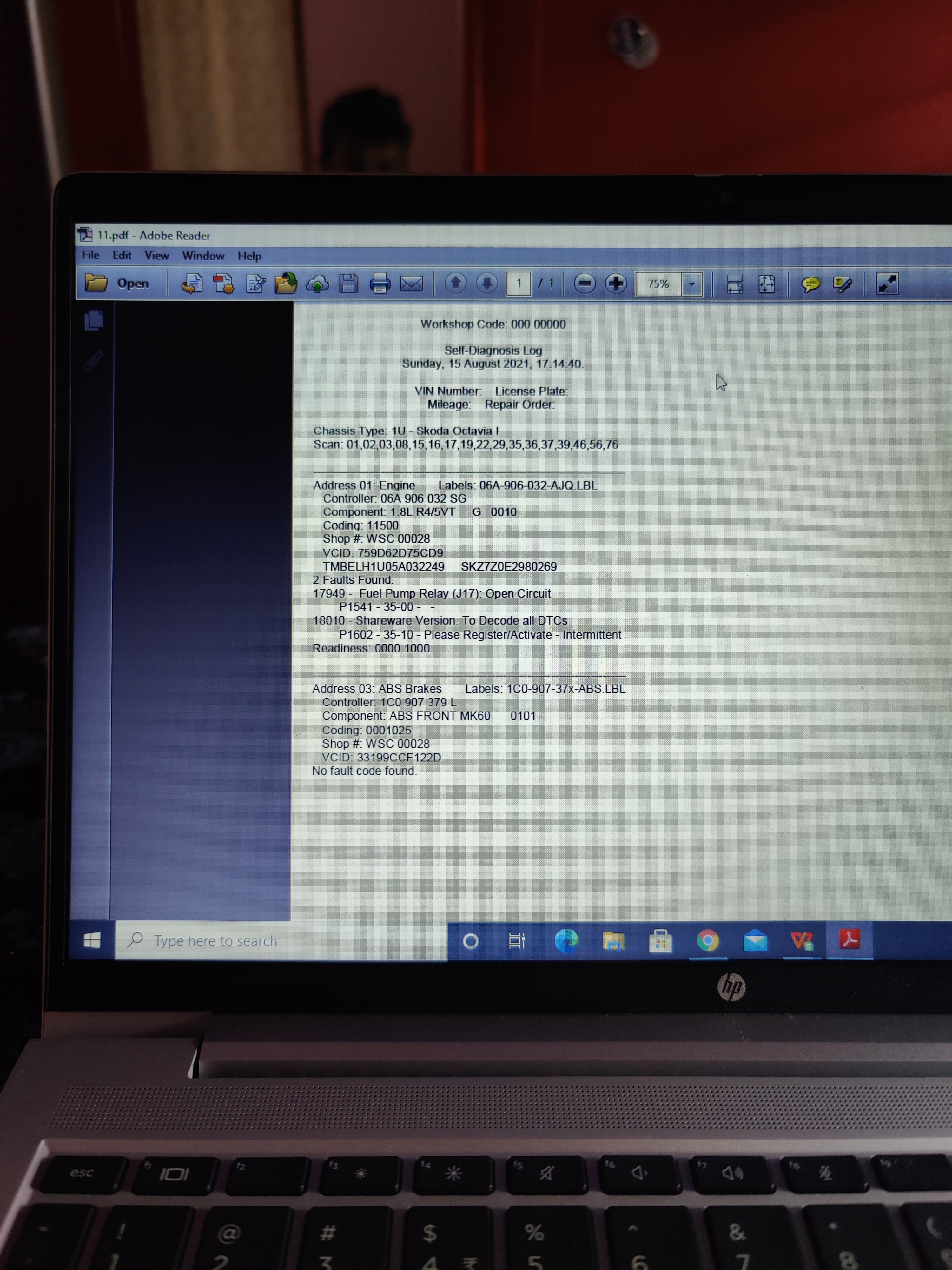

  9. Still chasing this issue, replaced the fuel pump and crank sensor still no change. Even gave the 409 relay a good look. All looks fine. Anything else to look for guys? No code, no lights nothing
  10. My vRs is abruptly stalling once it get to temperature, no misfiring, no jolts, but the engine cuts out suddenly. It will restart in the first or second crank immediately and run for 3-4miles without problems. Mileage also have come down. Changed the fuel pump, brake switch and checked all the hoses the small fuse box on top of the battery etc, All looks fine. Can it be the CKP sensor? Have been riding like this for a couple of days and now the P0130 B1S1 O2 error have come up, which was earlier not there when I sacnned, I think maybe it's due to soot accumulation on the O2 due to poor gas mileage. Any advice guys. Its becoming dangerous to drive this car..
  11. Thanks Dean... i cleaner the battery terminals and the auxiliary supply terminals and drove the car close to 80miles today she was all fine. Will check again for any codes. Fuel pump is most likely to be the culprit for a 100K mile car. Will keep everyone posted.
  12. Had this problem 5 to 6 times yesterday thought I will document it here since this can be a common problem, when slowing down in traffic the car just dies without any warning light on the dash. All the electrical systems like Stereo,AC Blower etc will be working fine at the time. Also when tried to restart the car it will start in the first crank. Some thing to do with Fuel pump, relays etc. Only error code recorded was a P249 which o think is not related..

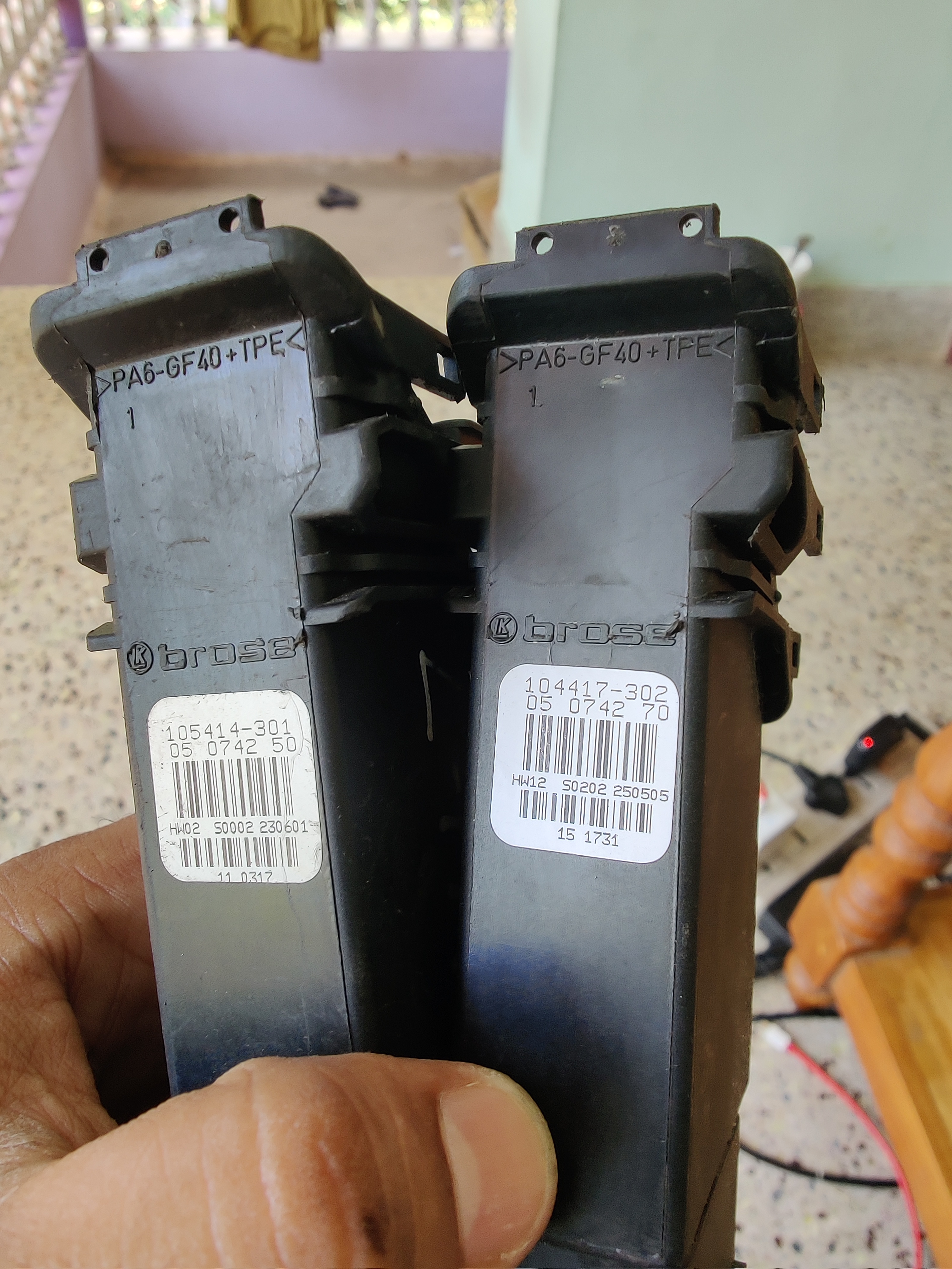

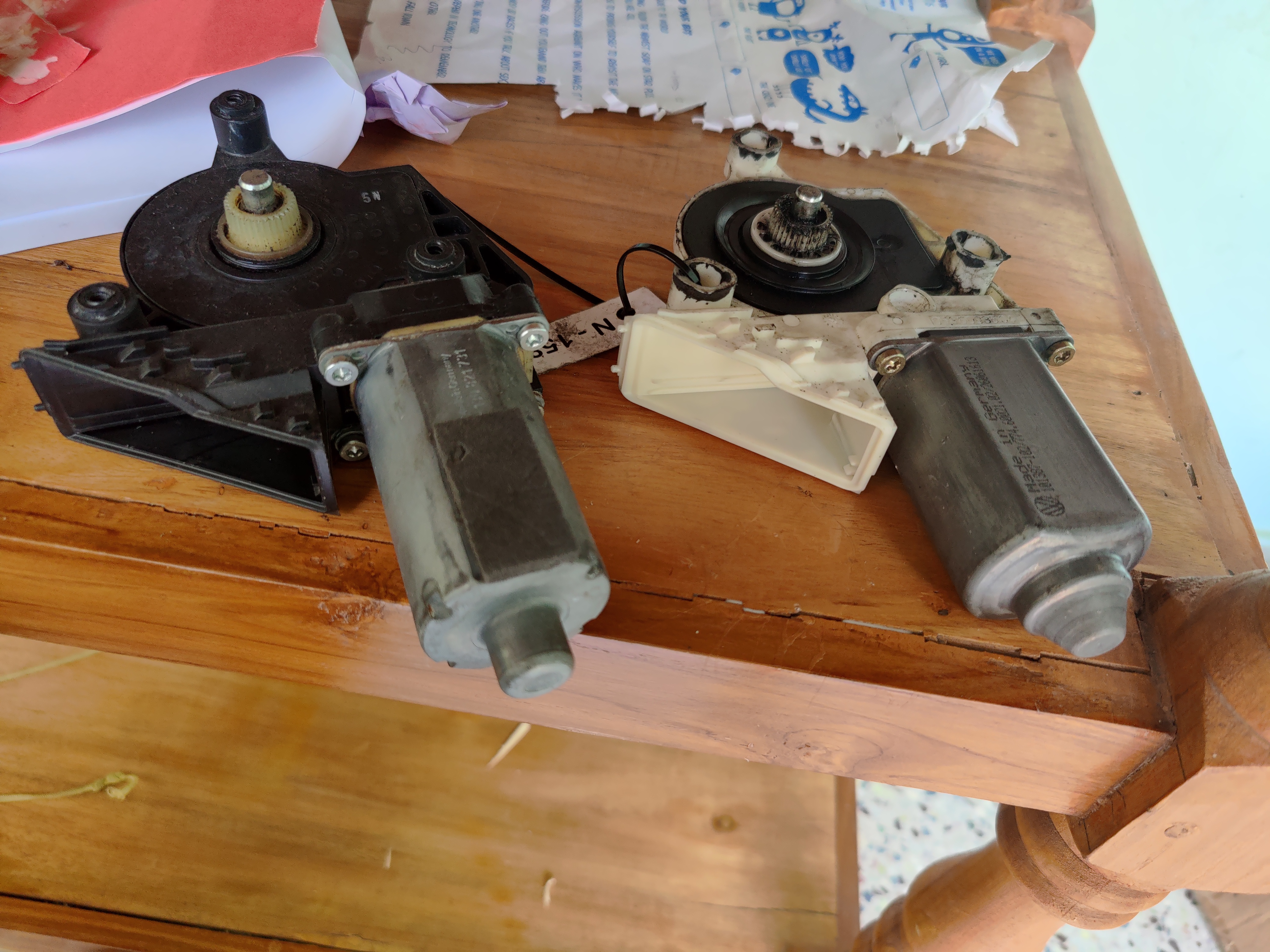

  13. Hi, this is the update after this experiment . Got the unit of a MK4 GTI, asn as discussed eaier the motor is completely different so removed the module and swapped with my old motor. Everything looked like it is working fine and finally installed it. Only problem noted was that when operating the windows when the switch is pressed down the window goes up and vice-versa. So as a solution I swapped the yellow wires of the switch coupler of the passenger side and it works fine now. Didn't bother the fiddle with the switch of driver side as I will be the only one driving the car. If needed the same can be done on the master switch also I think. Hope this information is useful.
  14. No, the motor hardware is different. The control module looks the same.
  15. Any idea on the interchangeablity b/n mk1 and MK4 Golf modules?
