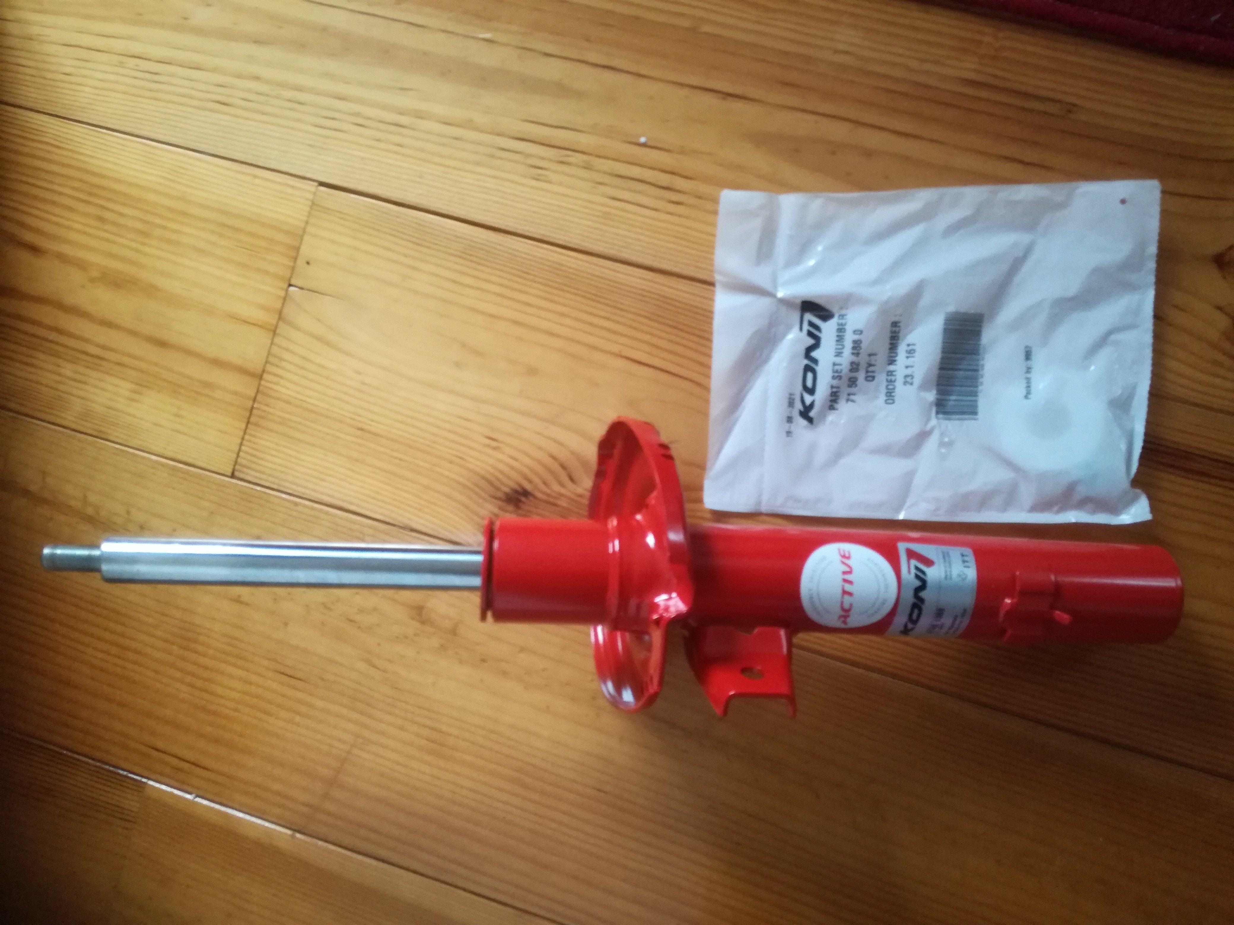

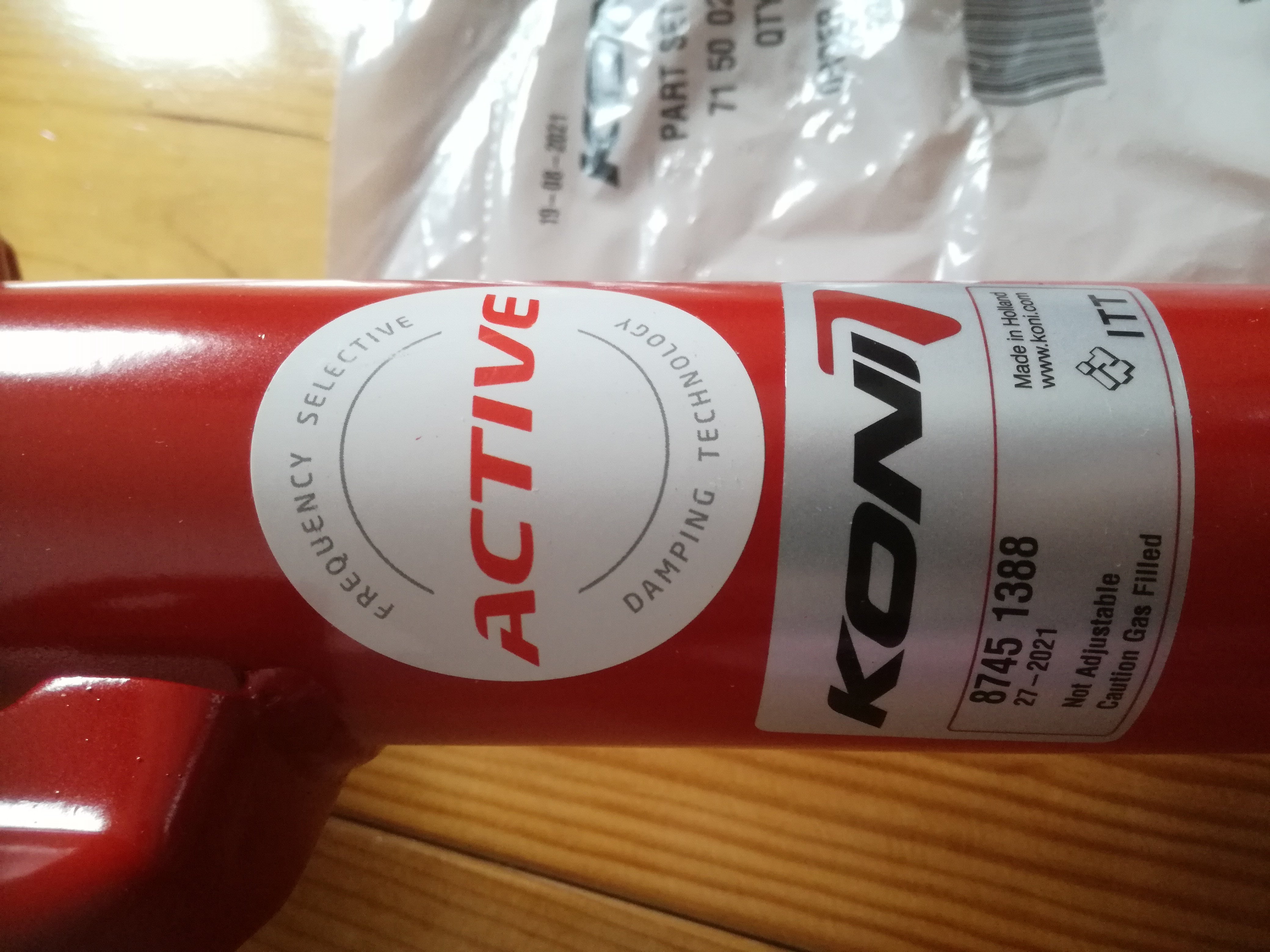

Picture of the shock attached. It appears that it unthreaded itself maybe when the wheel was turning? I did approx. 13.000 km without any issue and then I could hear a noise from the front suspension which got progressively worse. My mechanic also said he fitted new front top mounts/bushings as far as I can recall. Now trying to ascertain if they are the correct part for the car or not. -

Any issues with your suspension? My front passenger side shock decided to unthread itself! I ordered from Autodoc as well and I am going through the warranty procedure. They came back with the response below: "Unfortunately, the part 8745-1388 KONI from order No. 66464866 is not compatible with your vehicle. This could be grounds for the manufacturer to refuse warranty service." I have a fwd 2016 2.0tdi 190bhp combi and all appeared to match when I ordered. Did I get it wrong, I thought others with 2wd and same car had used these? Thanks -
