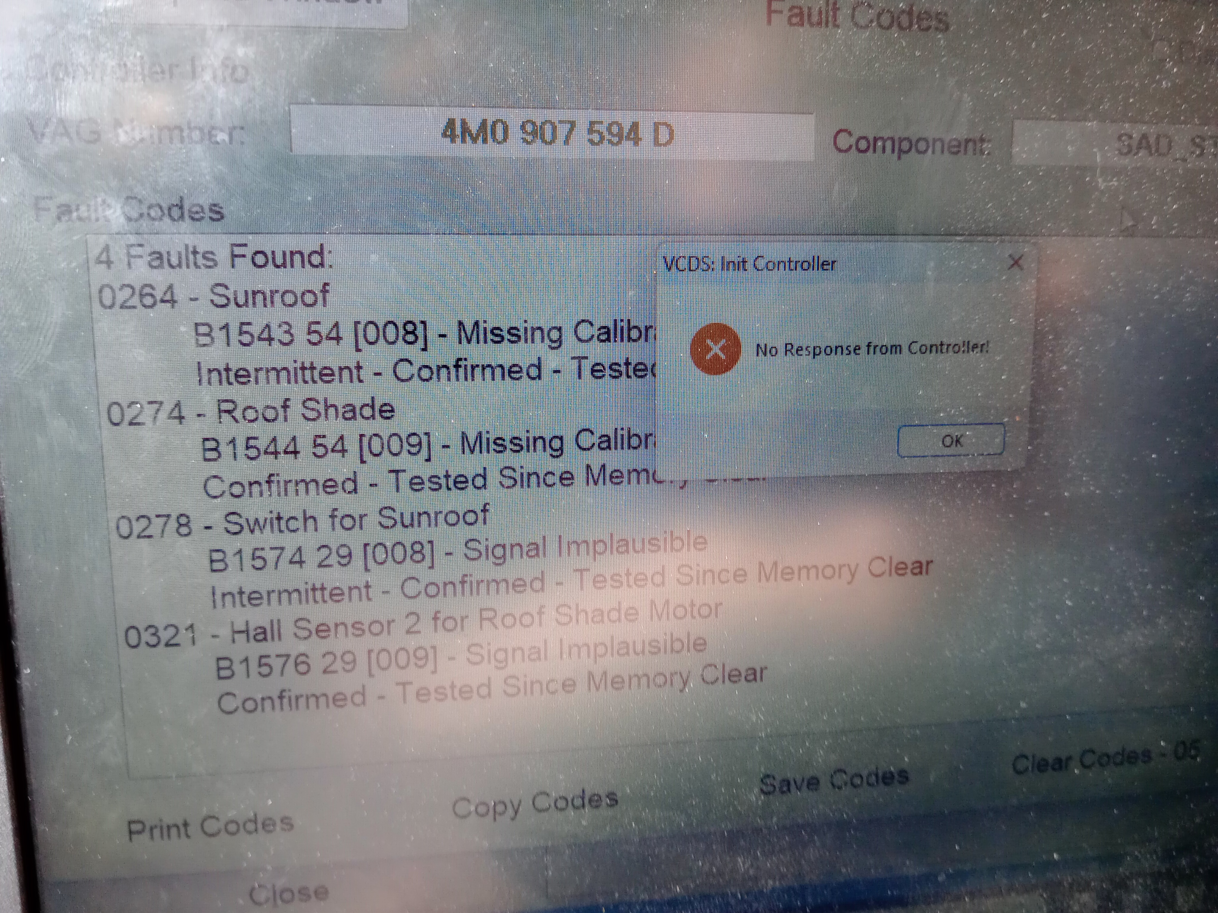

Just to update this it looks like the codes didn't clear as they are still there. I had it scanned using VCDS and the picture is below. The codes need to be cleared in order to do the basic settings so that's not an option. I need to locate one of the motors to see if I can follow the procedure below (Audi Technical Service Bulletin): If this adaptation procedure is not successful, gain access to either the sunroof motor V1 or to the sunroof sunshade motor V260. Using an Allen wrench de-couple the motor and depending on the sunroof panel or sunshade position manually turn the motor approximately ¼ turn in a free direction (e.g. open if component is closed, closed if component is open) then ¼ back. Neither the sunroof motor nor the sunroof sunshade motor (Figure 3) need to be removed for this step. In many cases this will reestablish the hall sensor orientation and the adaptation will then run. Try to run the adaptation procedure again.

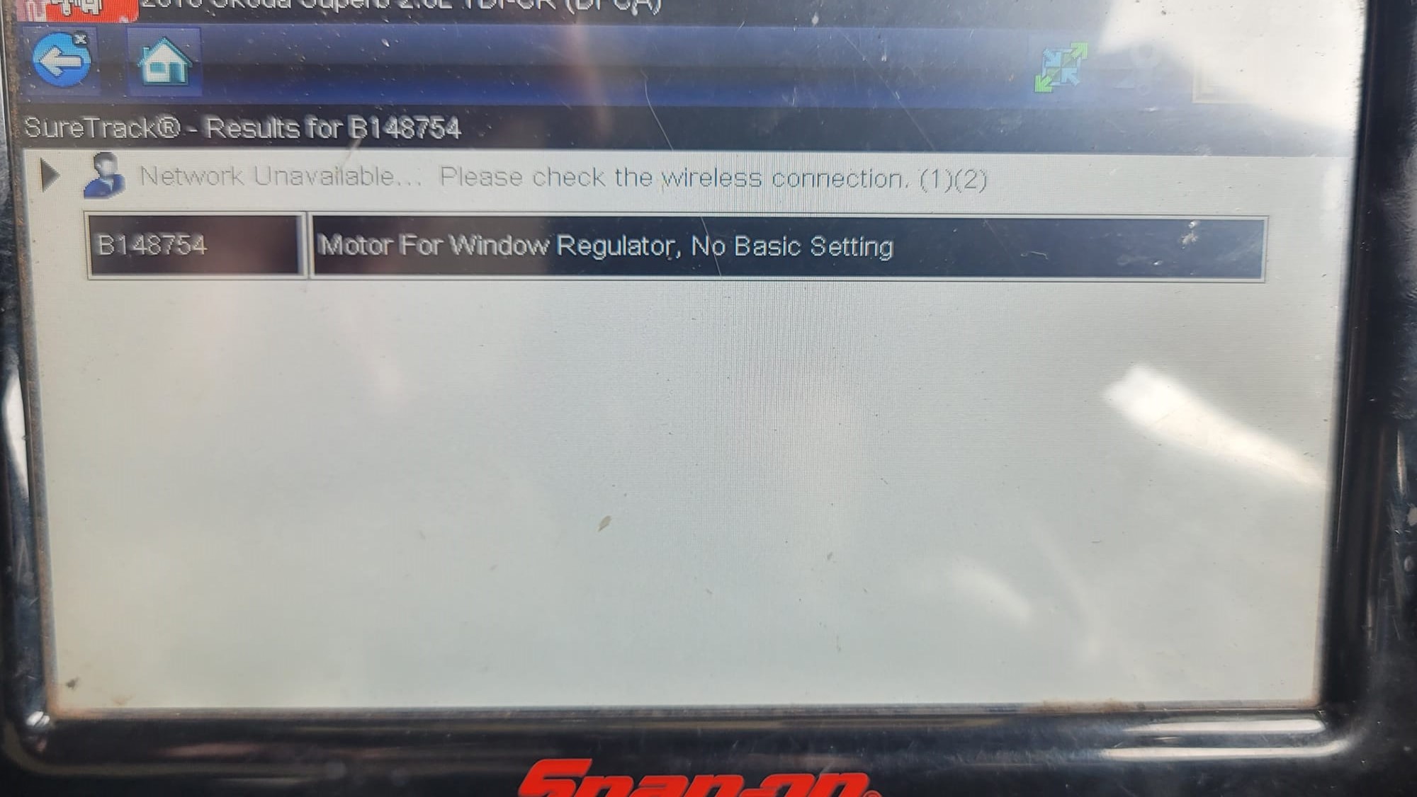

Thanks for the reply. I have tried the reset on the windows but it didn't make any difference. It is strange though that the key fob will open but not close the drivers window (when set to drivers window only). Re the sun blind codes I believe they were cleared but I'll check with the garage and get them to run the basic settings with the scanner as you suggested.

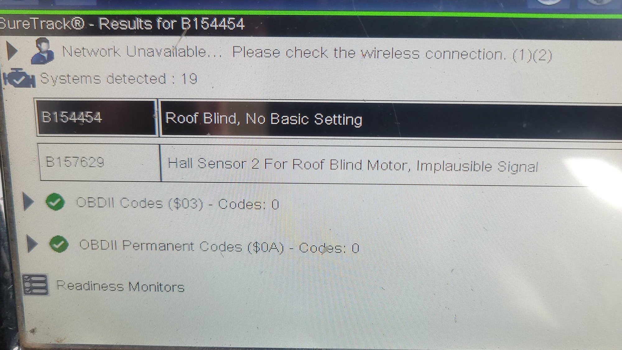

Has anyone had a similar issue? My sunshade wont open and neither will my sunroof. I have tried the procedure below. When I hold the sunroof button I can hear a noise after the 7 seconds or so but it doesn't open. The sunshade procedure doesn't do anything but there is a noise (like something activating) every time I press the button to close position. I have attached a picture of the error codes. Also my window open/close key fob function has decided to stop working. It doesn't work when set to all 4 windows but it will open the drivers window when set to drivers side only (but not close it). I have tried the reset procedure here as well. Maybe both issues are related? Any guidance would be much appreciated. ve tr

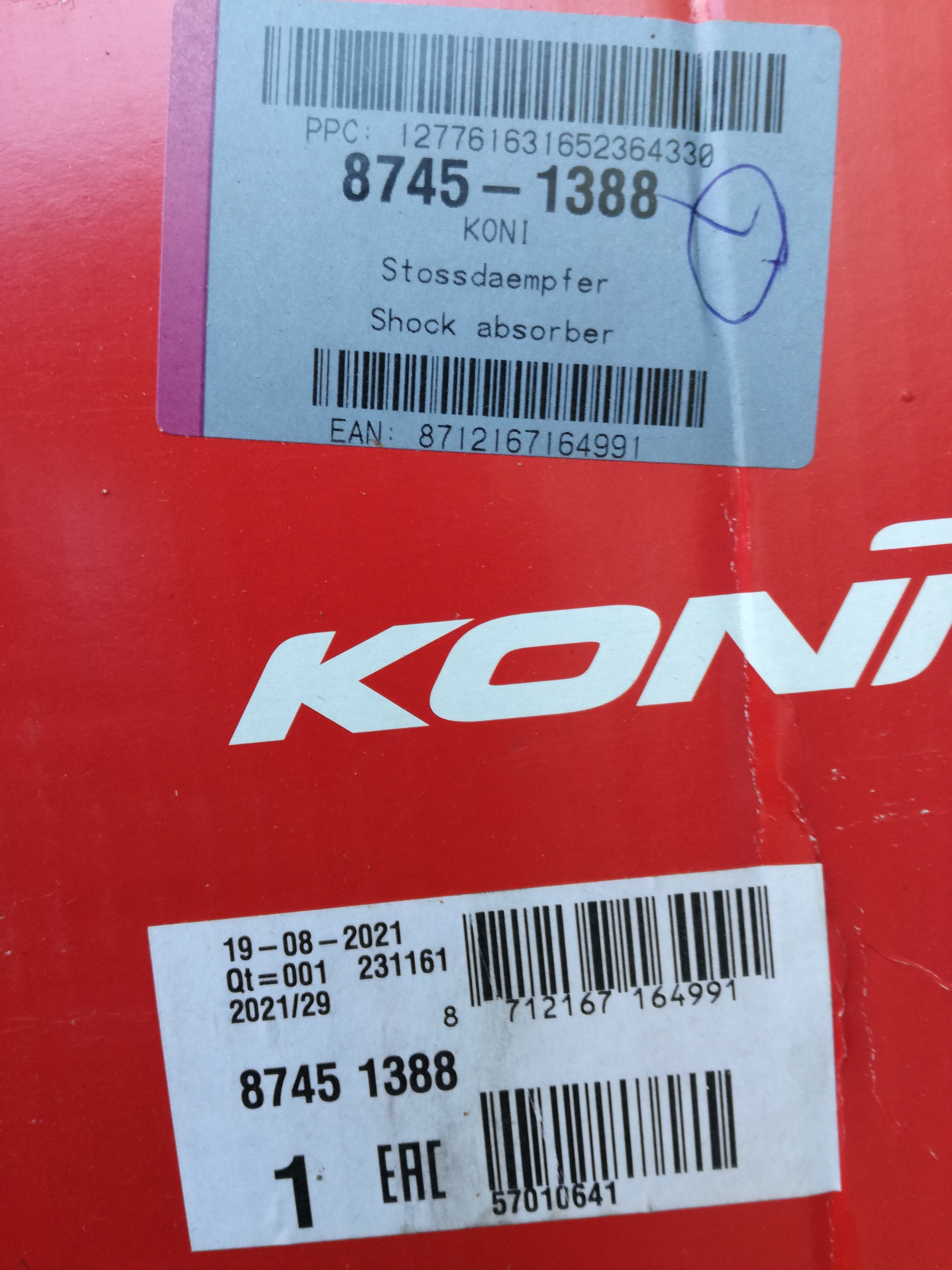

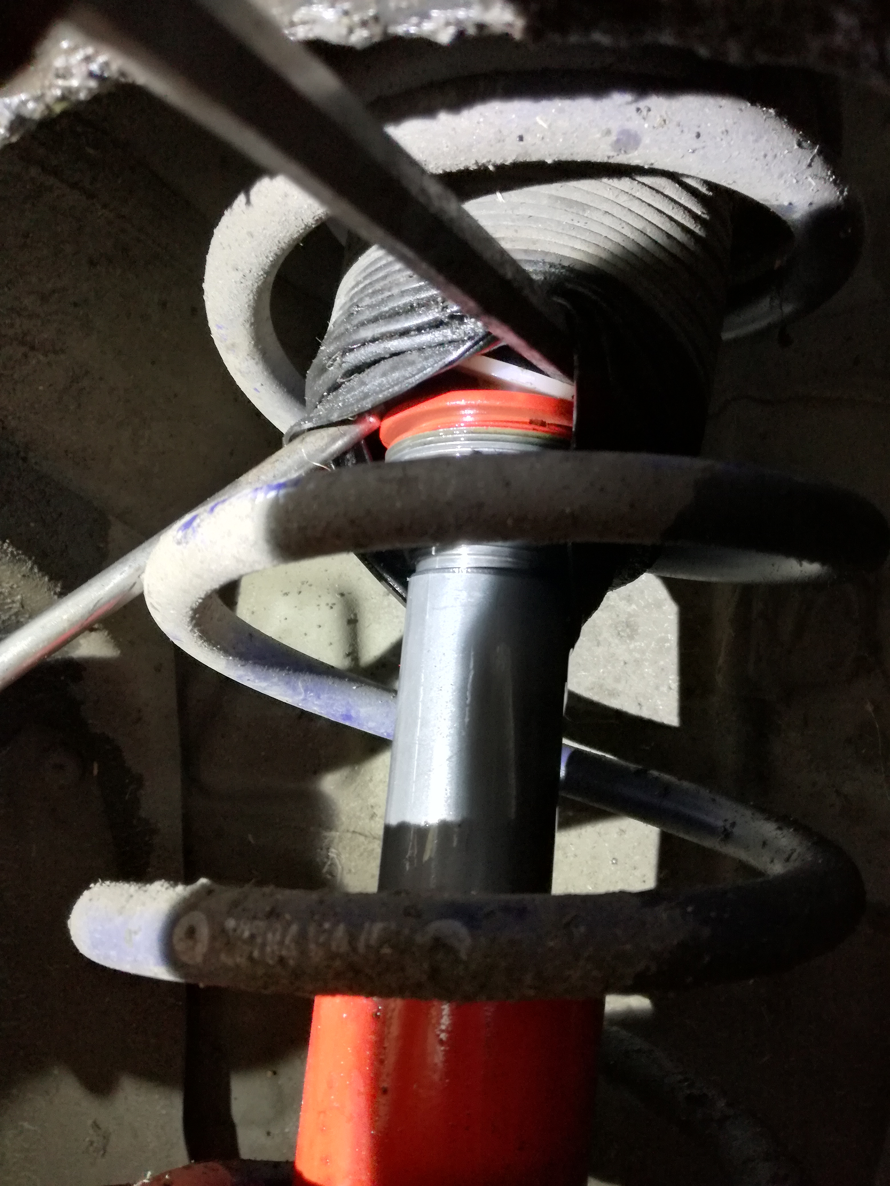

Picture of the shock attached. It appears that it unthreaded itself maybe when the wheel was turning? I did approx. 13.000 km without any issue and then I could hear a noise from the front suspension which got progressively worse. My mechanic also said he fitted new front top mounts/bushings as far as I can recall. Now trying to ascertain if they are the correct part for the car or not.
Koni Special Actives: Front Only or All 4
Any issues with your suspension? My front passenger side shock decided to unthread itself! I ordered from Autodoc as well and I am going through the warranty procedure. They came back with the response below: "Unfortunately, the part 8745-1388 KONI from order No. 66464866 is not compatible with your vehicle. This could be grounds for the manufacturer to refuse warranty service." I have a fwd 2016 2.0tdi 190bhp combi and all appeared to match when I ordered. Did I get it wrong, I thought others with 2wd and same car had used these? Thanks
