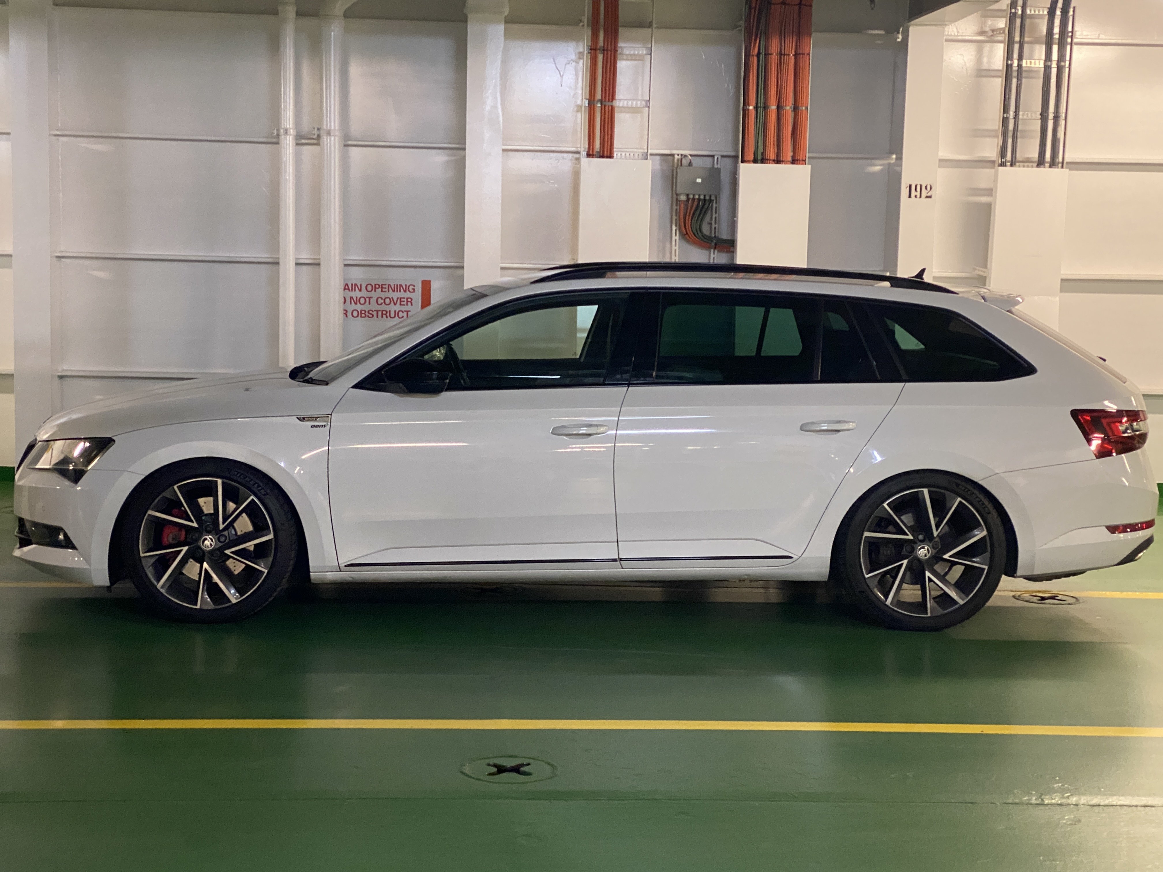

Can confirm they work amazingly with H&R springs but that will lower the ride. Very nice shocks 👍🏻
Looks great, a bit lower than I would like it. I think max 20mm for me, if I was going to change the springs.
Just what I need to remove excess height from the PPD
