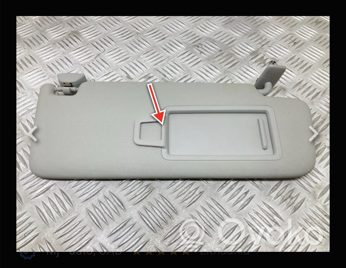

  2. Found another number on the moulding - 5G0 857 516 - but can’t find associated with that number. Went to the main dealer… they said it’s not on their database and the only thing they can suggest is replacing the visor - for £240! I will get one from a breaker. Jokers.
  3. The only ‘code’ I could see on the moulding was 815 451 which doesn’t come up with anything when I search. I fear it’s a component of the whole visor which does have a part number. Maybe I need to talk to the main dealer.
  4. Hi, I had stupidly put my driving licence behind the vanity mirror shutter, where it promptly disappeared into the sun visor like a bad conjuring trick. I have retrieved it but unfortunately destroyed the mirror bezel trying to prize it off. Is there a part number for this piece of trim?

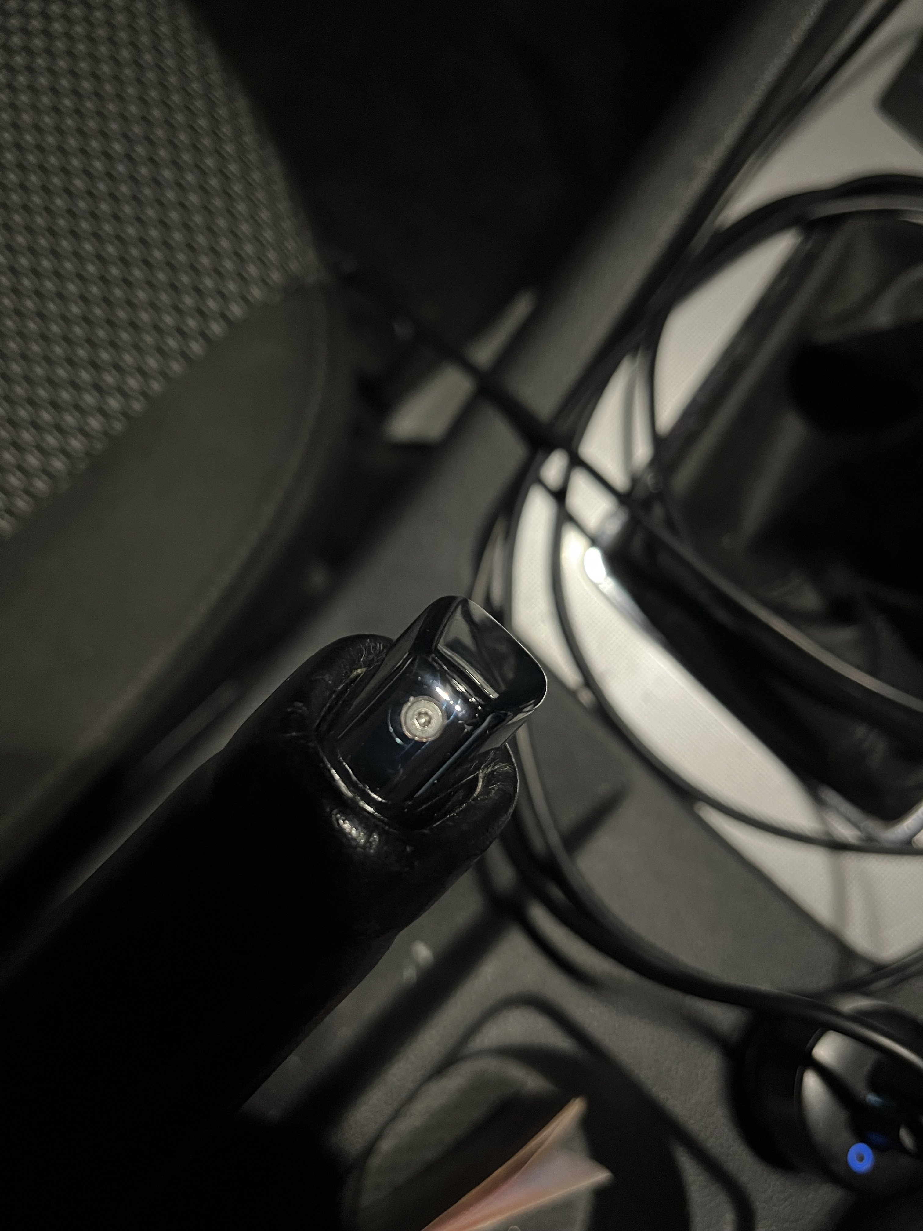

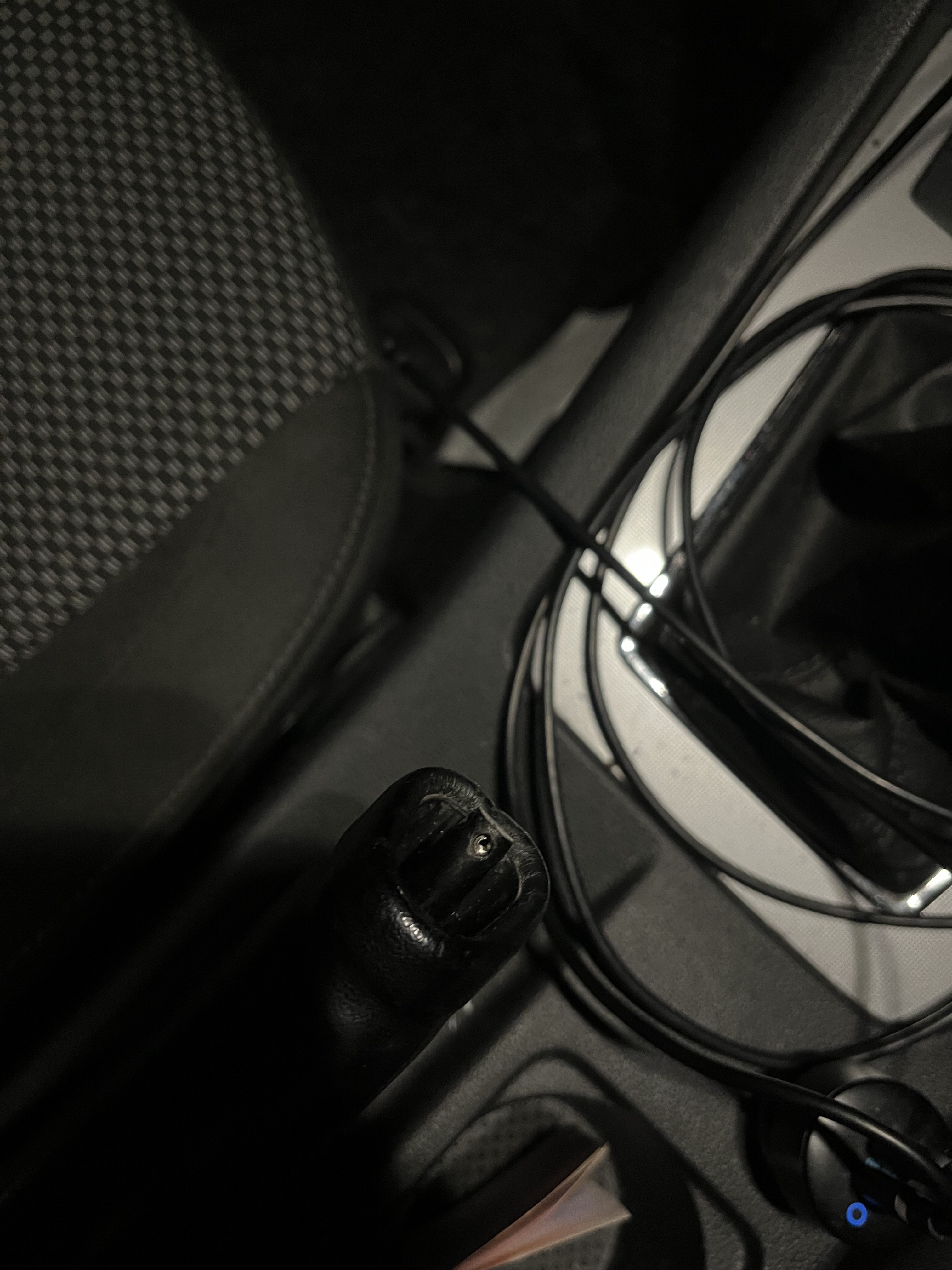

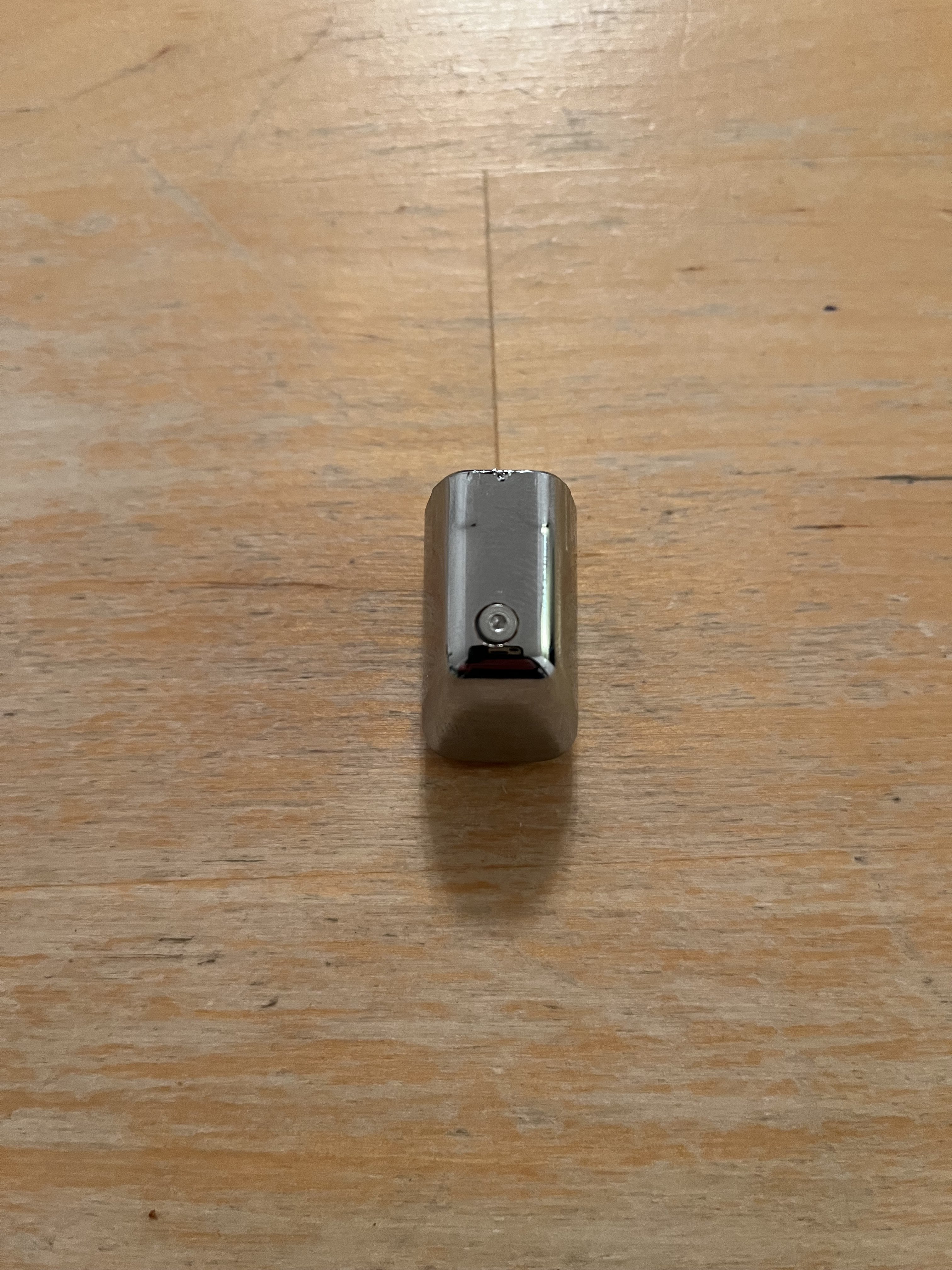

  5. This happened to me and worse, the plastic clip (underneath the black plastic rod) snapped off, so I decided on a different approach. Bought 16mm M2 csk stainless machine screws (though 10mm would be plenty). I drilled and countersunk the silver button (2.5mm drill plus countersink bit). I also bought M2 nut inserts - these were harder to find and I eventually tracked some down on Ali Express. I then drilled the black plastic rod (3.2mm drill or 3mm drill if you wiggle it a bit). You can still apply the handbrake by lifting the handle and pulling out the rod at the same time. This holds it still, so it's easier to drill. Apply the nut insert underneath the rod (this is fiddly and you may loose one or two before you can squeeze it home with some pliers) Then apply the spring and the button and carefully screw the csk screw. You may need a tiny hex screwdriver too. The button - with M2 screw: The rod, with nut insert fitted: The re-assembled hand-brake: The nut inserts:

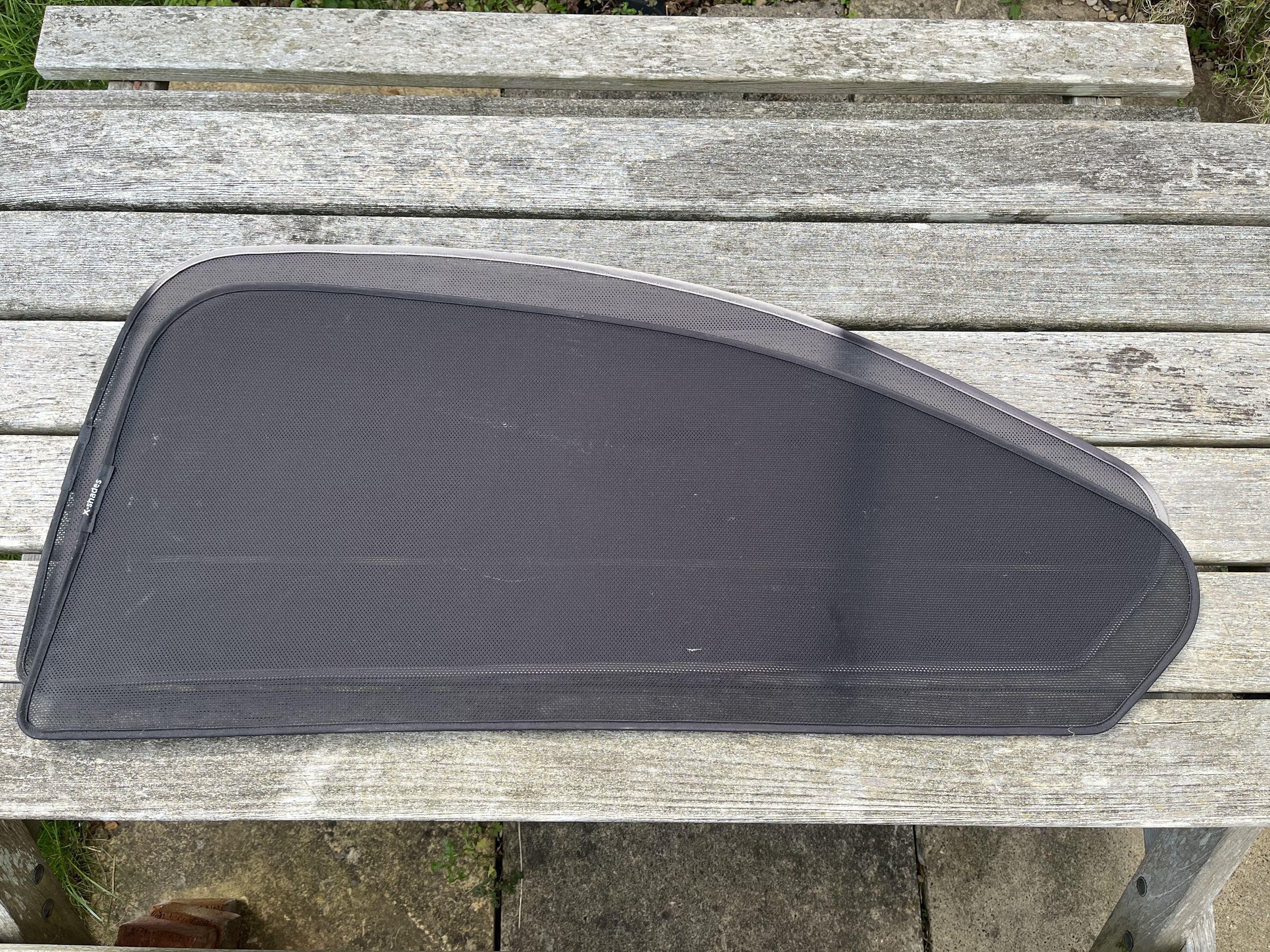

  6. I hope I’m allowed to do this (since it’s a giveaway rather than selling) but does anyone want rear window shades for a hatchback. A little sun-faded but otherwise fine. Oxford.
