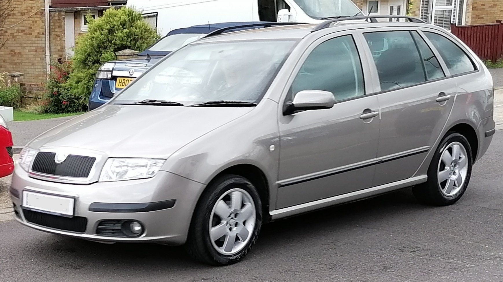

  1. 2007 Fabia Bohemia 1.4 Tdi. Getting a few issues sorted at moment, but it's slowly getting back to normal.

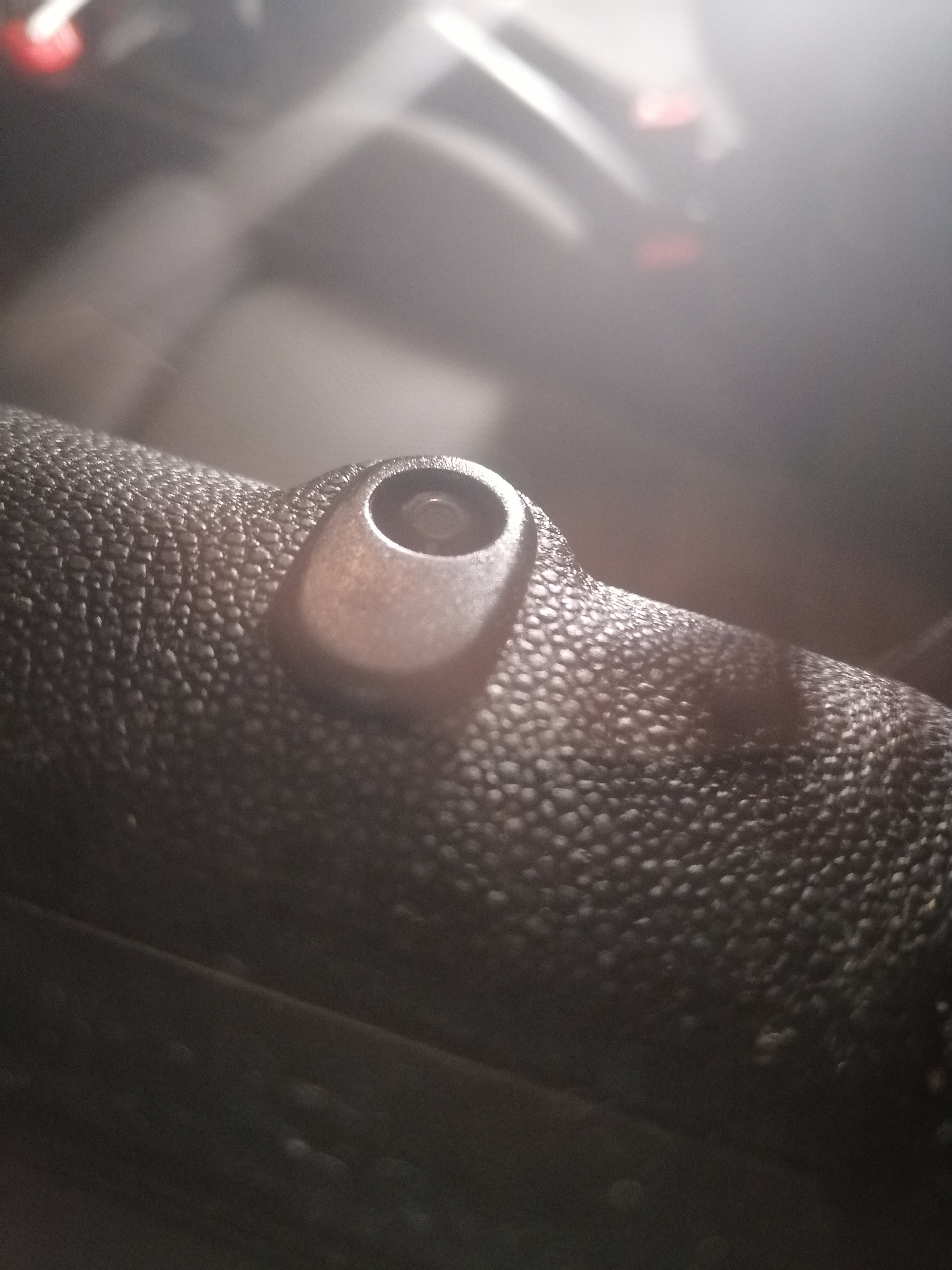

  8. 2007 Skoda Fabia Bohemia Hi all, suffering from a series of electrical gremlins that need exorcism, after I fitted a new window motor. Here is the list. Windows only open if car is unlocked via key not fob. Passenger window opens from passenger side but not drivers side. Door lock buttons on drivers side work intermittently (have to press reasonably hard). I assume I'll probably need a new drivers side switch unit. I noticed the drivers side brake light was out too. Would this have any affect on the other issues I'm having. Car has more issues than the periodicals section of a library.
