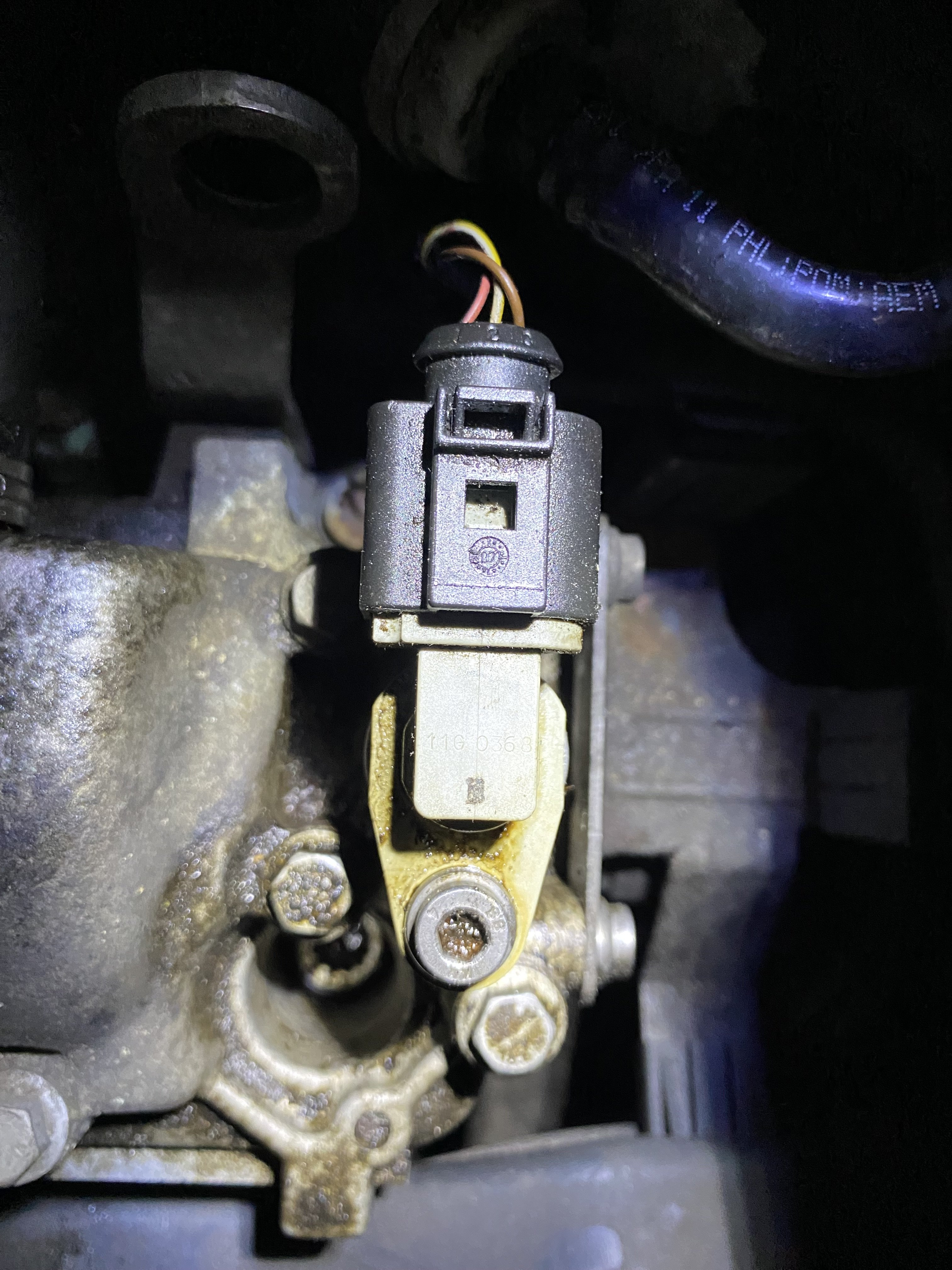

Hi all, I am trying to figure out what this part is, I found a parts drawing which states it’s as impulse sender and when searching impulse sender it comes up camshaft sensor. Part number is 11G0368. Car is 60hp 1.2 htp. Also assume this is source of oil leak. Thanks

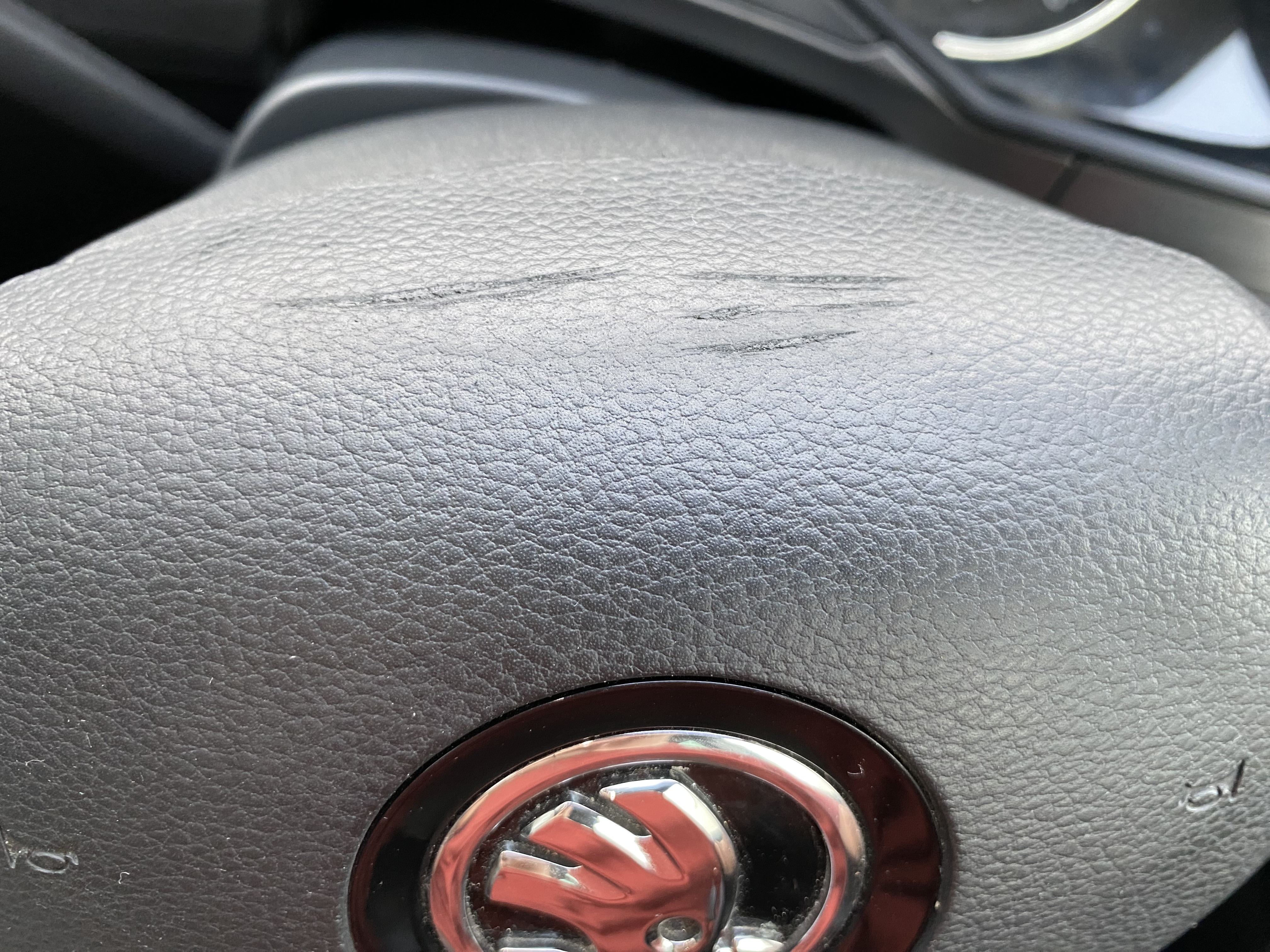

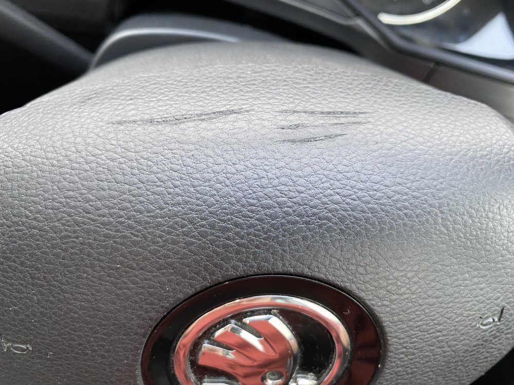

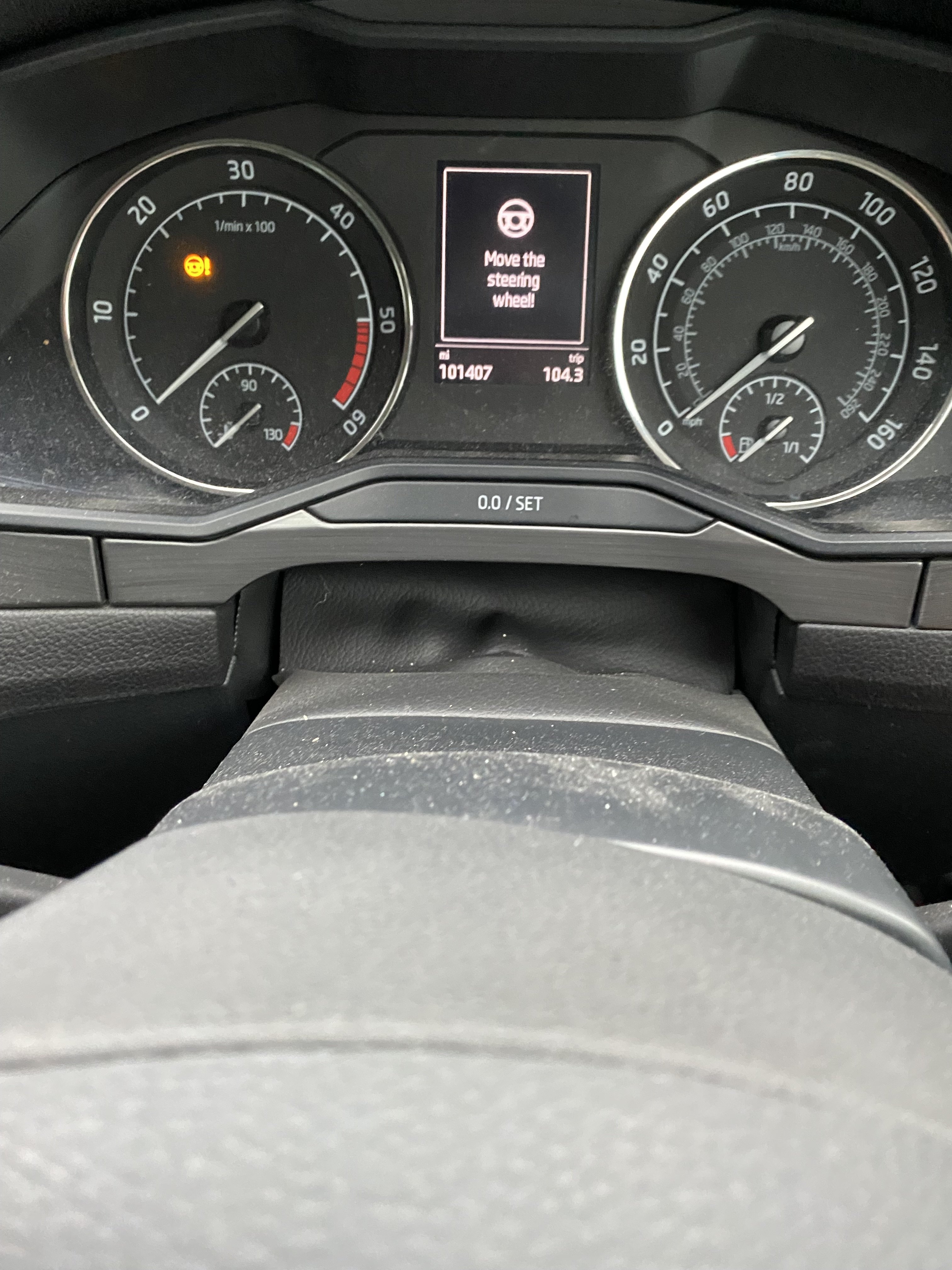

To update you all and for others in future. After a painful recovery and ten days later the car is finally fixed and back with me. The issue was the steering control module, part number S3Q0905861B £500 for the total bill including parts and 2.5 hours labour. Only downside is I now have a nasty scratch on the airbag from either Skoda or Recovery truck… Thanks for all the help!

Thanks Aperture! Sounds like a trip to the local dealers then, any idea what damage I’m looking at?

Thanks Aperture, for what it’s worth the wheel turns completely, how would I go about checking or removing the steering lock pin?

Hi all, wonder if your knowledgable folk can help! Went to start car this morning at the screen flashed up with “ Move Steering Wheel” and wouldn’t start. Tried turning the steering wheel in both directions, tried adjusting the rake of the steering, locking unlocking etc but nothing. Rang the nearest skoda dealer to be told to ring AA/RAC. Not currently got at home cover so looking to this, but any ideas where to start or if anyone has come across this before? The car drove absolutely fine yesterday. It’s a 2016 2.0 TDI superb. Thanks in advance.
