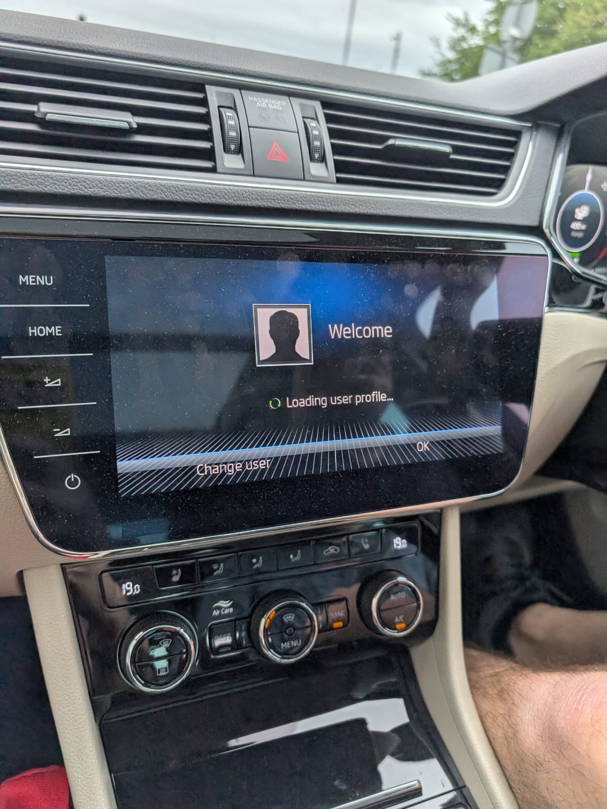

  13. Hi all, I spent the morning driving from Liverpool to Oxfordshire with my family in the back with the car getting stuck trying to load a user profile for 2 hrs of the journey... Picture attached. It was incredibly annoying as we couldn't use the radio/nav/any other entertainment... Thankfully we stopped for lunch and after that the car seemed to jump out of its loop and I could use it as designed... Has anyone else had this with user profiles? Does it happen once you have managed to set a primary user? It seemed to be an issue with the guest user... I currently don't have a user account set as I have been having issues with becoming the primary user and lots of factory resets have become a bit boring...
