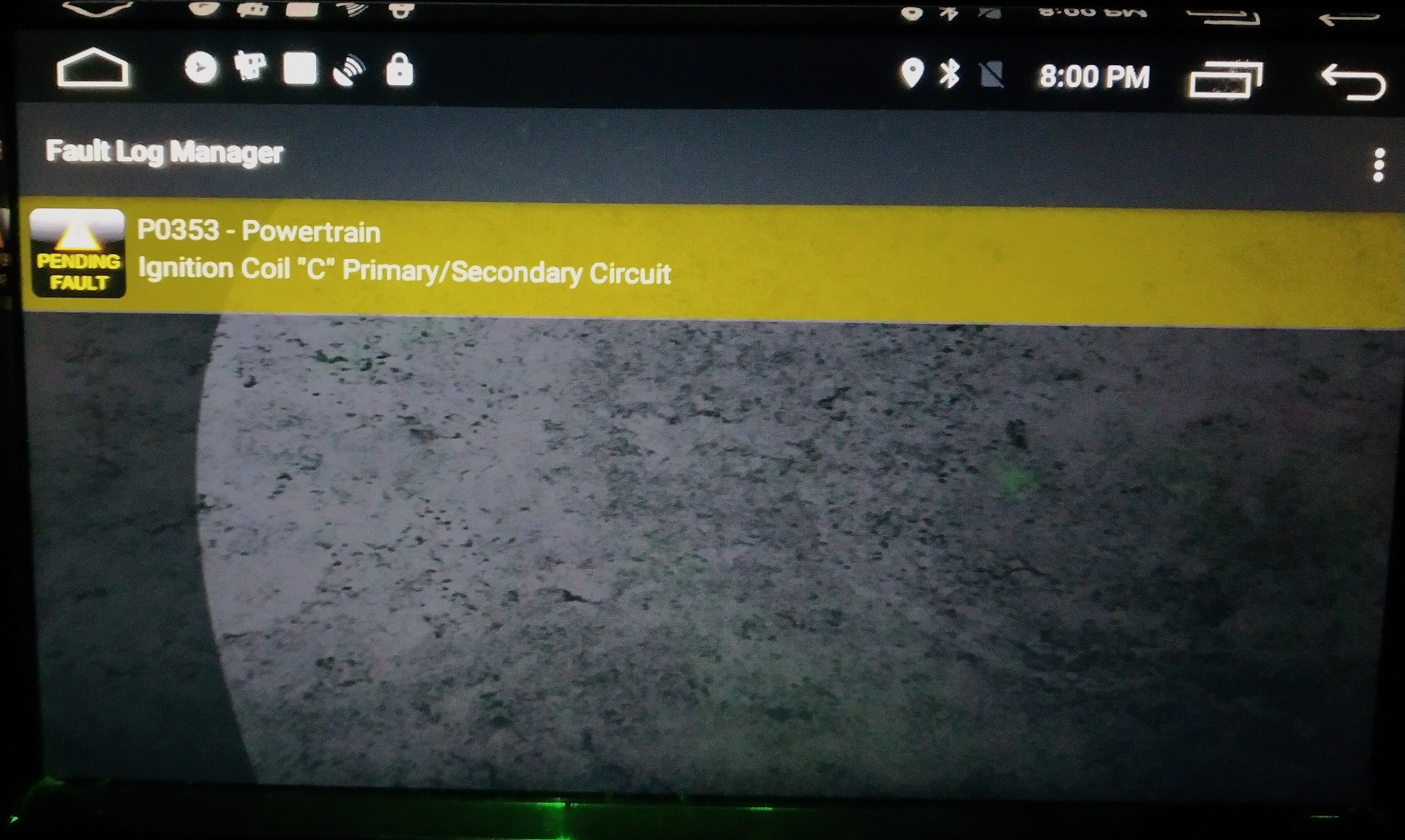

The tuning garage found damaged wiring & broken plug part that connects to the coilpack so it's sorted now, it was strange how I noticed the issue a lot more with less fuel in so probably the subject heading is misleading now. All good reading but the key to solving is finding a good garage / mechanic. As well as all the other potential causes listed by members on here I am not as hands on as most, so thanks 🙂

Finally forced a fault code out of it tonight on a 15 mile longer journey, so looks like it's cylinder 3, coil pack related P0353, same juddering with the brand new plugs, it's now booked in at different garage Friday but where it was originally tuned so they know the car anyway...

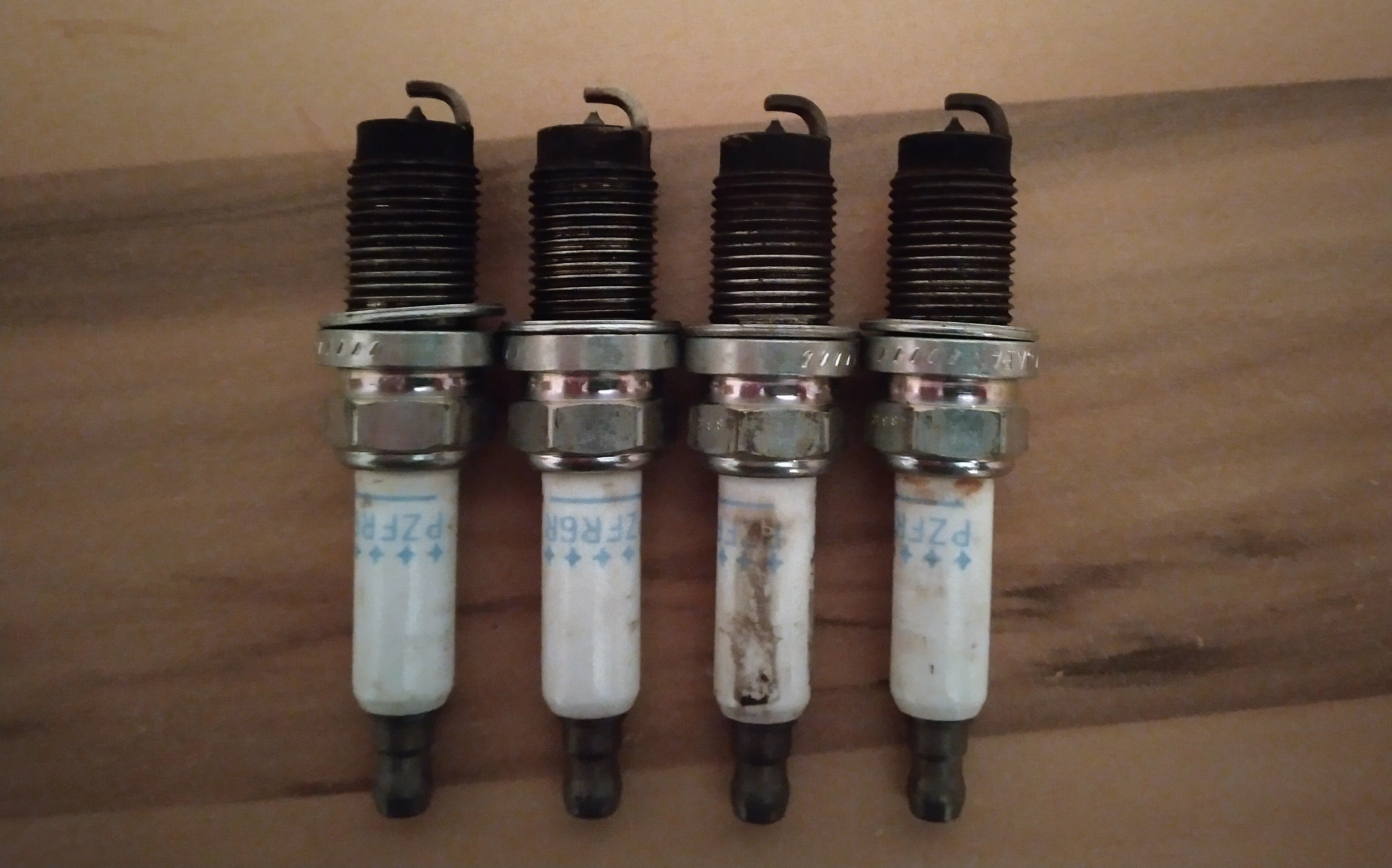

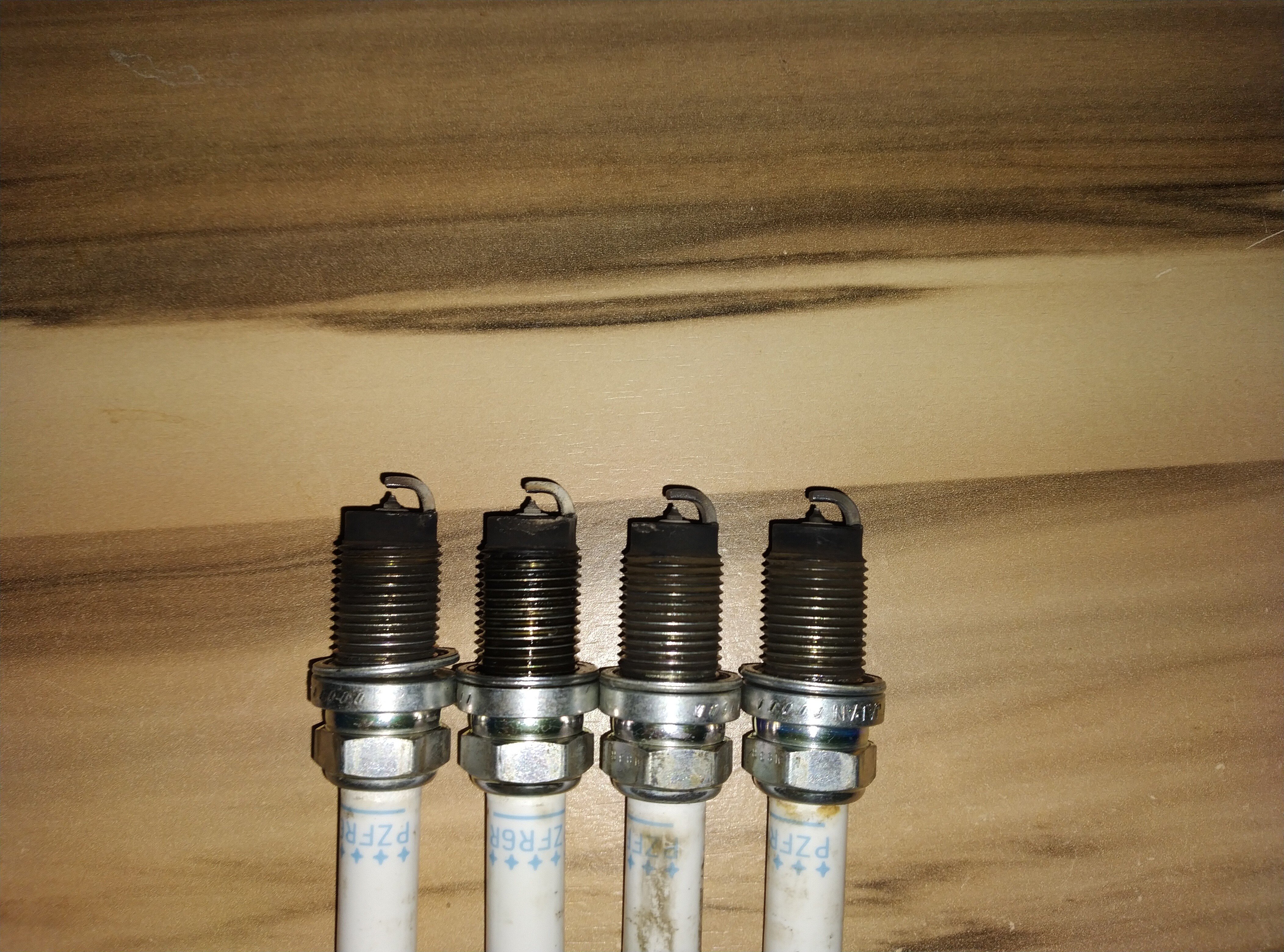

Plugs been in 2 years but less than 10k, garage scanned it with VCDS couldn't find any codes whatsoever or anything wrong at all. Basically they couldn't replicate the 'chugging' vibration at low power / low revs. So all was done was change spark plugs and fit rear wiper motor. Just have to monitor it for now...
