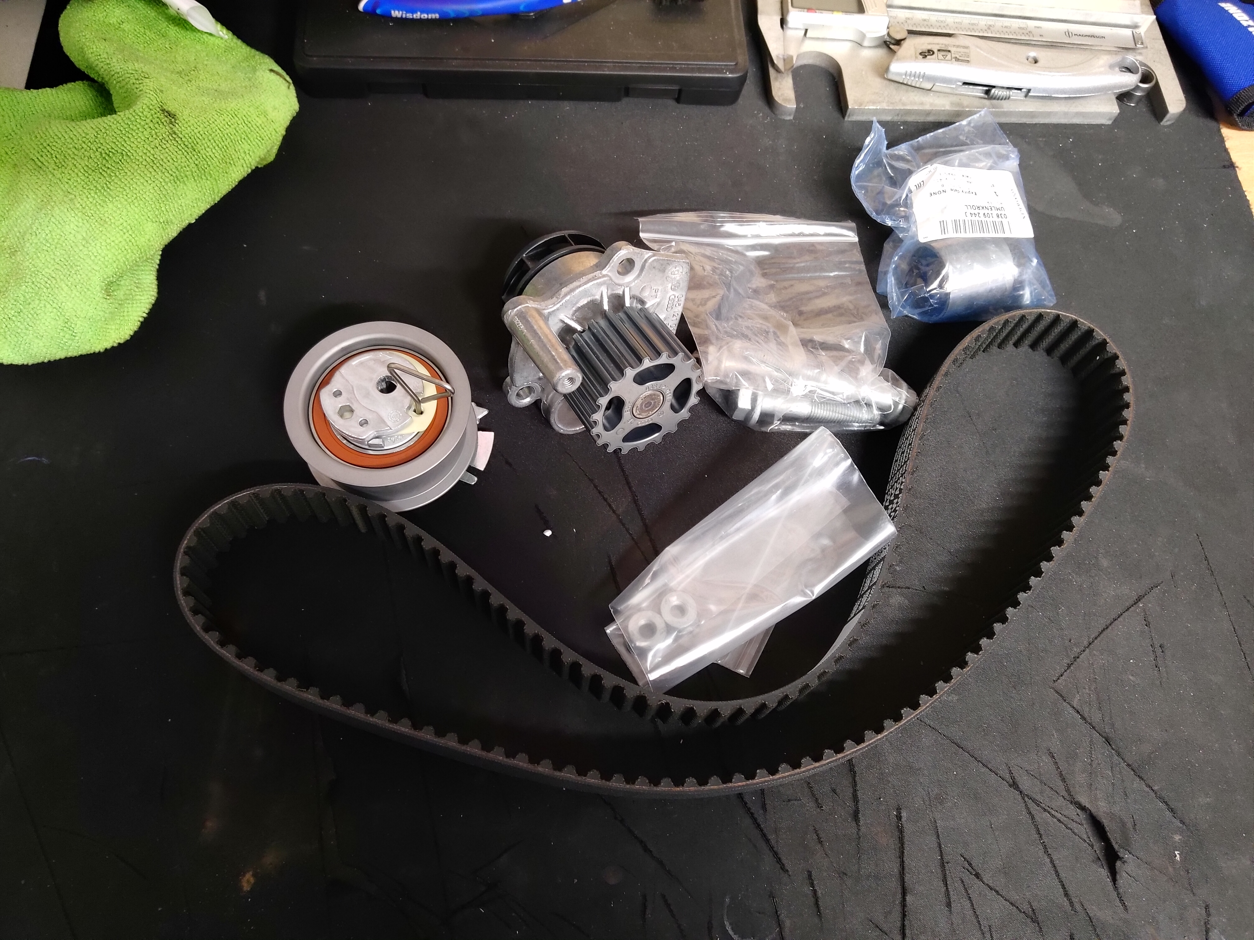

  14. Top dead center is the point when piston 1 is at its highest point, and on the compression stroke. Assuming piston 1 is first in the firing order. Make sure the cam locking pin is FULLY inserted, in the "guide" picture its only half in!. Im pretty sure the water pump has an o-ring please don't cover it in silicon.
