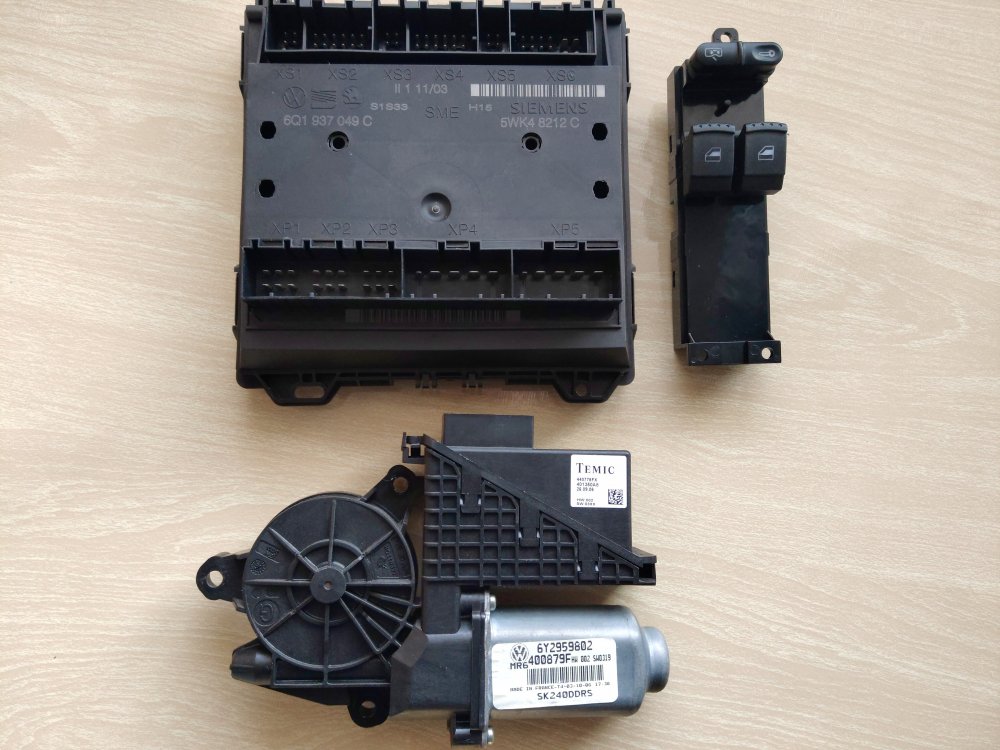

Id be using 2 external 5 pin relays to switch polarity. Im starting with basic stuff first. Id be leaving all the factory connections intact (may bring it to life). Yes making sure the window doesn't go to far is a concern. If i cant get something working id have a look at your idea of setting up a switched power to motor to replicate the battery being disconnected.

Will have a read through when i load up the computer later. Im thinking to bypass this relay for my circuit im designing for version 1. Ill probably mount the new switches in the blanks in the dash. (Motor control board pictured)

Do any of the window systems show up in vagcom ?. Must be some sort of voltage or resistance test that happens after the circuit is first powered, then fails after a few minutes not allowing motors to operate. Just waiting on some more part to arrive before i start on my window circuit. If i get a working system ill share my findings.

Thanks for the info man. Yes making the main power for the motors switchable does sound like a workable solution. Could also have power disconnected/reconnect via a relay, activated by the factory switch. This is my other d/s motor (1 of 2) confirmed working. But will only work for a few minutes when connected to the door loom.

Do you have a wiring diagram for the electric windows circuit ?. Or a schematic of the motor ?. I have 2 motors that work on the bench, but will only operate for a few minutes in the car. May end up making my own loom to bypass the factory circuit.

Welcome to the (my windows dont work) club. Try disconnecting the battery for 1-2 hours. Check battery voltage Check alternator is working Check wiring in door shut Test the motor its self using 12v source Check window switch connector Check motor connectors Check for broken wires/corrosion Hold key in unlock position in drivers door

Battery at 12.6v (engine off). Battery at 14.4v (engine on) Battery at 14.2v (engine on with a/c, lights, heater ect) Windows will work if the battery has been disconnected for a few hours prior. Next step is comfort module. Anyone know if these can just be swapped in an out?, Or are they coded to the ecu/ign/immobiliser ?.

Sealed all 4 doors inside (no water on the sills now). Fitted new drvers side switch, still now luck. Can i just swap in a another comfort module?.
