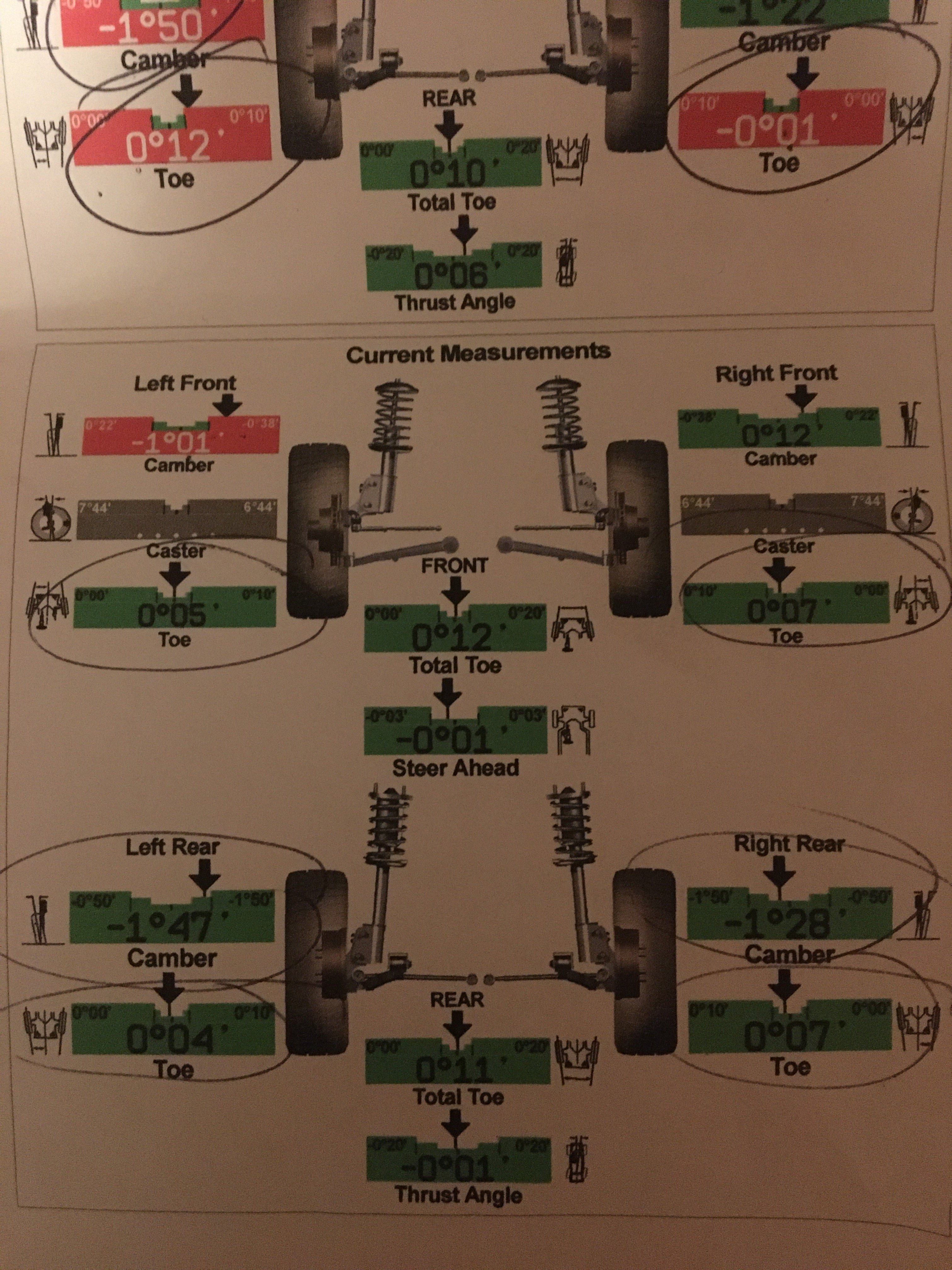

  10. Hi all, Just had the alignment done on our Yeti and Kwikfit have told us the front camber can’t be adjusted - are they mugging us off?
