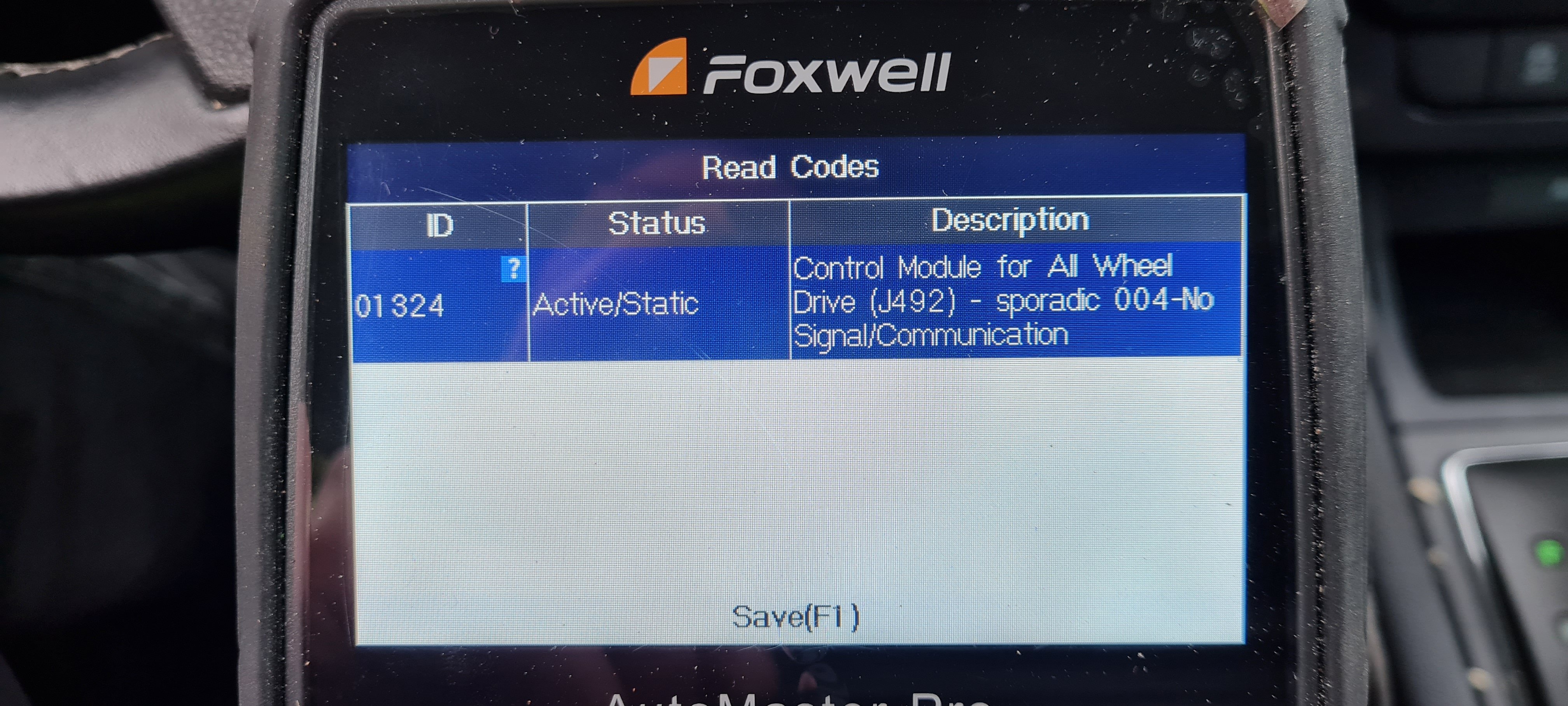

  3. Its become apparent to me that the Haldex clutch pump seems to be faulty. There is some old codes stored in the code reader, one of them stated "C111204" Haldex clutch pump faulty. But there is a massive amount of other codes under CAN Gateway (5) CS and ABS CS (1) and Cent elec.02391, 00924,00834,01259,01331,01332,01333,01334, CS(8). Very confusing😧.
  4. It is read in the 03-ABS Brakes Control system. What specific tool do you have in mind? Cannot afford a professional scanner, payed 600 for the Foxwell..
  5. J.R. you are right. 004- No signal/communication. But hard to know where to start looking. Sensors on each wheel is checked. Is it possible that the sensor itself could be U/S not showing any signs from outside? Also, when I read live data I can see that each sensor giving me input (Km/h) so not very suspicious to them. Any idea? BTW, I use Foxwell NT680 Pro.

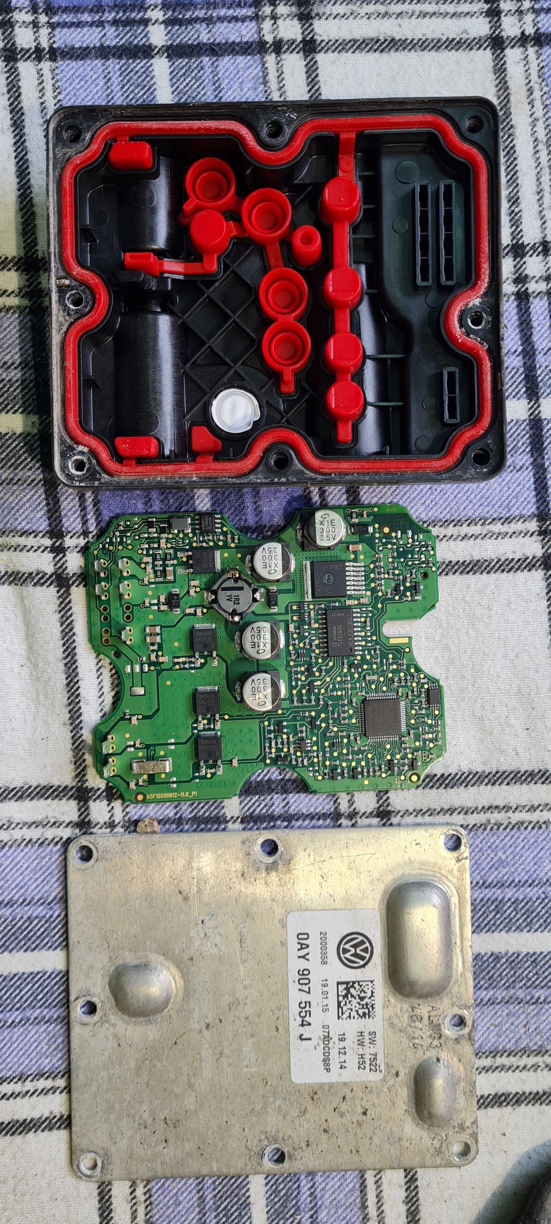

  6. How would I know what generation Haldex is in my Skoda Yeti Adventure 2015? Fault codes 01324, Control module for all wheel drives.. etc is still present. Jacked up the car and removed and opened the control module to see if the circuit board was corroded which is was not. Does anyone believe that the fault code is related to a blocked strainer at the end of the Haldex pump? Kind regards!
