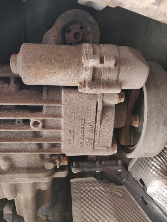

Think I've found it (cylinder in photo), drain plug is at bottom of photo in the middle
Thanks
33 minutes ago, ChrisCh said:
Thanks Bap33. Got any links for a new filter screw and drain plug?
Thanks
Ah yes it’s not really on the front face, sorry! but anyway, that’s it. Just be careful that you get the correct fill and drain holes because the fill and drain holes for the rear differential are close by.
