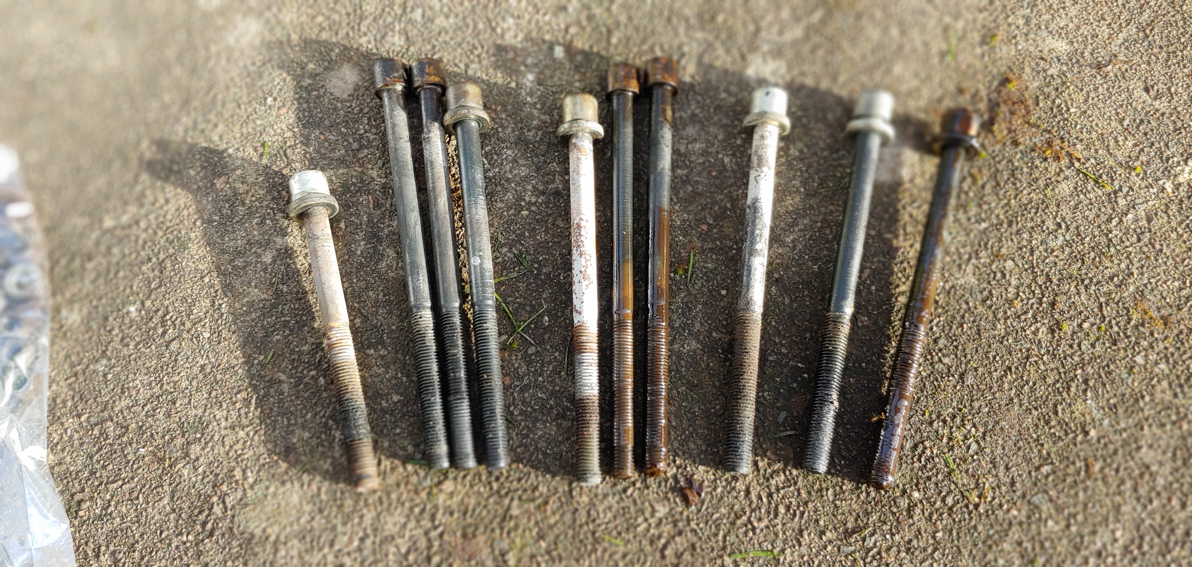

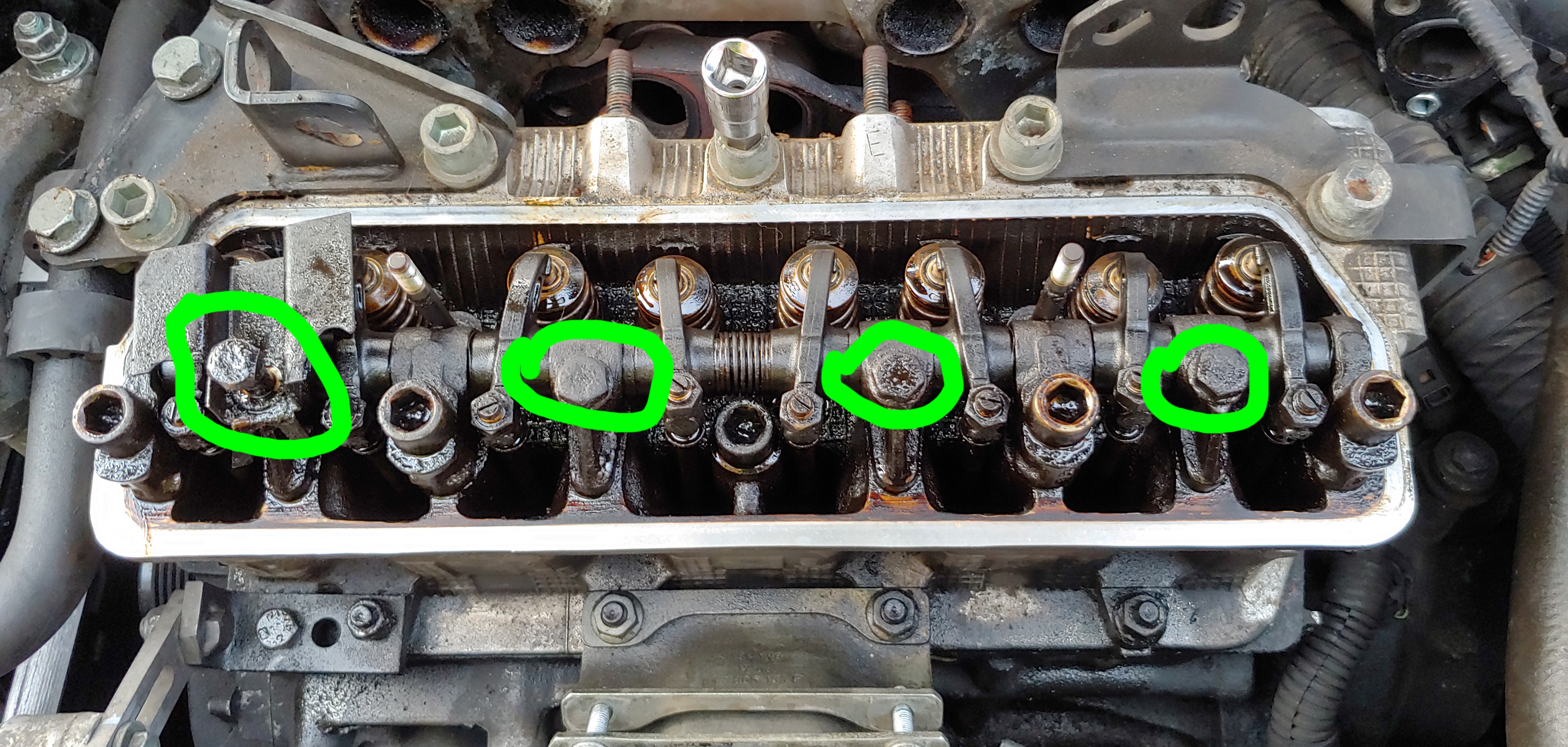

  2. nah I didn't, I used new head bolts, that was an old photo I added the green circles to, I haven't taken new photos s yet I just wanted to explain what I did wrong

  8. Run out of time it got dark.. nightmare I made the mistake of torquing all the head bolts down before putting the 4 rocker arm bolts in by hand , they wouldn't line up! What an absolute mare! Lesson learned, if anyone else does this job put all bolts in by hand first before torquing anything ! UPDATE to explain. (I had torqued all the head bolts then these wouldn't line up! I little bit of hitting them with the hammer nudging them seemed to do the trick, but not my best line of thought! proper annoyed with myself, no way was I going to undo all them head bolts)

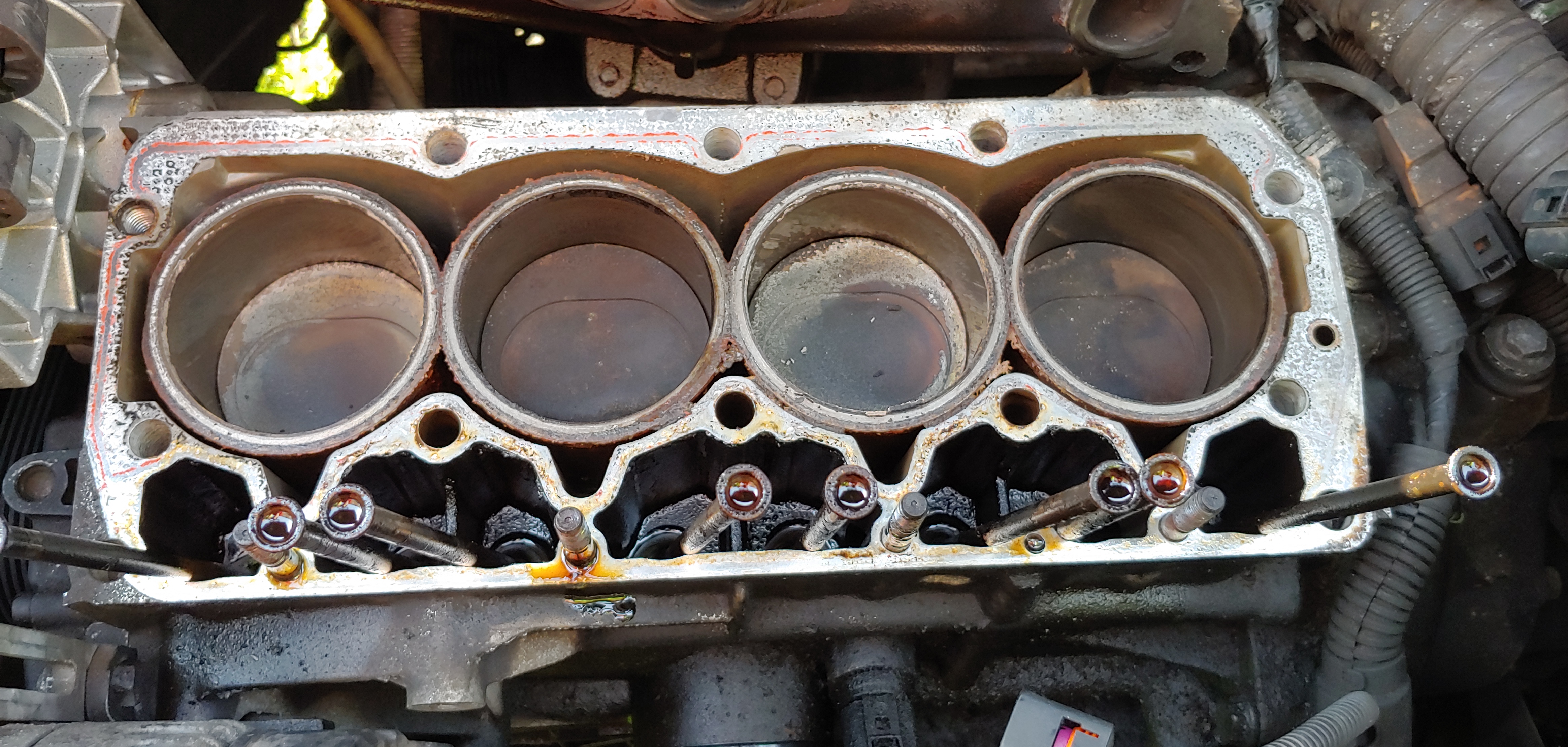

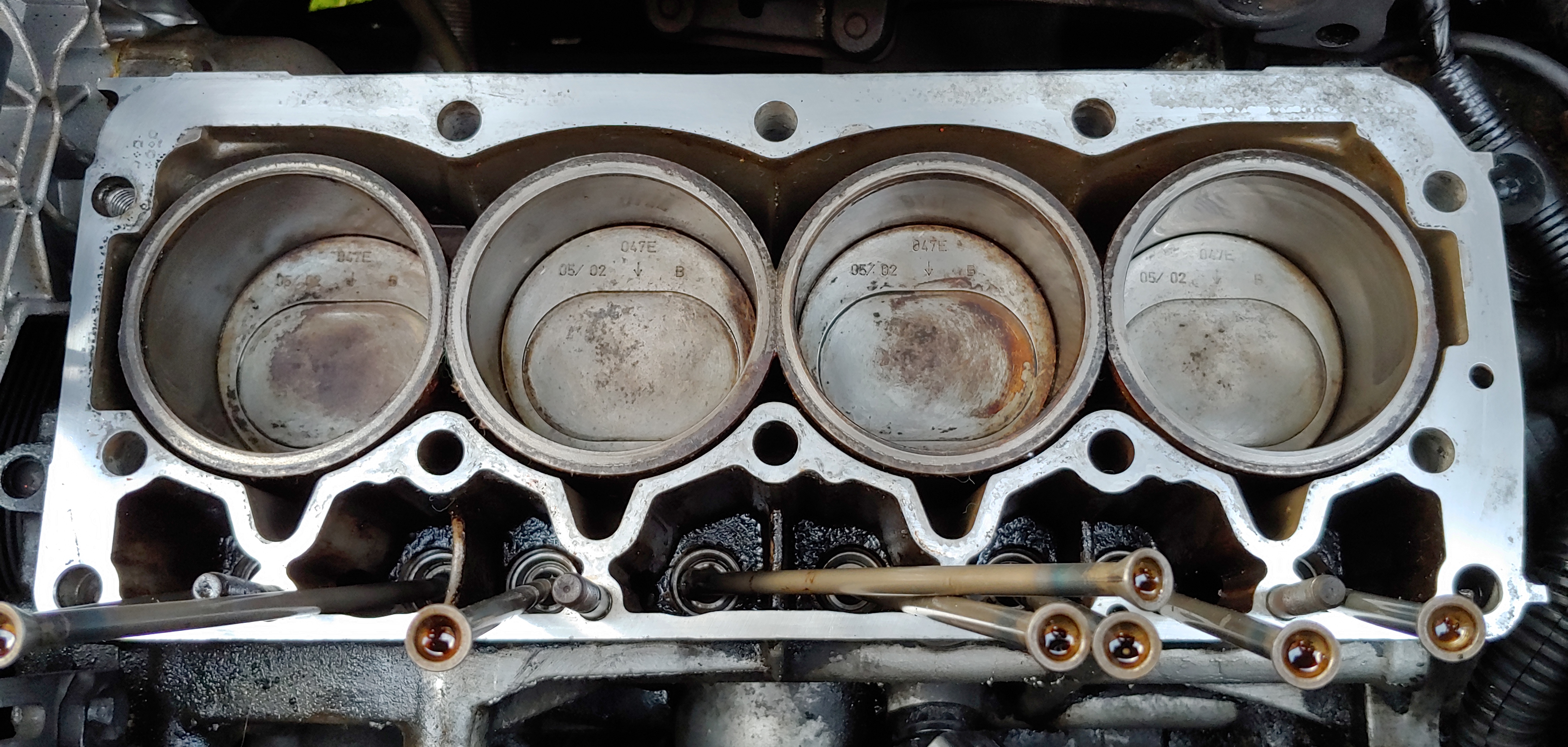

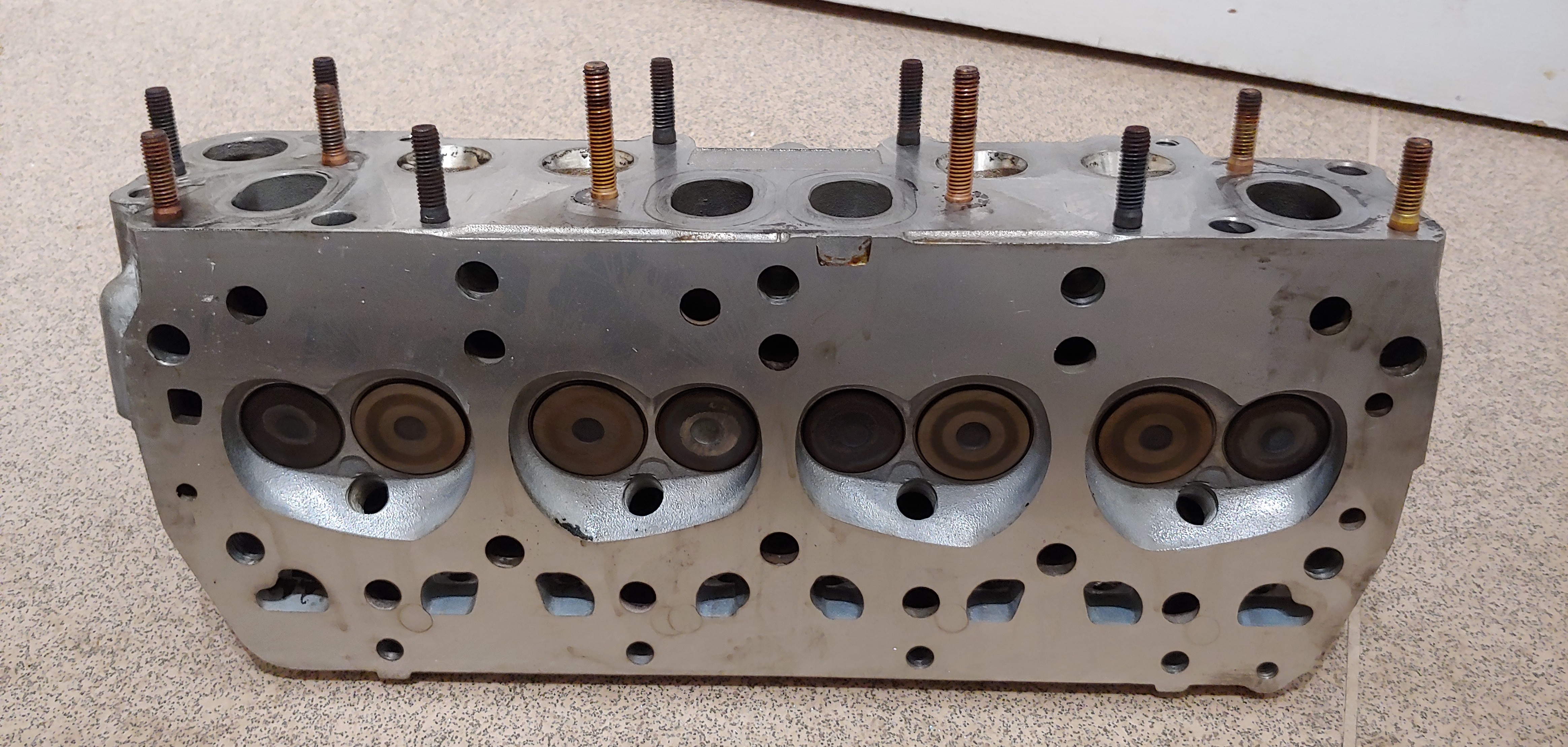

  10. Been cleaning this for 2 hrs.. there was lots of carbon on the pistons very difficult to get off..

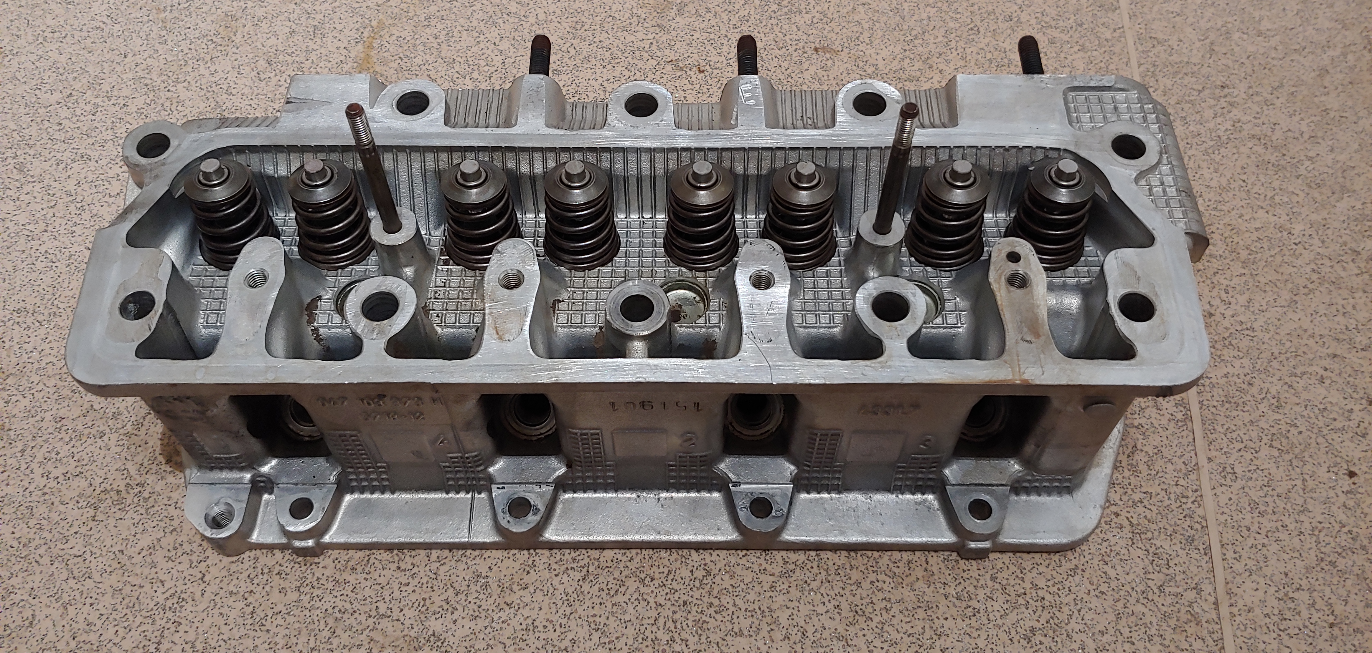

  13. Here are the photos they've done a lovely job highly recommend, very clean. Hehe I did ask them if I could put it all back together as I didn't touch the valve screws taking it off etc, but they was like no, it wont start, you have to do the initial setup again, they also let me take a photo of there book, which I'm sure is the same as what TMB provided, I'll share that image anyway! Gonna start a fresh and put it all back together tomorrow, I've put all the new hydraulic lifters in, the old ones was quite difficult to get out, kept falling off the magnet, but I managed it. Just need to give the cylinder block a good clean.

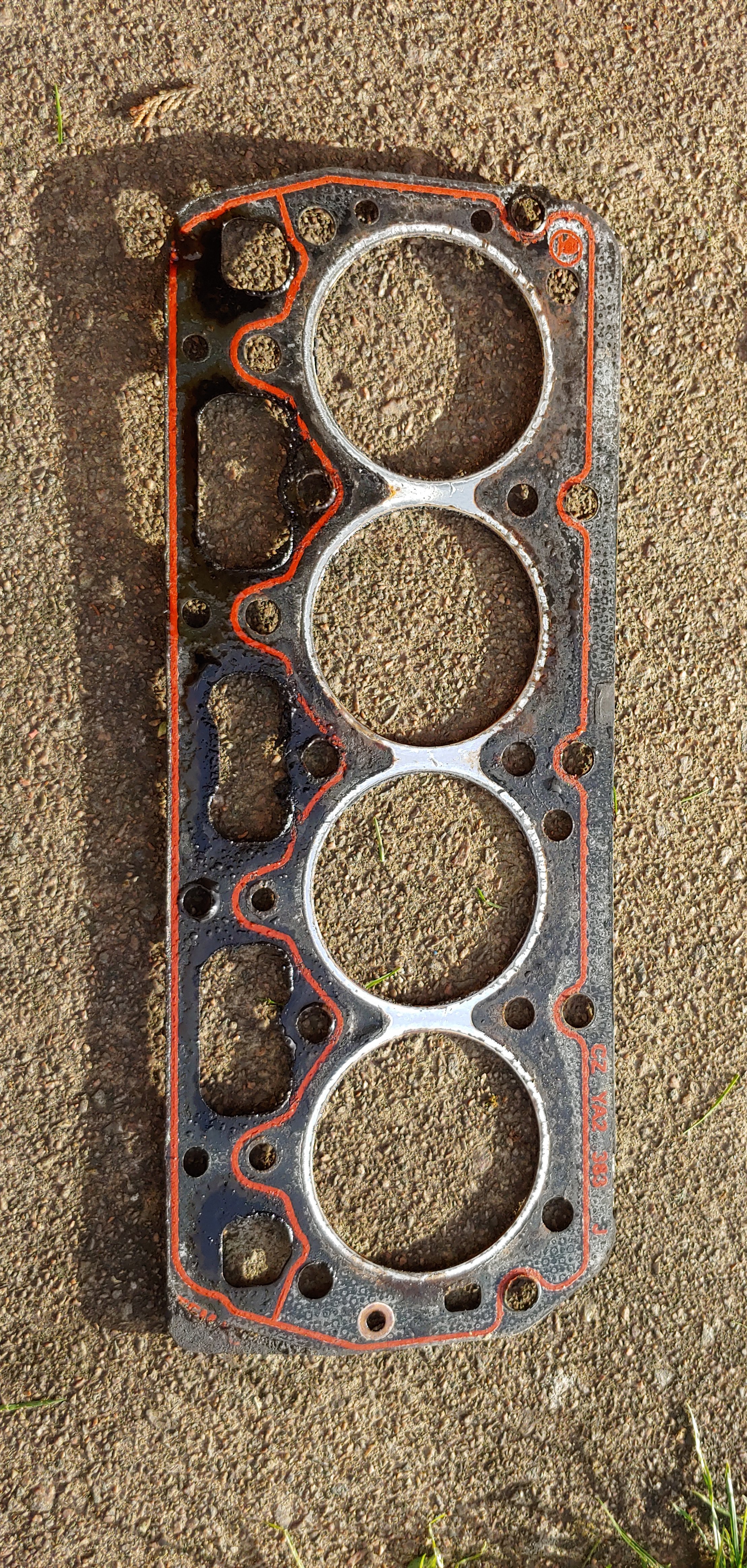

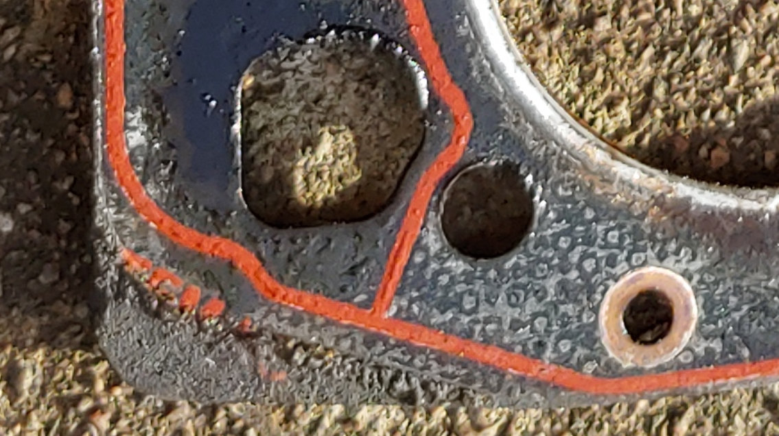

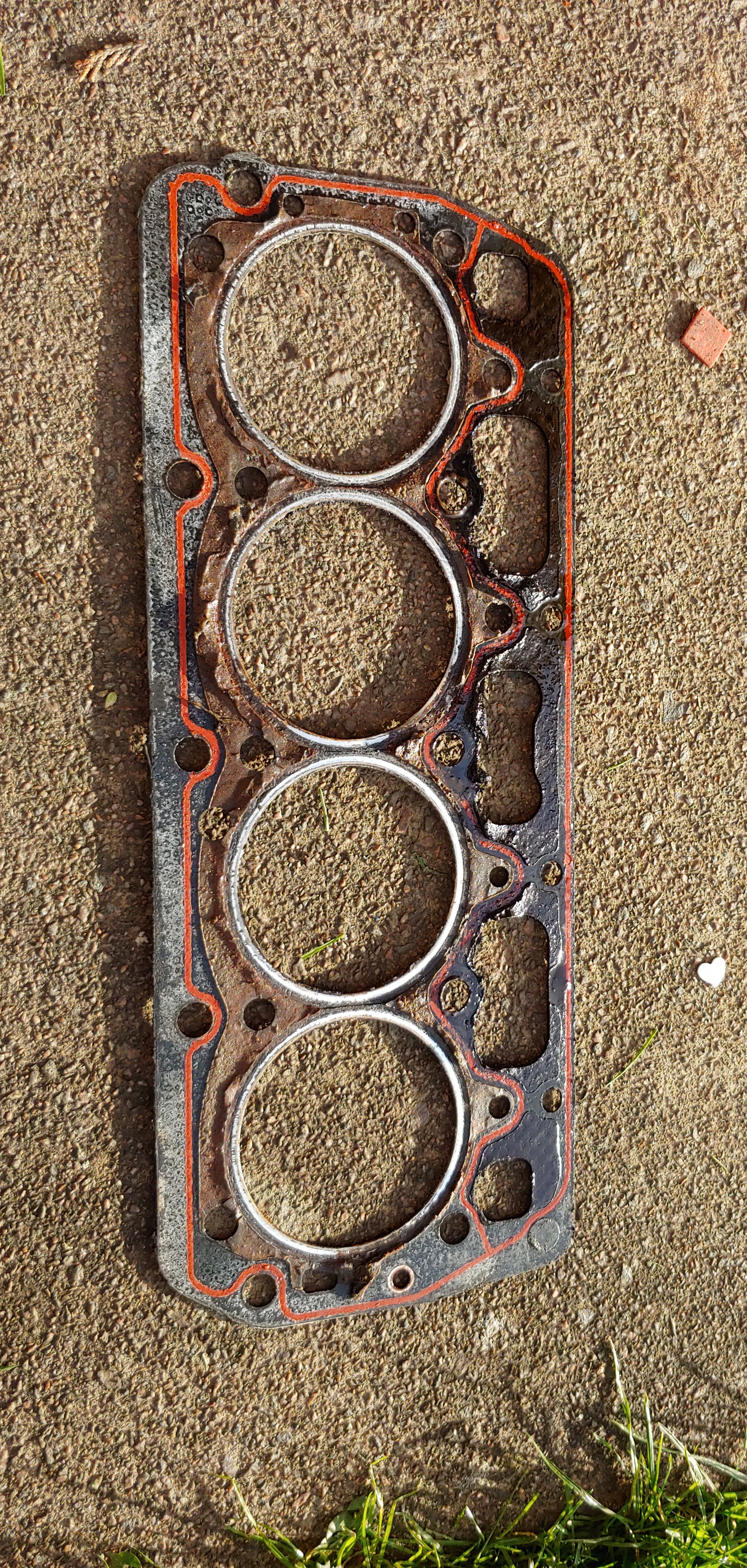

  16. The corner looks a bit worn away so it's difficult to tell, but I don't think it is.. UPDATE: On closer inspection.. (magnifying the image) It looks a lot like I can see the lettering TEM .... ? Although I could be wrong lol!

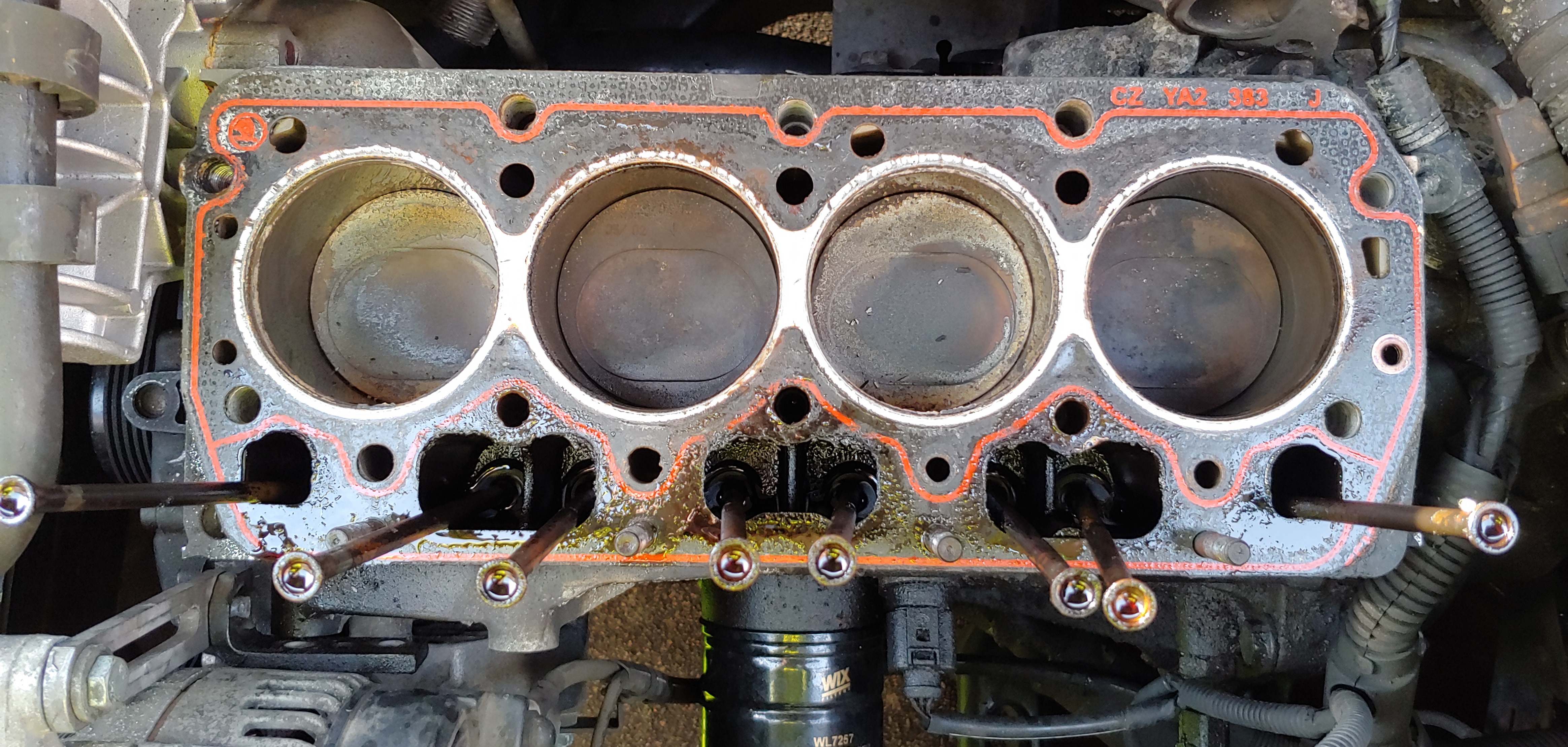

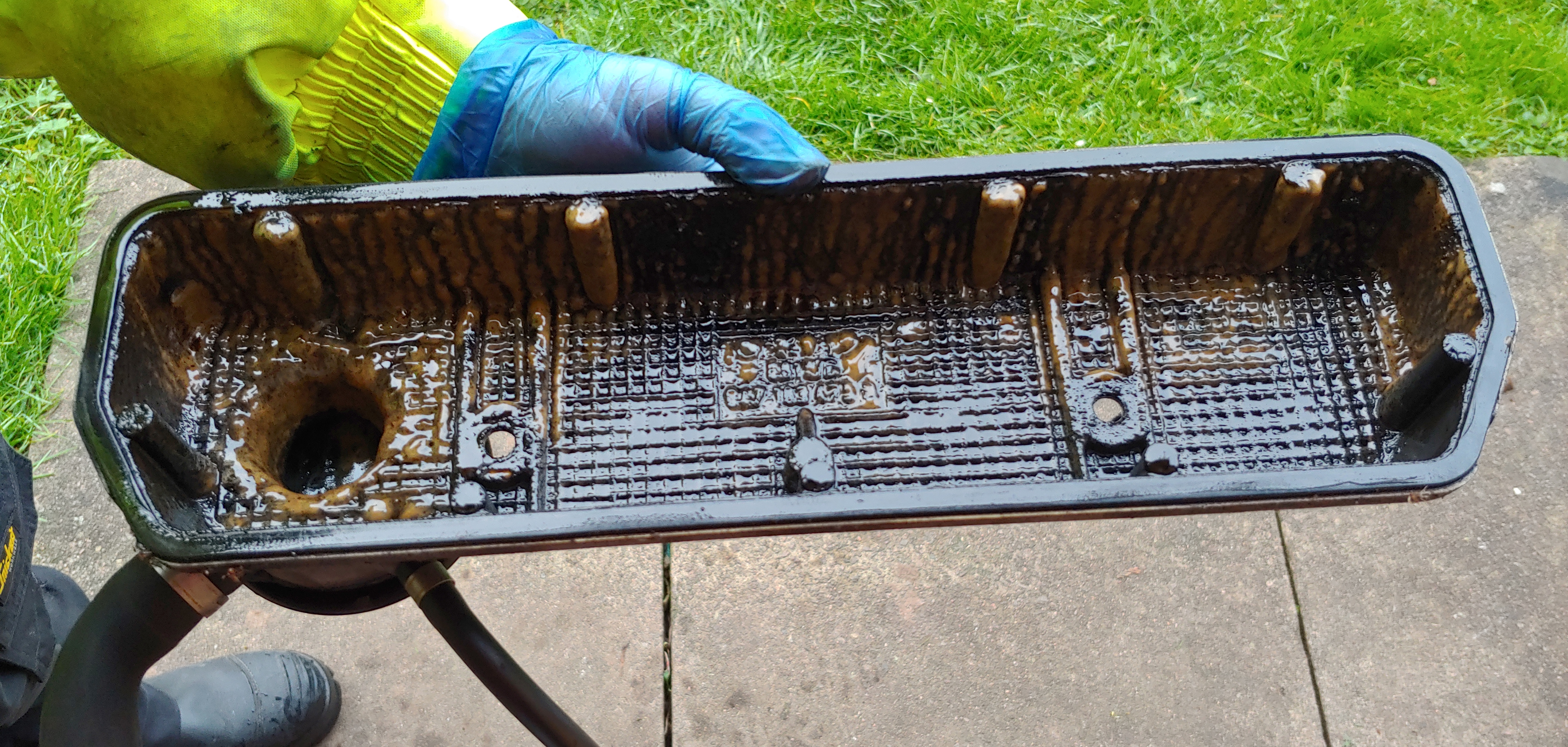

  19. Yes dude, it definitely looks like it's de laminating, like wet cardboard puffed up and peeling.. very strange. Like yellow looking, the new gasket doesn't have this colour. There's all mayonnaise in the rocker cover so I presume oil in the water yes

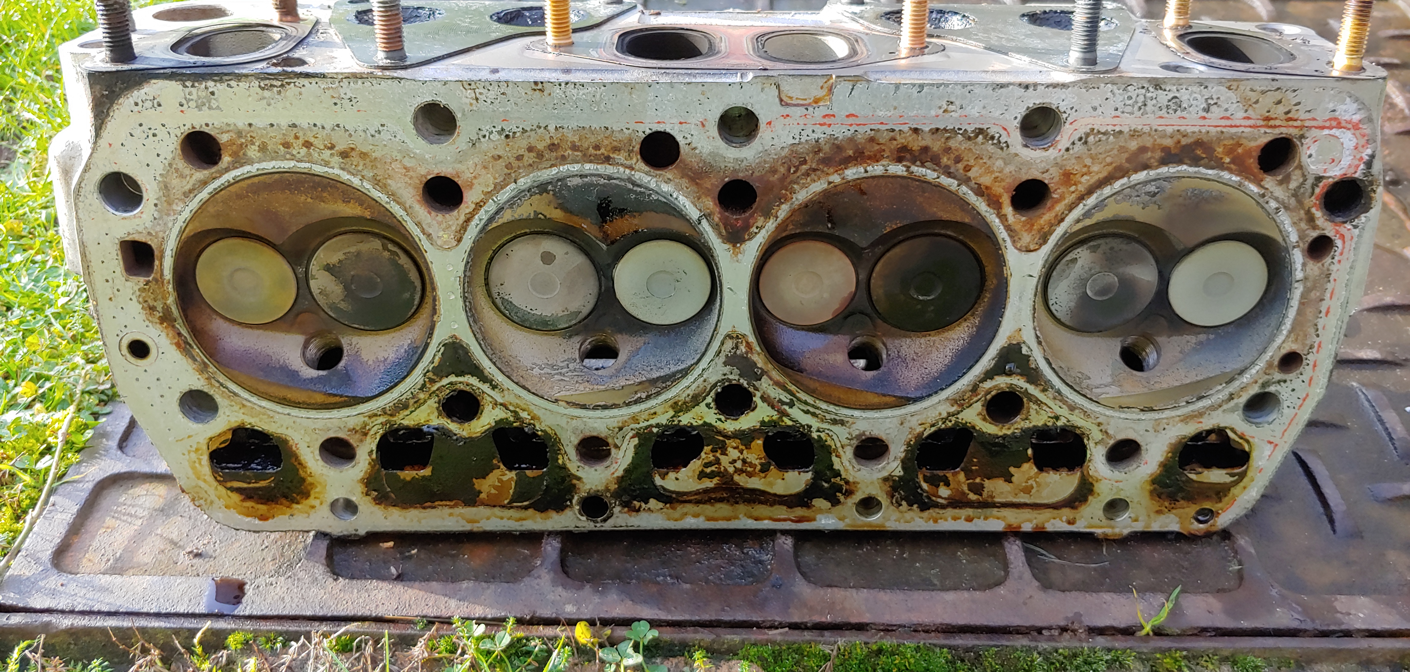

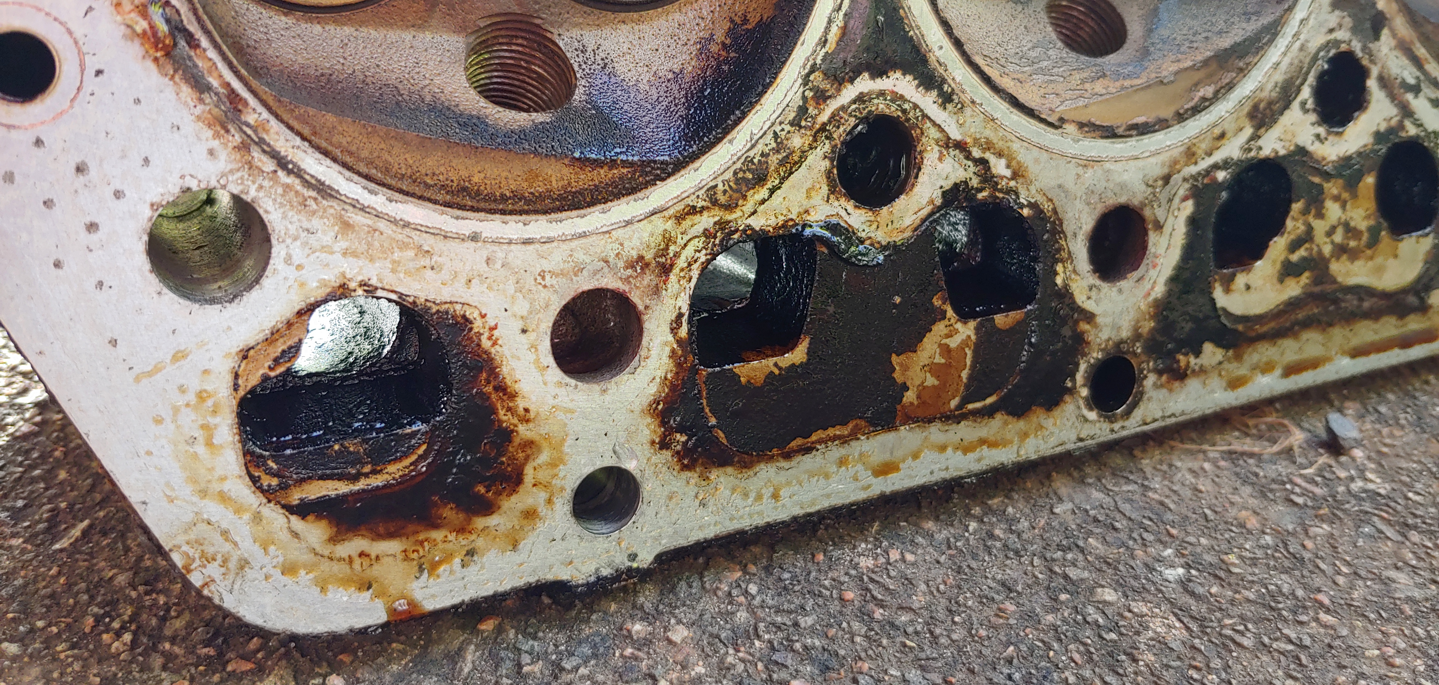

  20. So, it's off and at Bromsgrove engine services. Here's the carnage! There was sludge on 2 of the Head Bolts What you all reckon?
