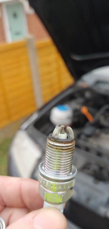

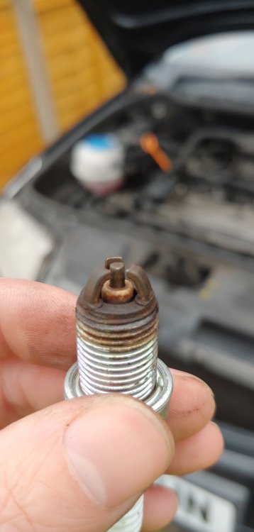

  21. also, its not a teemac gasket, I've looked in the corner and can't see that
