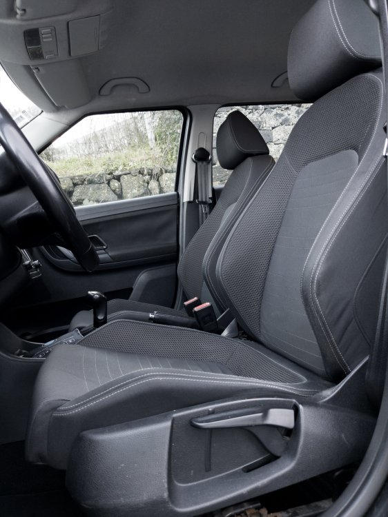

  10. Yes, there are plenty of threads already about it, a quick search on this forum and you will find a few. If not mistaken, the following are a direct replacement for the front seats: Fabia mk1 and mk2 ibiza 6l and 6j polo 9n and 6r audi a1 I just changed the front seats last week, and having done a few mods to the car already, they were one of the best, if not the best mod so far.
  11. I've got my hands on a set of scirocco seats, both front and rear, having fit the front ones I was wondering if anyone knew if its possible to fit the rear 2 person seats on a fabia, I know they just don't bolt on, but maybe someone has done and could give me some advice

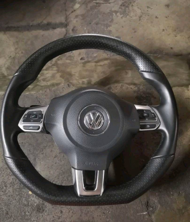

  12. I'm okay with the paddles, could also look for a octavia vrs steering wheel, it's the same but some don't have paddles
  13. I have the one exactly like the picture, I would of been more than pleased with just the left side buttons from the scirocco wheel but my main consern was the airbag
  14. Thanks for the answers guys, definitely won't try the swap then, will keep an eye on a vrs one
  15. Hi guys, I found this scirocco wheel for sale and wanted to know if its a straight swap?, both pictures are from the steering wheels in question

  20. I wasn't sure if the last MK2 could come with EA211 but yes I don't think so.
