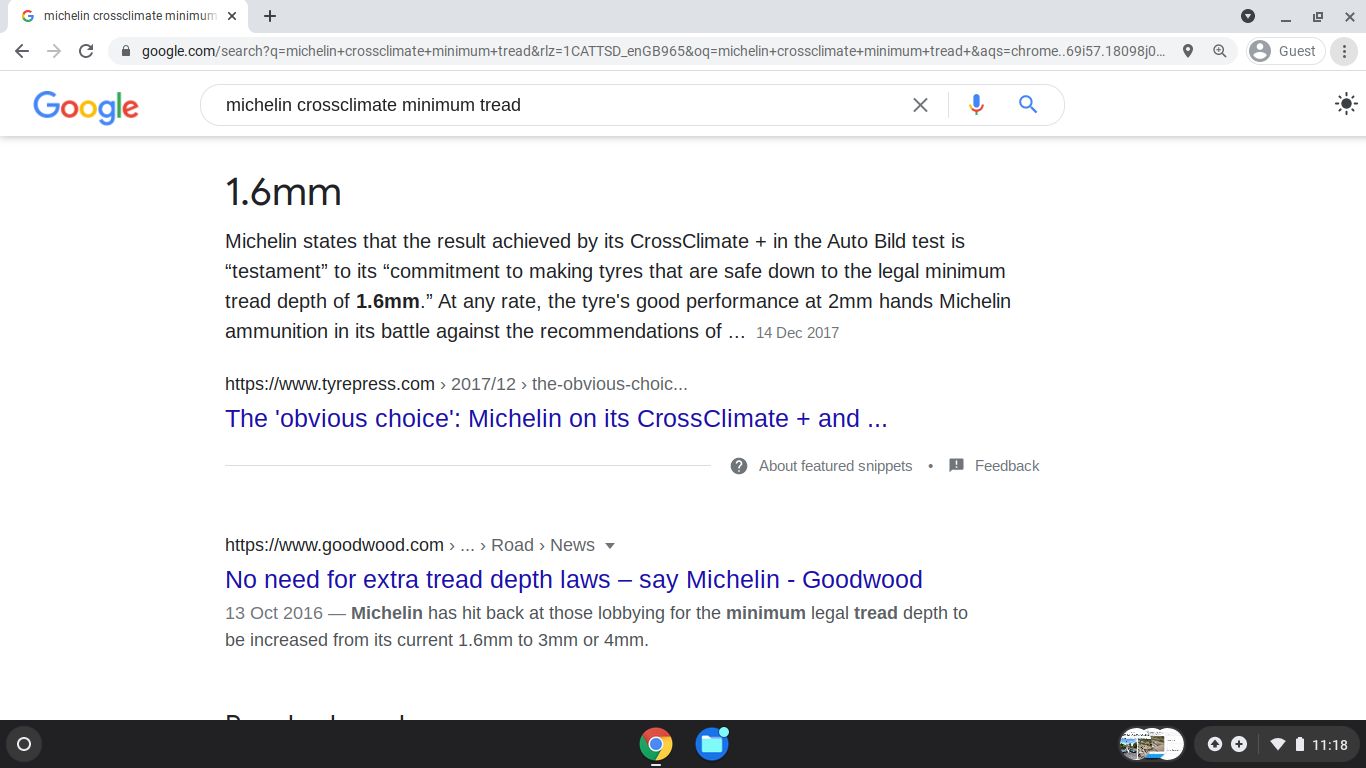

Below,  CrossClimate +. Not CrossClimate.
