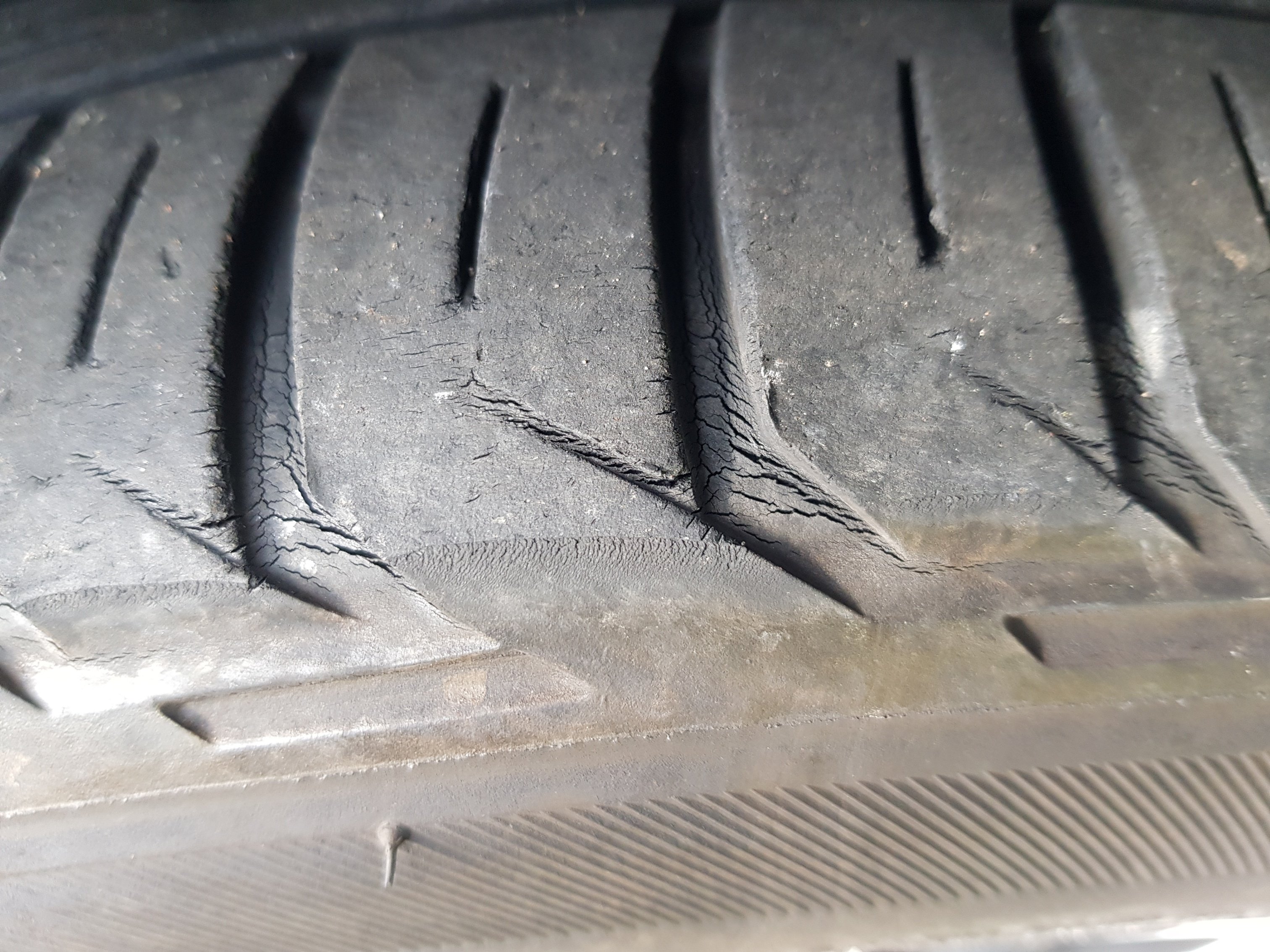

I was going to say cracks off the sidewall are fine. But that really is a bit of a canyon on yours.
Personally, I'd replace.

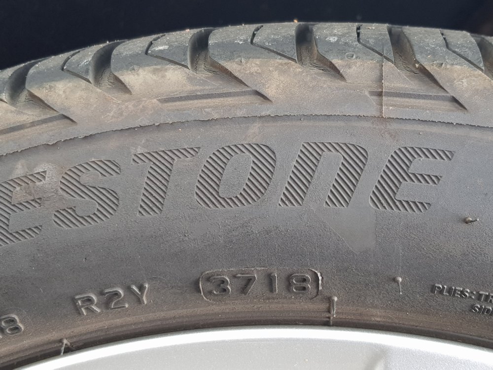

These are mine.
Edited by EnterName

Buy good tyres and check the date of manufacture. (In my post above it's week 37 of 2018.)
