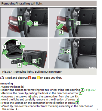

I'm sure this must have been covered somewhere on here but I can't find anything. I have a water leak into the spare wheel well and suspect the offside tail light. Looked up the owners manual which says that I only need to remove the 2 torx bolts (it says screws!) and then pull the light out towards the rear of the car. I've tried this but it won't budge. Back of the light is free where the bolts were but something seems to be holding the cluster at the front. I'm reluctant to use any force as these things are expensive to replace. Can anybody tell what I'm doing wrong. I've copied the relevant bit from my manual below. Thanks
