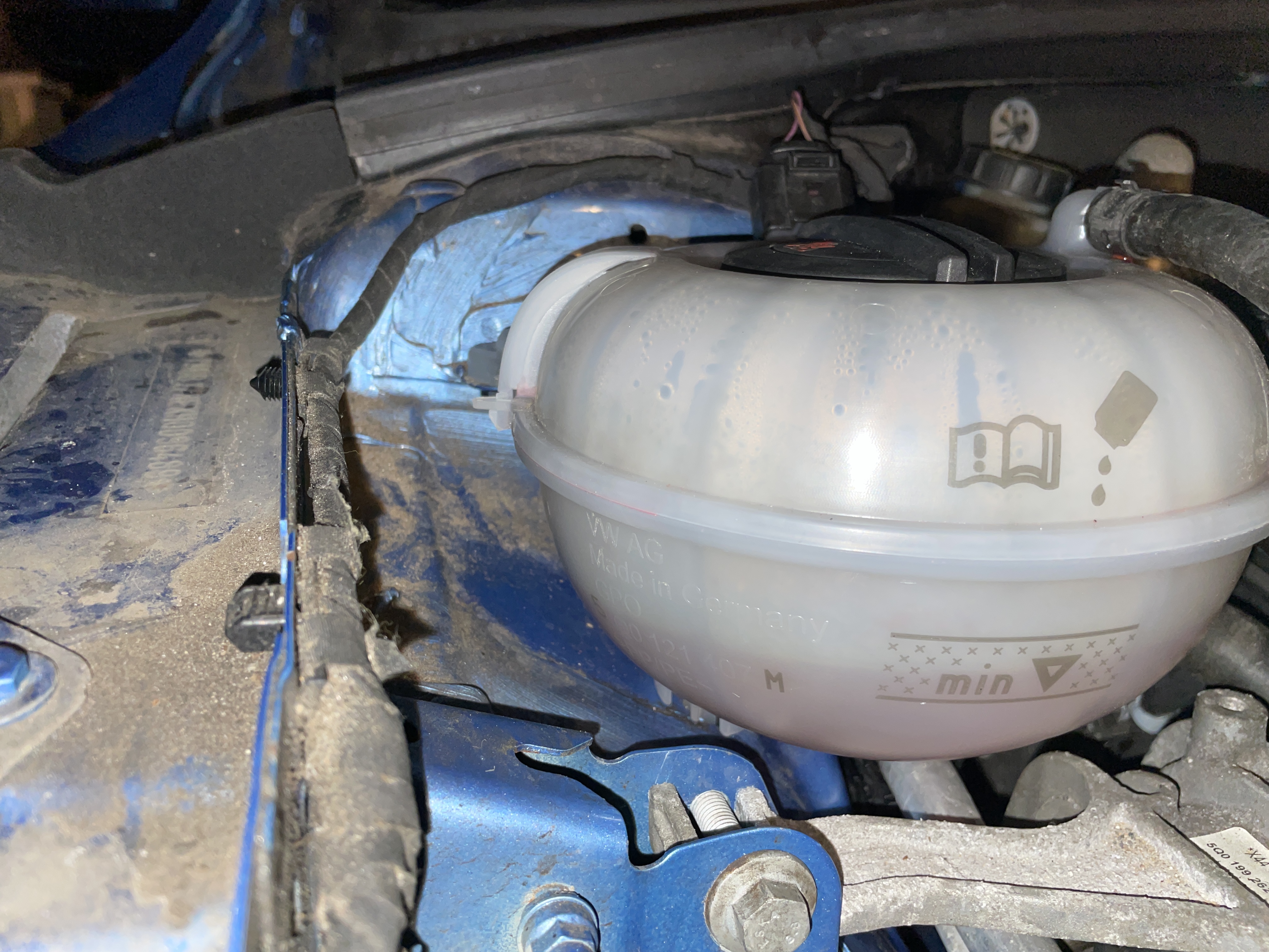

  1. Thanks for the quick response Warrior. I’ve got an ongoing problem with the coolant warning being triggered (from cold start) but the level is above minimum and it doesn’t seem to be losing coolant. I’ve noticed that once the warning goes off a temperature sign appears but it goes off intermittently. This coolant tank was only fitted two weeks ago when the heater core was replaced. I’ve tried cleaning the prongs this morning and will see if it makes a difference otherwise it’s back in the garage.
  2. How do these coolant level sensors work? Do they pass current between the two prongs but in the absence of any coolant the warning is triggered? If there is sufficient coolant the circuit completes?

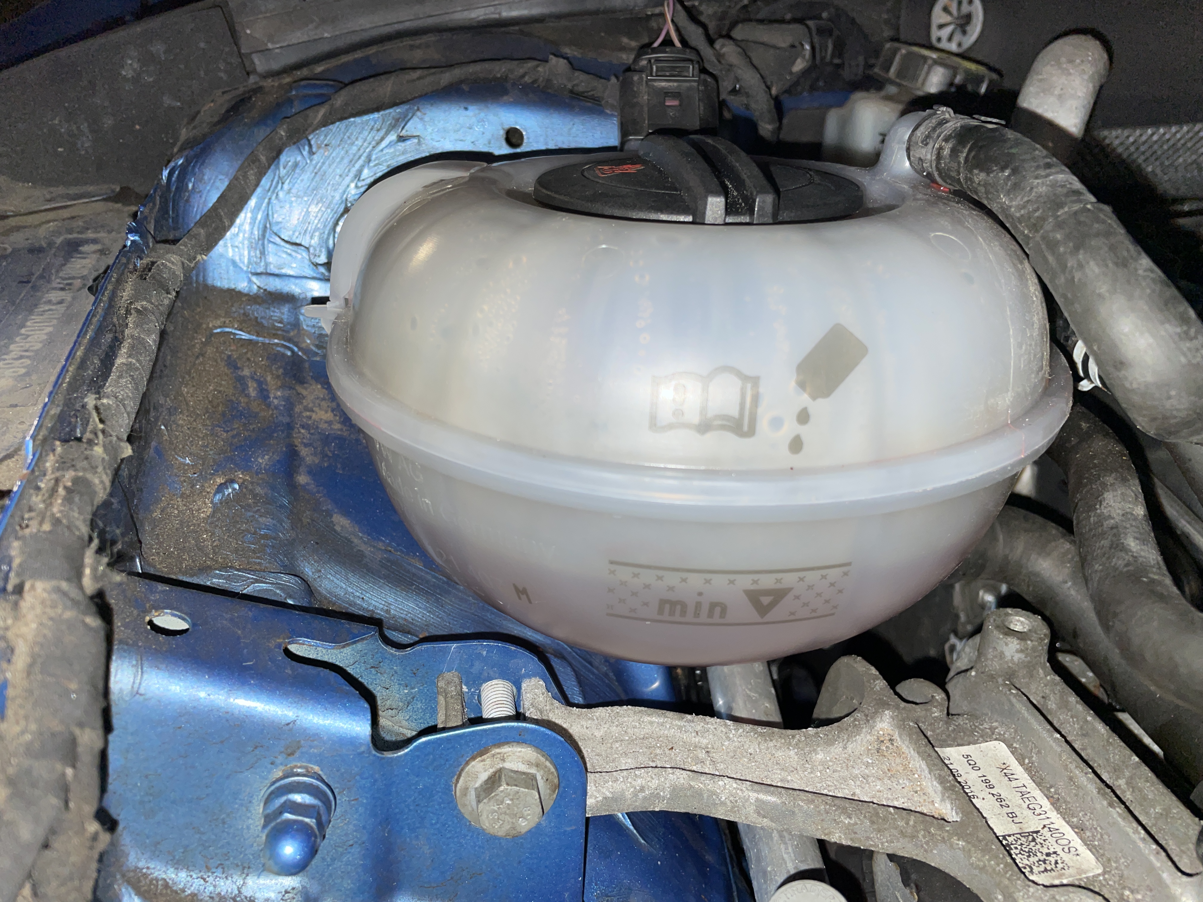

  3. Thanks for the response. I’m not convinced I’m losing coolant - I’ve been checking the level every day. The picture below shows the level in the tank tonight. I turned on the ignition at lunchtime and no warning message came on - got in the car tonight and the message comes up. I removed the cap off the tank and put it back (without adding coolant) and message is gone. I drove for 20 minutes and no warning. Doesn’t make sense to me.
  4. After topping up on Sunday I went for a drive last night and when I inspected the coolant level tonight it appeared ok However I turned on the ignition and I get a low coolant warning. Doesn’t seem right. I topped up a very small amount of coolant mixture and the warning disappears. Is it possible that the sensors are faulty?
  5. Thanks for the response I’ve been topping the coolant up with a ready made G12 solution which is what the garage filled the system with. I guess the question is how many times do you keep topping the coolant up before you come to the conclusion that the issue isn’t air pockets but a leak. I will make some checks - the carpet would be an obvious one if there is a leak connecting to the heat matrix. I believe the hose connections to the matrix are on the engine side. The rad hoses shouldn’t have been touched but could have been disturbed during the work. If it’s something easy to fix it would save a lot of hassle.
  6. Finally took the car into the garage last week to have this work done. Garage flushed the system and replaced the heating core and header tank (with no silicat bag). I noticed a massive difference in the heater from the moment I collected the car. Went for a long business trip (well 250 miles) and on the return trip a warning for low coolant appeared. I topped it up at the next services (this was Friday evening). I then did another hour’s motorway driving. Drove the car locally on the Saturday and Sunday morning started the car and the same warning again. In both cases the car needed topping up by about a quarter of a pint. Is this normal or should I contact the garage to check for leaks? Heating is now working fine but this is annoying. Any advice would be greatly appreciated
