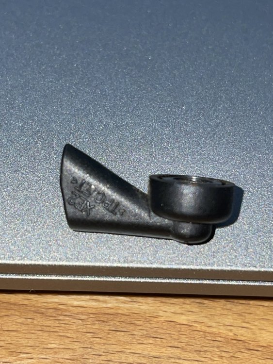

Hi, Does the nozzle look like the picture below? on the hatchback the pipe enters the wiper motor on the inside of the car and comes out of the plastic nozzle below through two metal holes

I ended up going to Johnson’s Skoda where they sold the nozzle for £7.25 so I bought a couple. The new one went on a lot tighter but the performance was a massive improvement - the increase in pressure meant that the water came out as a mist/spray. The spares bloke tried to convince me it was inferior screen wash causing the clogging up and tried to sell me 1 litre of Volkswagen concentrated screen wash for £10.

I have exactly the same issue - one nozzle has cleared and one is still blocked despite soaking overnight in white vinegar and using a needle to unblock. I’m now looking at sourcing a replacement. My part number is identical. So far I’ve only found ŠKODA Direct at £16. I don’t mind paying that but it’s nearly £7 postage for something that weighs less than a Christmas card. I’ve found cheaper on e-bay but (although the part number is correct) the seller only mentions Octavia Mk 2.

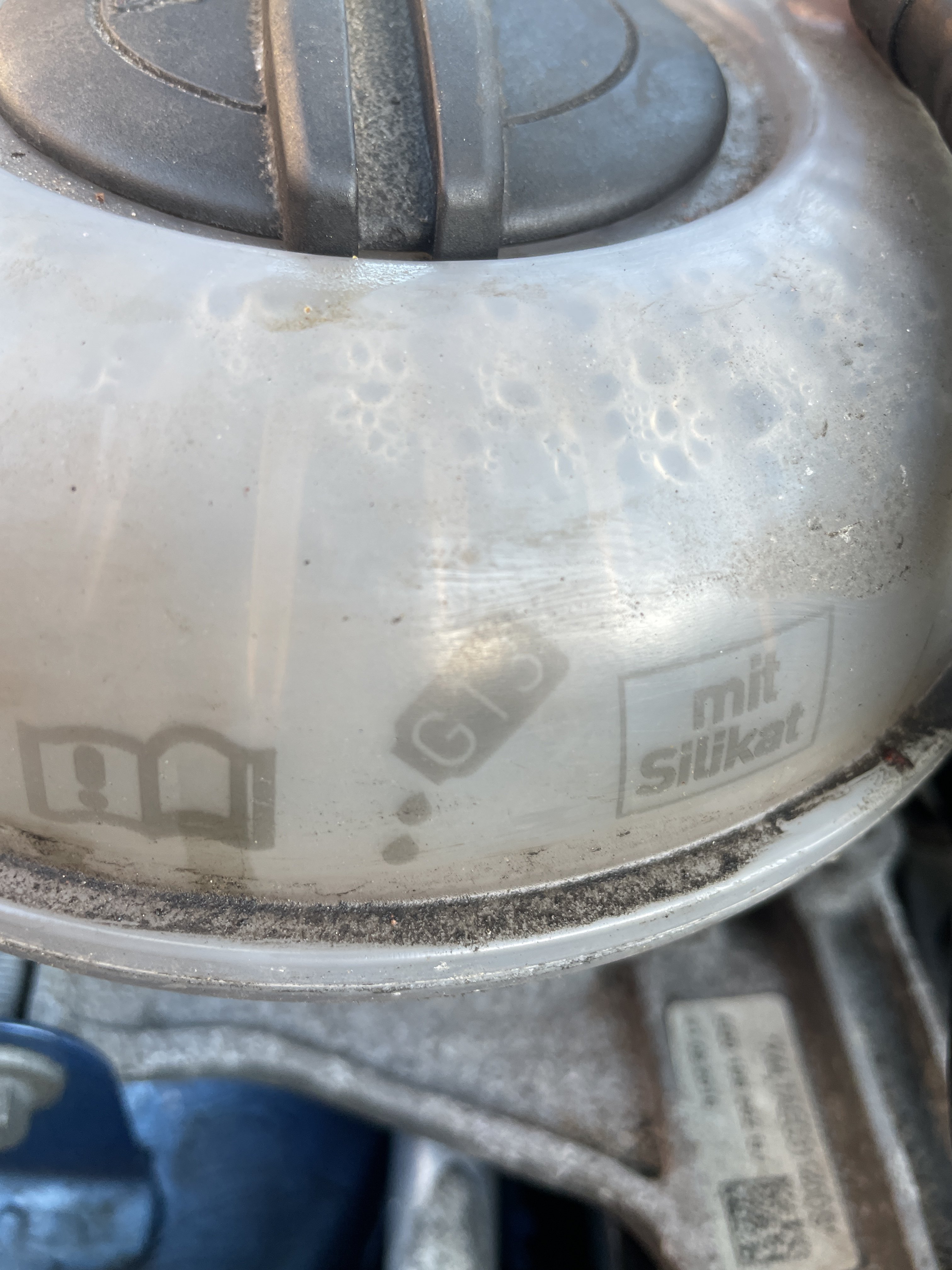

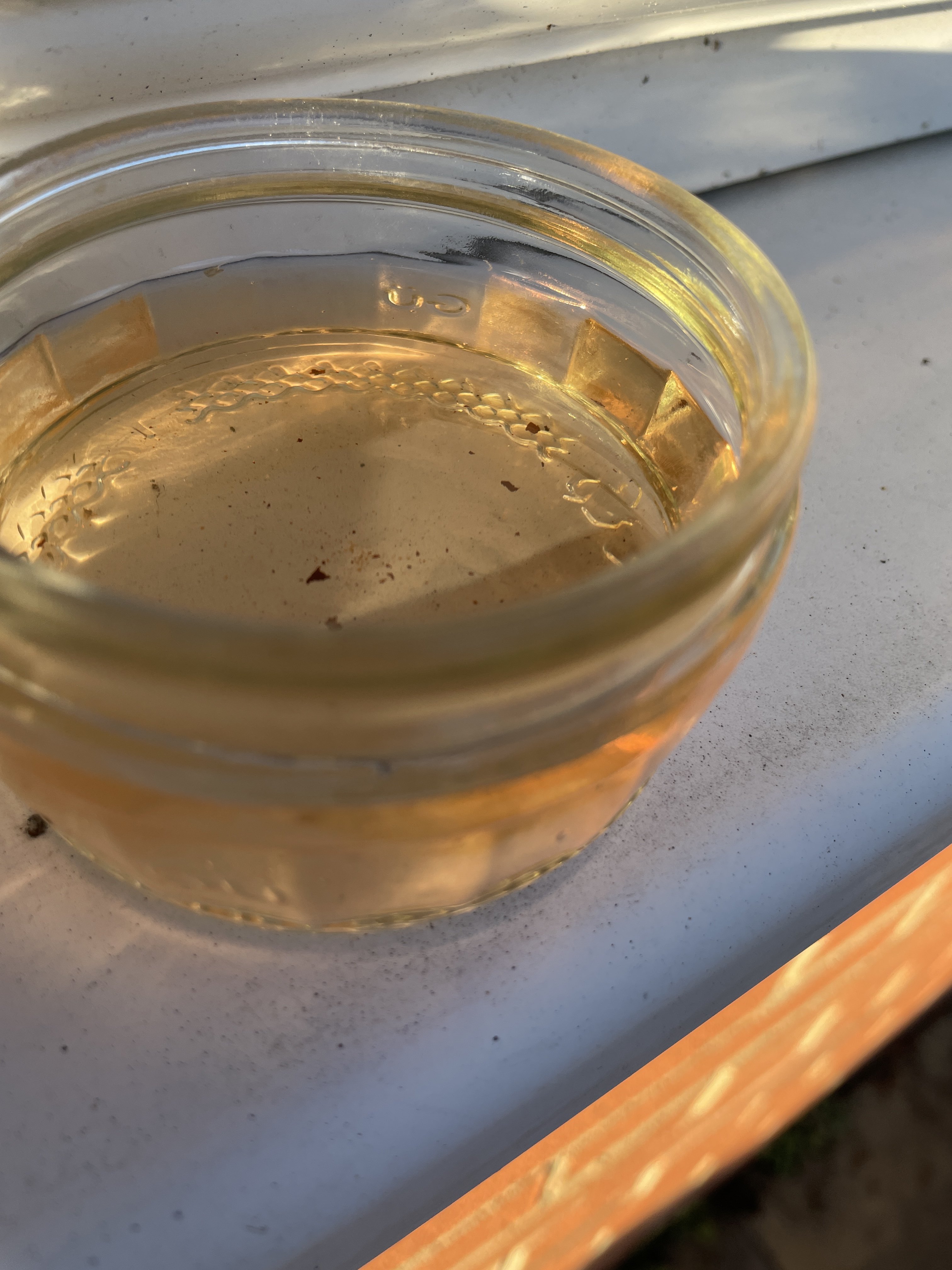

Thanks Ted, I had noticed those particles and it could be rust. The car is going into the garage on the 18th and I’ve sent these photos with information about the silica bag issue - I’m sure he’s aware of this already if he deals with German cars. i hope it’s something straight forward- if it comes to a grand and a half I’m tempted to sell the car. I’ve got a few other issues: boot won’t open with central locking, washers packed up, position p error on gears and it’s only done 41000 miles i hope your replacement goes smoothly- there’s a few You Tube videos showing you what to do but I’m **** at even the simplest car maintenance jobs. How did you know that your original tank had a bag in the first place - did you see the beads in the coolant?

Hi, For a few months I have not been getting hit air only on the drivers side of my Octavia. After a service I was told that my coolant was contaminated- I’ve attached a picture of a sample from the header tank and it looks ok to me. I have the double wall coolant tank (see photo )but I can’t see any sign on the bag of silica ? Nor could I see any silica beads in the water sample? I’ve booked the car into a local garage who specialises in German cars but I’ve read some horror stories about repair bills of a thousand pounds (to flush the system and replace the heat matrix ). If this is the case I’m tempted to sell and replace the car - I already have two pending repairs which I can’t afford. Has anyone got any experience of similar heating problems?

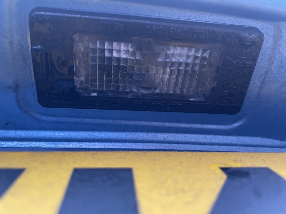

Problem unlocking boot lid - Skoda Octavia 66 plate
Many thanks for the responses on this.I’ve taken photo of the boot handle. Hopefully this has uploaded ok. Could you please confirm this is the part you’re referring to? Also if this handle is at fault why is the boot unlocking using the middle button on the key fob?
All 4 doors are unlocking with a single press
Only today I noticed my boot lid was not unlocking when the main button was pressed on the key fob (the button that unlocks the whole car). If I use the button in the key fob for unlocking the boot it works fine. I thought it might be a problem with the battery in the key fob but there are no indications of this. This boot is one you open manually. Has anyone had a similar problem and if so how did they resolve it? I would be grateful for any suggestions or comments
